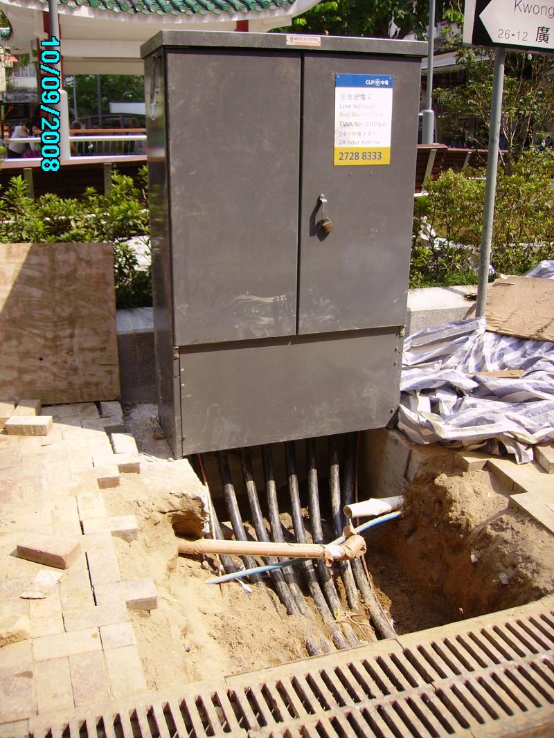

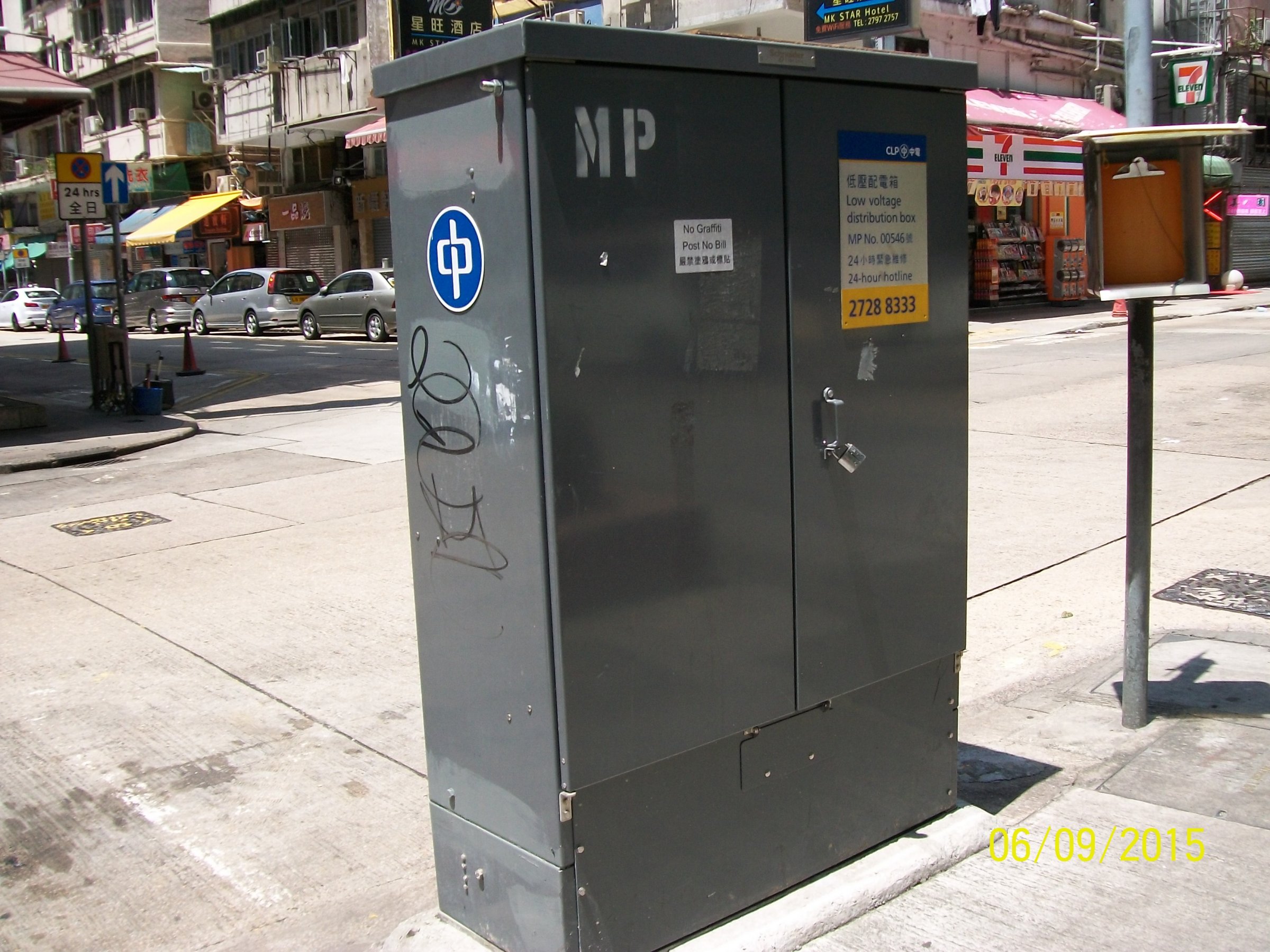

The UK should adopt the system they use in China nowadays, whereby the street mains are terminated in a Distribution Cabinet, containing banks of 100amp service fuses in three rows, one per phase. From this cabinet run the customer service cables, which are of course fused at 100 amps, not the 800 amps we have in the UK, that run to each house in the street, into a dedicated meter box containing a Power Comany Isolator switch - then the Meter - and a Customer Isolator switch, and finally the Consumer Unit, probably a traditional Wylex Standard, but likely to be a din rail box variety in the newest houses.
A much safer system perhaps - the whole service cable being fused at 100 amps.
nowadays they do it that way, well where I live anyway. new estate not far where I live used feeder pillars for each section of the estate. so you still have the 11kv/415v transformer,then from the transformer a main cable runs to each pillar, then the houses are terminated from there. In the pillar there are 3 main fuses per phase, then a row of five or six fuses. 1 row per phase, each fuse will serve about 5 houses each I believe.

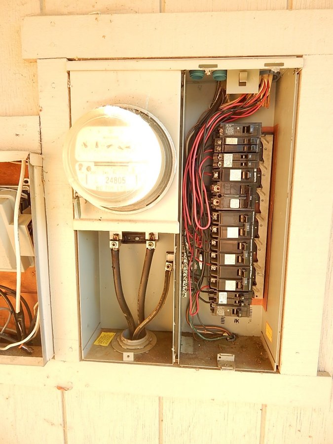

While we don't have individually fused supplies to each house, the good thing here is that whether overhead or underground, the service is always run in conduit. Here's where the underground service comes into the main panel in our house:
