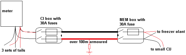

A freezer building on a farm is blowing fuses 83 seconds after starting.
It's a fair distance from the power source and fed by a double pole Cast Iron fuse box with 30A fuse wire directly off the meter, well over 100m of armoured cable buried direct, MEM 30A switched fuse which feeds the freezer plant and a CU with type1 5A for lights and 10A for a 15A socket.
The freezer has internal D20 and B4 MCB's.
It was always the fuse in the 'L' source that blew.

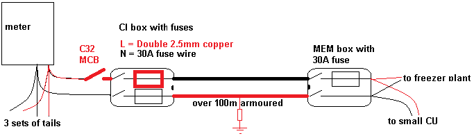

I happened to have a couple of boxes of MCB's with me and fitted a C32 prior to the CI fuse box.
At 83 seconds a timer relay isolates a sensor with no sign of any current increase using a clamp in the MEM box at the I/C to the remote freezer room.
We meggered the whole of the outbuilding installation including the plant control panel and components and found nothing wrong.
Testing the armoured cable found ~600Ω L-E & 1.2MΩ N-E. Obviously wrong but nothing to blow a 30A fuse wire.
We swapped L & N to keep the freezer working and the farmer has promised to dig a trench in the next couple of days for a new cable.

Sounds like you have a line to earth fault on the armoured cable. How did you measure the circa 600 ohms and at what voltage did you measure it at. Once it has been 'cooking' for a while with 240 AC on it, the resistance is probably dropping sufficient to blow the system fuse. Reversing L and N to place the neutral onto the defective wire merely masks the fault since N and E are near enough the same potential.
On a separate note, there shouldn't be a fuse in the neutral circuit within the CI box, it should be a solid link. If the neutral fuse blew the device on the end of the circuit would still be live.

No we haven't measured it during fault at source end but the fuse wire vapourised with a decent bang so it's a short.
It's only ever the source end that blows despite using identical fusewire at both ends. Having reversed the polarity of the cable, so the 600Ω is in the neutral, it hasn't blown since so we have blamed the cable which is some 70 years old. Additionally we included a B16 after the load end fuse during fault finding which never tripped.
The plant starts and runs ok until the sensor is disconnected and altering the timer setting to 2 mins alters the time the fuse blows so we know it's coincident. Nothing "switches" when the sensor is disconnected, no contactor, no relay, no motor just the operation of the timer relay [which we powered via a 0.5A MCB during fault finding]

We had to put oversize wire in 'L' fuse as 30A would also blow with MCB trip during fault finding.
So yes we believe the cable fault is the problem and seems to be... shall we say breaking down? under the tiny spike generated by the relay??? grasping at straws here.

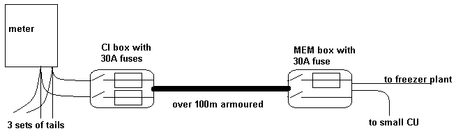

A 4 core 35 or 50mm² 4 core of old colours is coming up through the floor at each end and a pre used 4/12 way 3ph MEMshield board screwed on the wall at each end.
And we were going to get as much work pre-done so the new 3ph tails could go straight into the 'new board' with minimal down time.
So lunch time today the meter fitter arrived, had a look and very nicely ran new tails into the 'new board' and sealed the meter. Leaving no power to the whole farm.
My boss went out and cobbled the existing [mostly rubber/cotton] tails into the random selection of MCBs available to get it all back up and running.
We're still going there Tuesday to do the work, for now the freezer is still working on the old, faulty, cable without any functional problems.
