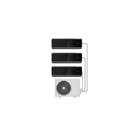

I am a qualified Electrician and am looking at installing my own AC unit. I have found one online that is a Pre Gassed - Easy fit - Split unit.
I am wondering if anyone has fitted these before, I spoke with the lad who was going to fit it as I originally paid for fitting, this was through Aircon Direct. He mention nowadays they are just plug and play so I have decided to give it a go.
I can attach everything to the wall and attach all pipes but a few questions.
1) The internal unit has a screw on the thin pipe, when I unscrew this it released gas at a HIGH pressure. I read online this is nitrogen to keep the unit free from condensation and water when storing. An that I have to remove this obvs to install the 5m pipes. Is this correct? Or have I broken the unit removing this.
2) My pipework is 5m long, I have screwed this onto the internal unit and drilled through the wall and taken this outside. The pipework being 5m is very long, I only req about 2-3m. Can I just simply cut this down? OR is the unit Pre Gassed with 5m of gas (If that makes sense) so if I cut it down will I need to lose some gas? If so how?
as above, if I cant cut it down, ill just have to coil it up behind the external unit.
3) If I can cut the pipe down, how do I go about doing this. I can buy a pipe cutter but is the end flared? So that the nut spins but doesn't fall of etc? Or am I best to cut the pipe down leaving the end on then connect the 2 pipes back together?
4) I've read online about pressure testing before releasing the gas from the external unit into the internal unit. I've also read a lot of American sites saying no need. If I have tightened all the internal connections and external connections nice and tight do you think this is needed? If it leaks gas, is this gas harmful? If not, does it have a smell so I can smell its leaking?

All the ones I have read (other brands and even this one) are quite clear that the outdoor unit contains enough gas for X indoor unit(s) of appropriate rating(s) and up to Y metres of pipework in total. Additional metre-age of pipes requiring nn grammes of additional refrigerant (etc.,.etc.,.).
You're doing this in the wrong order. Course first, then armed with the information and training, procure decent kit to do the install: probably including the A/C brand (that is a very budget brand).
PS I'd question the 13A fuse rating suggested in that manual; probably supply via a 16 or 20A rcbo rather than a fused spur if all three are likely to bused for heating.
