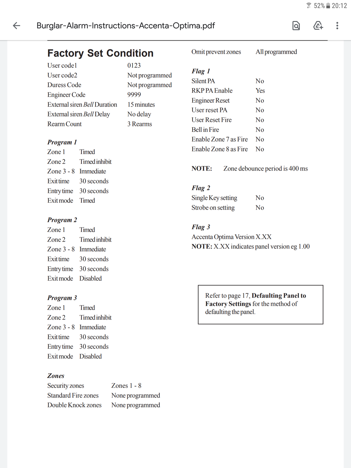

hi guy's, i'm a spark to trade so don't know much about alarms, i'm doing a bench test on the above alarm before fitting and have come across a problem ,when i use the user code then press p then program 2 everything works as it should, when i disconnect 1 of the zones that is inhibited the alarm sounds, if i use the omit button then press the zones i require everything works even when i remove the links, why does the alarm sound when i remove the links in the inhibited setting. thanks in advance

From default zone 2 is programmed as inhibit in all part set functions
thanks, seen that, my problem is i have 2 zones with pir's and need both to be inhibited at night. i've been trying to set it up on program 2, making zones 2 and 4 inhibited.

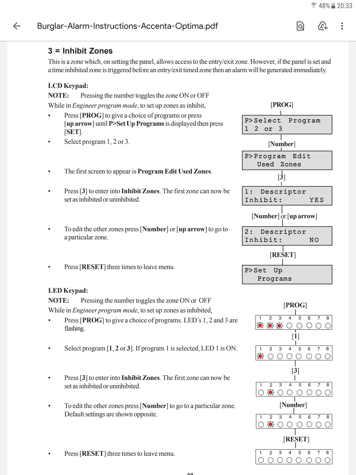

As per instructions
Use the zone number to toggle off or on, press 2 and LED zone 2 should go off press again and 2 will light up again. Ensure you zone 2 and 4 led's are off and press reset 3 times to leave mode.Screenshot_20201217-203341.png
think i've solved the problem, when in program 2 i've turned zone 2 + 4 to unused, this seems to have worked. thanks for all your help
