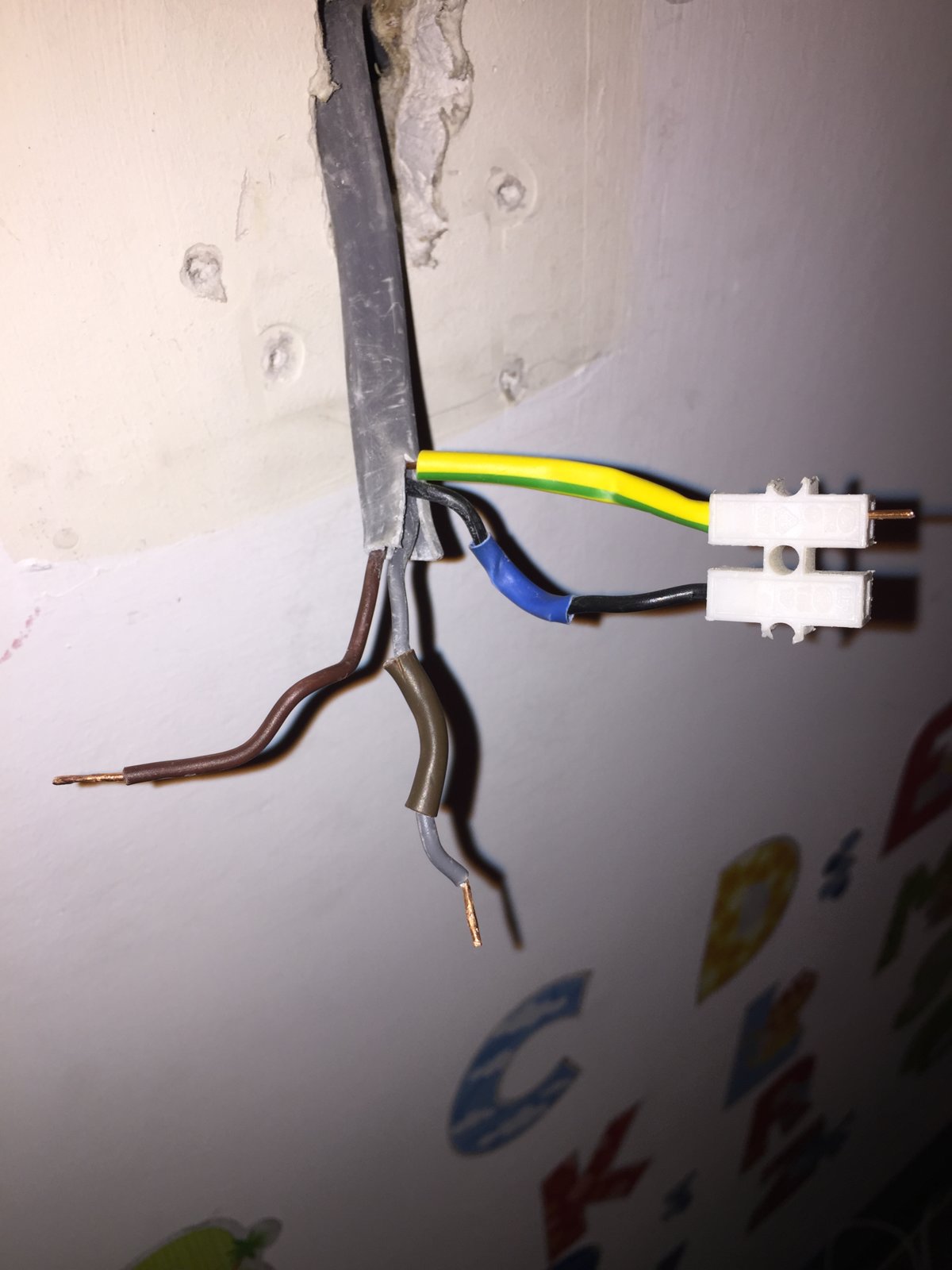

Hi there,
Firstly, I am not a plumber, but took the plunge and I have managed to successfully install a dual channel hive heating system to control the downstairs heating and the hot water, but have come unstuck when trying to wire in a second single channel controller for the upstairs heating.
My problem is that the previous thermostat/controller only used 2 wires and there are 2 other wires poked back into the wall because they weren't required, but I can't figure out which to wire where on the hive back plate. I have a brown wire, a grey wire with a brown sleeve, a black wire with blue sleeve and a yellow and green wire. (Photo uploaded)
Any help would be really appreciated!

The original thermostat was probably battery operated so didn't need a 230V mains supply hence only two wires were used. The Hive does however need a permanent mains power supply.

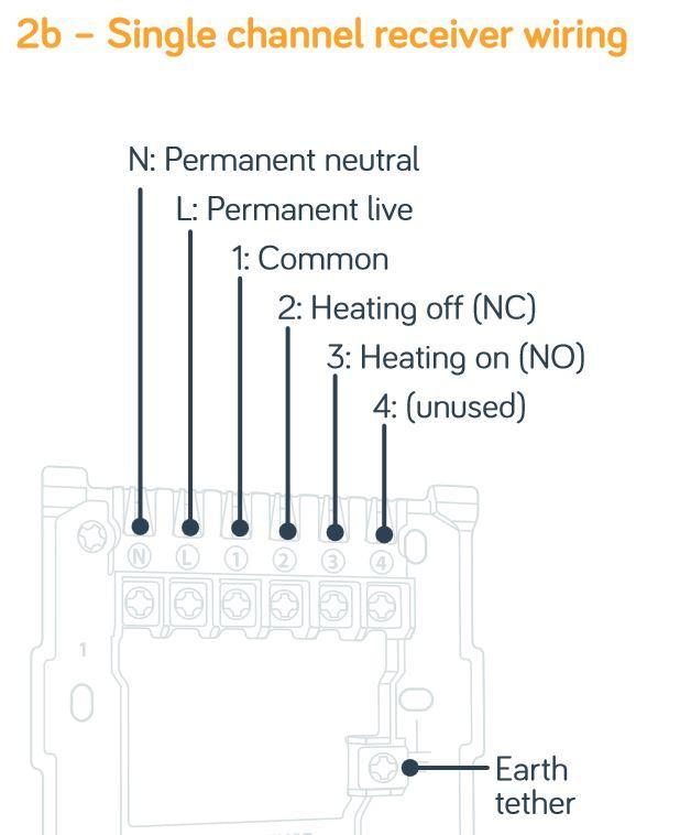

The single channel version of the Hive has the following connections:
The instructions below are based on the following two assumptions. If these are not correct, don't proceed but post back what is the case.
Assumption 1. The 'Brown' wire and 'Grey wire with Brown sleeve' were the two wires used by the original thermostat.
Assumption 2. This thermostat will be operating a 230V motorised valve controlling a single heating zone.
If both of the above is correct, then
Brown will be the 'Live' which would go to the Hive (Live) terminal
Grey will be the 'Switched Live' and would go to the Hive Heating on terminal (3)
The black wire with a blue sleeve should be a neutral, but please check that it is first, either by finding the other end of it and making sure that it is connected to a Neutral, or by checking it with a multimeter. Having identified it as a Neutral, then you can connect it to the Hive (Neutral) terminal.
Finally add a link between the Hive Live terminal and Common, terminal (1)

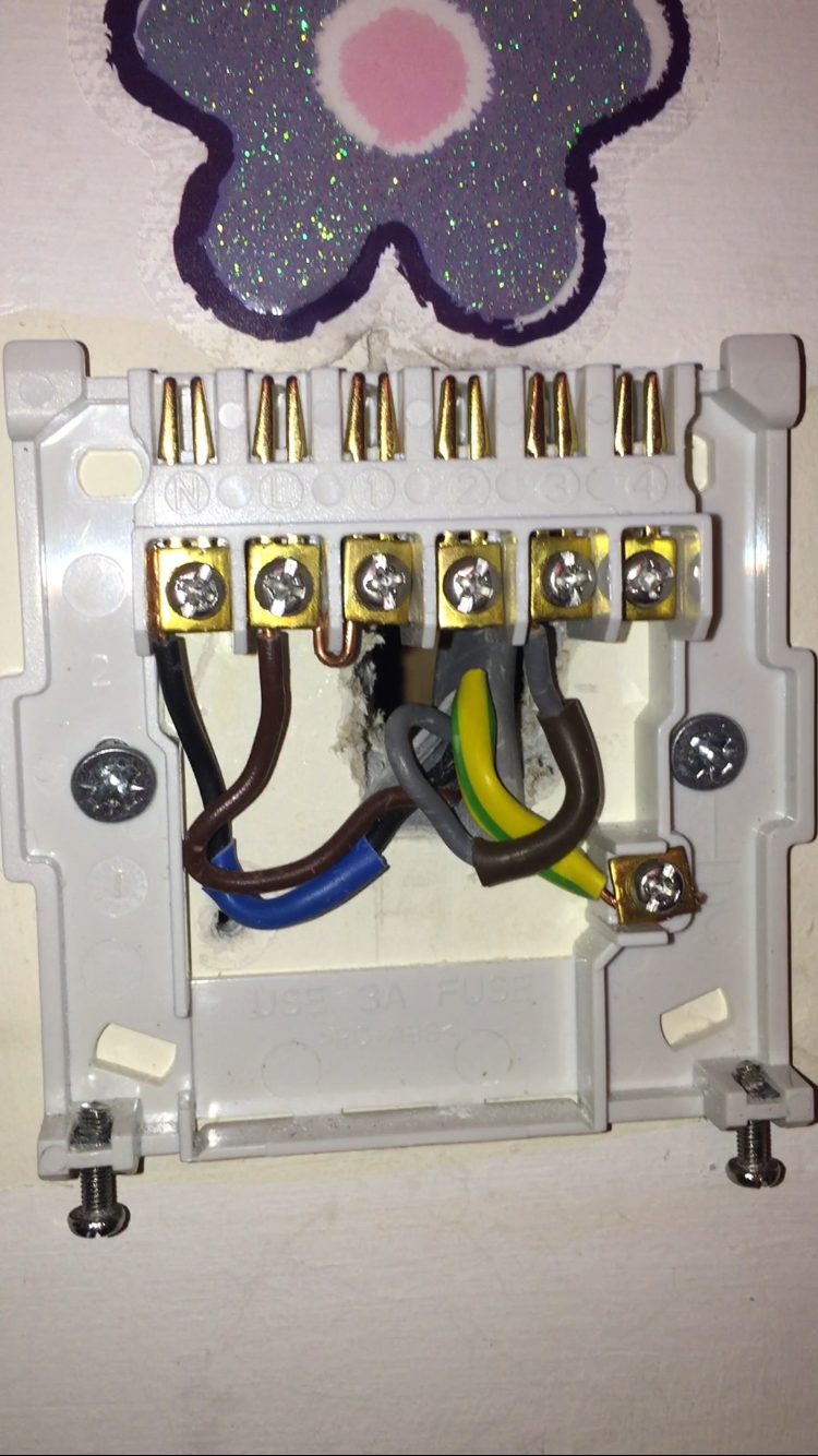

Thanks for that Stem, you sir are a legend!
I did as you suggested and now have both Hives up and running, Yey! :o)
I have attached a final photo of the wiring for anybody else that may be seeking clarification in the future.
