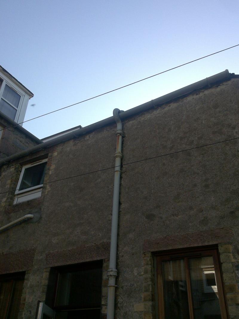

Hi kevplumb, so, can i break into this and use it for a drain for the kitchen sink? and is a strap on boss the way to go? cheers

Can we see the top part of the pipe.
Yep - it's definitely a vent - can't be anything else with that 45 degree tee up the way it is. I wouldn't try putting anything down it until you know where the end comes out underground - could be a couple of feet up the wall of an inspection chamber. Also watch out for pipe being choked with rust flakes that have fallen off over the millennia. You'd be better off replacing the whole thing really.
OK, so it's definitely a vent pipe, can you see where in joins the inspection chamber.

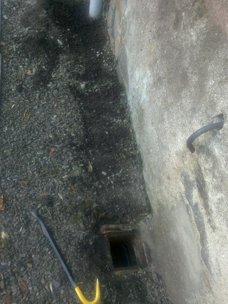

found this, its an old drain, the water is running away nicely, still cat find an inspection cover, do you think i can use the iron down pipe for my kitchen sink? cheers
No. Not without knowing what happens to it after it goes underground.
The old gully doesn't appear to have any waste pipes near it. Is it in a low spot and hence a surface water drain? If so there's no telling what happens to any water that goes down it.
Do any of your mates have a metal detector? Could be useful for playing "hunt the manhole".
Those paving slabs could be covering a multitude. Try taking a peek under them. (Just hope no one's done a 'Brookside' on you :!: )
