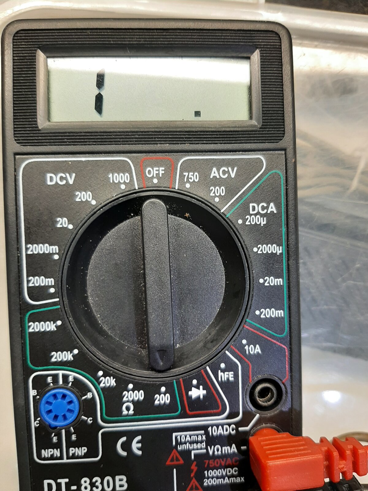

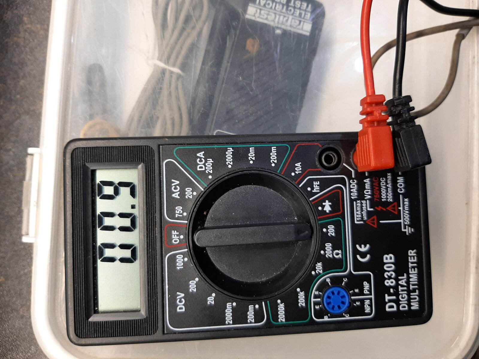

Hi SFK, putting multimeter in CK and COM gives me the reading in the first photo (1.) And in CB and COM gives me the reading in the second photo (00.9).

That is a good/correct result.
I am presuming the pictures are when the Door is NOT opening.
For reference, inside the relay imagine a wire permanently fixed at COM, and that can then move between CB and CK.
- When relay is not operated the wire touches and makes contact between COM and CB (voltage is able to go from COM to CB) .
- When relay is operated the wire moves off CK and touches and makes contact between COM and CB (voltage is able to go from COM to CB).
Looking at your Pictures:
COM and CK - Multimeter shows '1' >>> This means infinite Resistance between COM and CK.
- No connection between COM and CK
- This means that this switch is OPEN between COM and CK,
- If you had Live (Brown) coming into COM and Switched Live (Brown) out from CK to your bulb, the bulb would NOT be lit.
COM and CB - Multimeter shows '0.9ohms' >>> This means No (very little) Resistance between COM and CB.
- There is a connection between COM and CB
- This means that this switch is CLOSED,
- If you had Live (typically Brown wire) coming into COM and Switched Live (typically Brown wire with black sleeve) out from CB to your bulb, the bulb WILL be lit.
Again - I am presuming that above pictures is when the Door is NOT opening
- From now on ignore connection CB and do not use it (otherwise bulb will on all the time when motor not working and off only when motor working).
- Only use the two connections "COM" and "CK".
- This is now your switch that will later control your bulb.
Put your multimeter into COM and CK.
- Multimeter will show '1' for Infinite Resistance between COM and CK because there is no wire in the relay between these two contacts. (and so imagine your outside bulb not being lit).
- Open your garage door.
- If all works properly the Relay will be triggered moving the wire inside it so it is between COM and CK, and the multimeter will change to show a low resistance say '0.9ohms' between COM and CK meaning switch is now CLOSED (imagine your outside bulb now being lit).
- When motor stops working, the relay will be un-triggered removing the wire between COM and CK, and Multimeter will again show '1' for Infinite Resistance between COM and CK (the motor might have a inbuilt delay to keep light on).

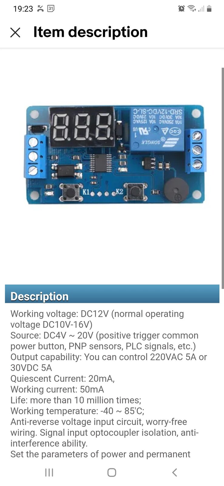

1) Which relay module did you buy (can you post an ebay link?)?
2) When Relay Module is connected to the 0V (GND) and 12V (VCC) and Switched_12V (IN) of the motor does the relay module turn on and light up (ie are its LEDs on?).

It's fine, I appreciate its all trial and error and I'm not the perfect student!
Here's an image of the relay module I bought, I'll do the tests you mention and report back.
Thanks again.
Forgot to say, when i connected the relay module to the connector on my door motor the countdown timer was illuminated.
