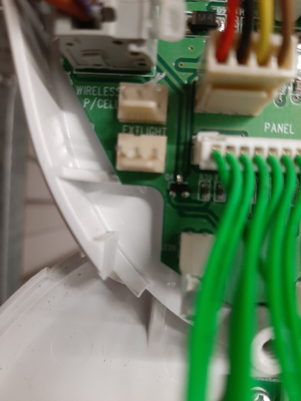

Hi, I have a GRD+ Gliderol motor on my roller garage door. I want to fit an external light that is connected to the motor so when it activates the light comes on.
There is a 3 pin connection on the main PCB within the motor housing which states it is for an external light. However, I believe I need another PCB to plug into this connection to get this up and running. Question is can I connect directly to the 3 pin connection without adding another PCB and if not where can I get the PCB as I've searched everywhere and they don't seem to be available?

Would be interested to see a photo of the circuitboard as well.

I've took a photo but I couldn't see any markings adjacent to it.
Shame.
My guess (if they are consistent looking at other connection) is that left is 12V, middle is GND and right switched 12V.
As said it is a guess, but that is how I would test if you have a multimeter.
SFK
Hi SFK, I tested the contacts, using the far left and far right contacts and I'm getting 12v so I'm guessing the middle one is the switched live, would you agree and if so would the module in the ebay link do the job?

It would be sensible to confirm (carefully) with your meter that the centre pin does change state with motor running- it may just pulse at motor start rather than being high while motor running.
Doesn't make the job impossible, just means you'd need a delay relay (which would make total sense of the permanent 12v on that connector)- you're looking for off delay (where the relay once triggered latches for x seconds)
Very good point from oldbutnotdead.
My assumption was that Switched 12V would be on for as long as the onboard LEDs (I actually assumed it was the same wire - in a similar vien to 333's suggestion).
But as oldbutnotdead said it might just be a pulse.
Can you safely test this?
Otherwise, get the relay module, wire it into the 12V, OV and switched live (but not the side 240V yet) and listen to see if you can hear the relay switch as you activate the door (or use multimeter in the relay output blocks, set on continuity and listen to the multi meter beep).
If it is only a pulse you need a 'timer relay module".
And you need the type with three inputs - 12V GND and Switched 12V
