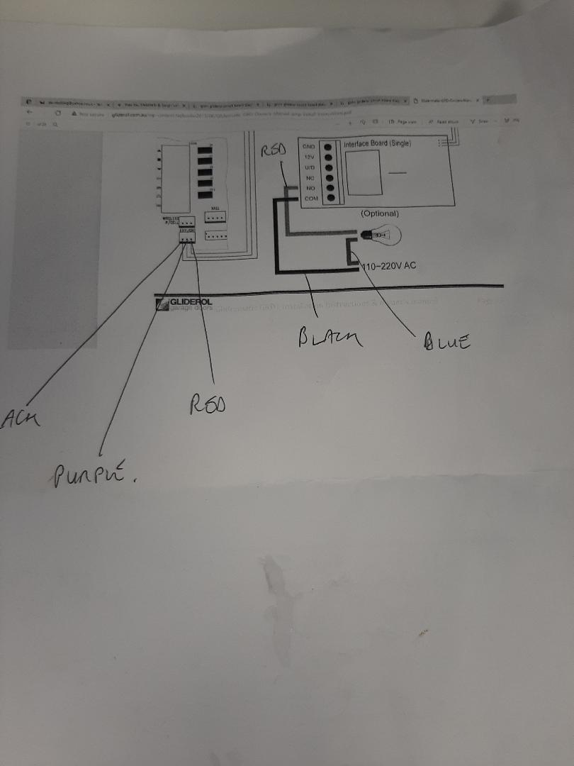

I came across this diagram from Gliderol which shows the option interface board that can be purchased to add an external light, please ignore the hand written notes.

My suspicion, which I mentioned earlier, is that the output is what is known as a form of 'open collector'. Either the the Middle, or Right 12v is an open collector output. The output will always be at 12v unless a load is applied to it. I would try connecting a 1Kohm resistor between each of those terminals and ground, as what is known as a 'pull-down', then with your meter see what happens to the 12v as your light / door is triggered. If there is no change, even slight on one terminal compared to the other, then that suggests the output is damaged.

Hi Harry, apologies for the ignorance but if i did the test with the resistor and there was a change would this mean there would be a way of adding the external light.
Its not a light I need for inside the garage, its just a small light I want to connect externally so when I press the door open button on my fob I can visually see the light come on to confirm the door is opening as I cannot see the actual garage door itself from the house.
Sorry I hadn't quite grasped what you were trying to achieve....
I think you are saying there is already some sort of light in the unit? Mine has 6x superbright LED's which come on and remain on for a while after the door has been operated - If your is similar to mine and all you need is an indicator, could you not disconnect one of the LED's, then extend where it was connected on the PCB with a pair of wires to the house, then refit the removed LED in the house?
If you must use your 'extender' gadget....
Attach a 1k resistor to the terminal you know to be 0v/ -ve and one of the 12v terminals, then measure the voltage across the resistor with your meter as the door is operated.
Repeat the above but with the resistor as above, but connected to the other 12v terminal. Which ever one shows a change in voltage, is the output terminal. The one which doesn't change is the actual 12v terminal.
