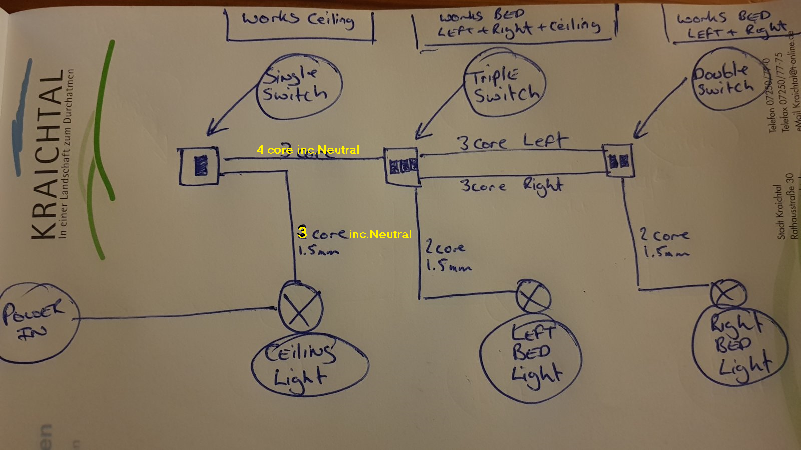

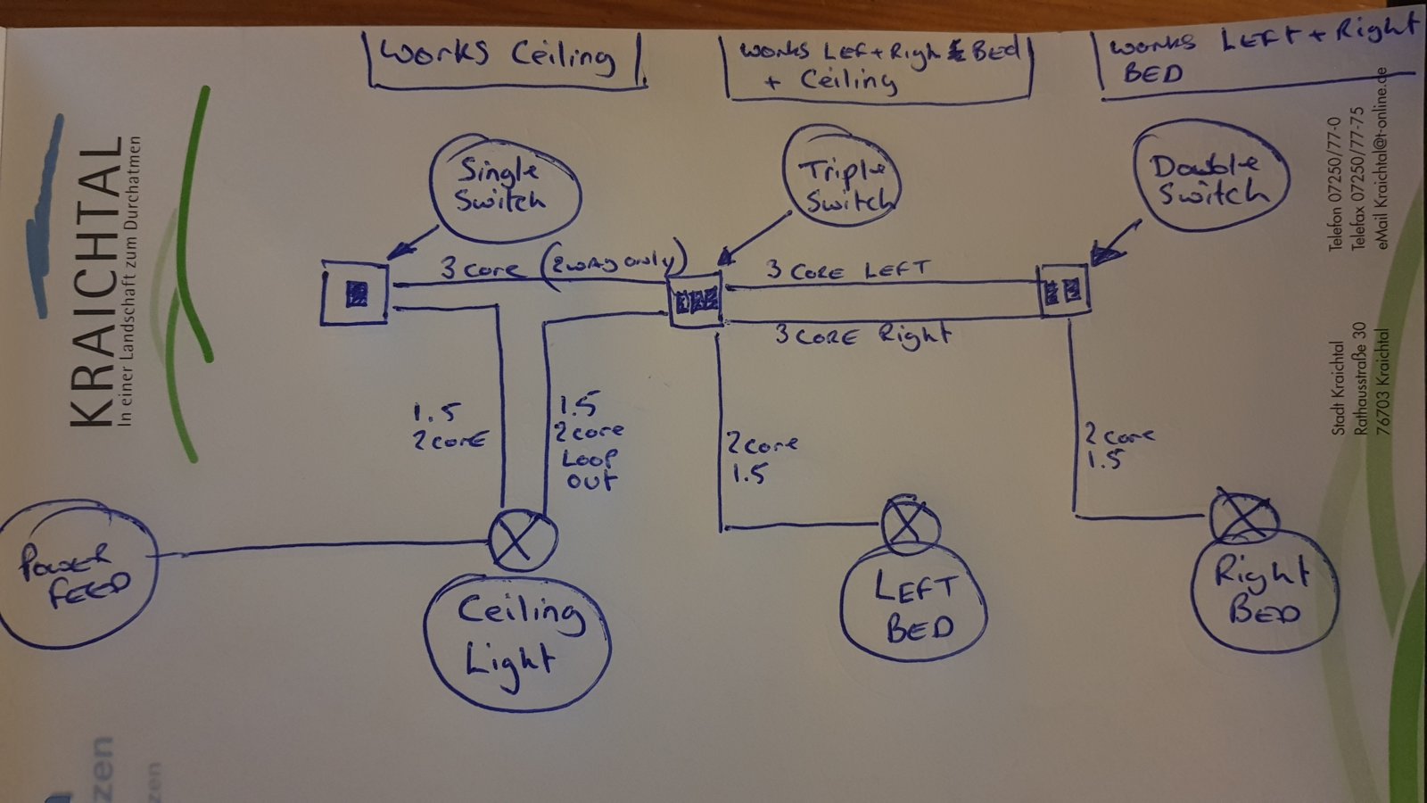

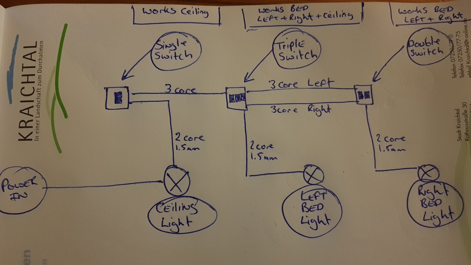

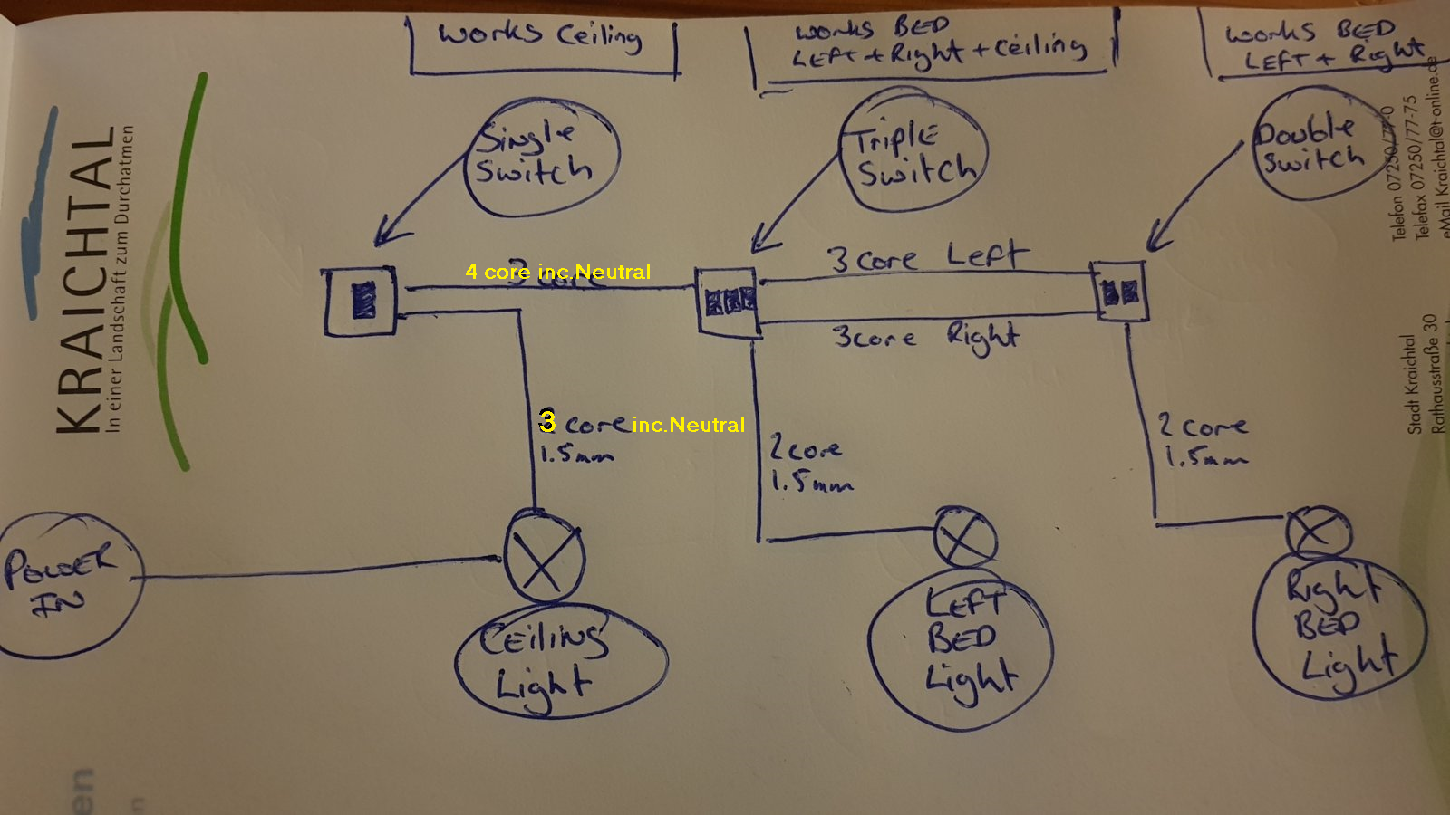

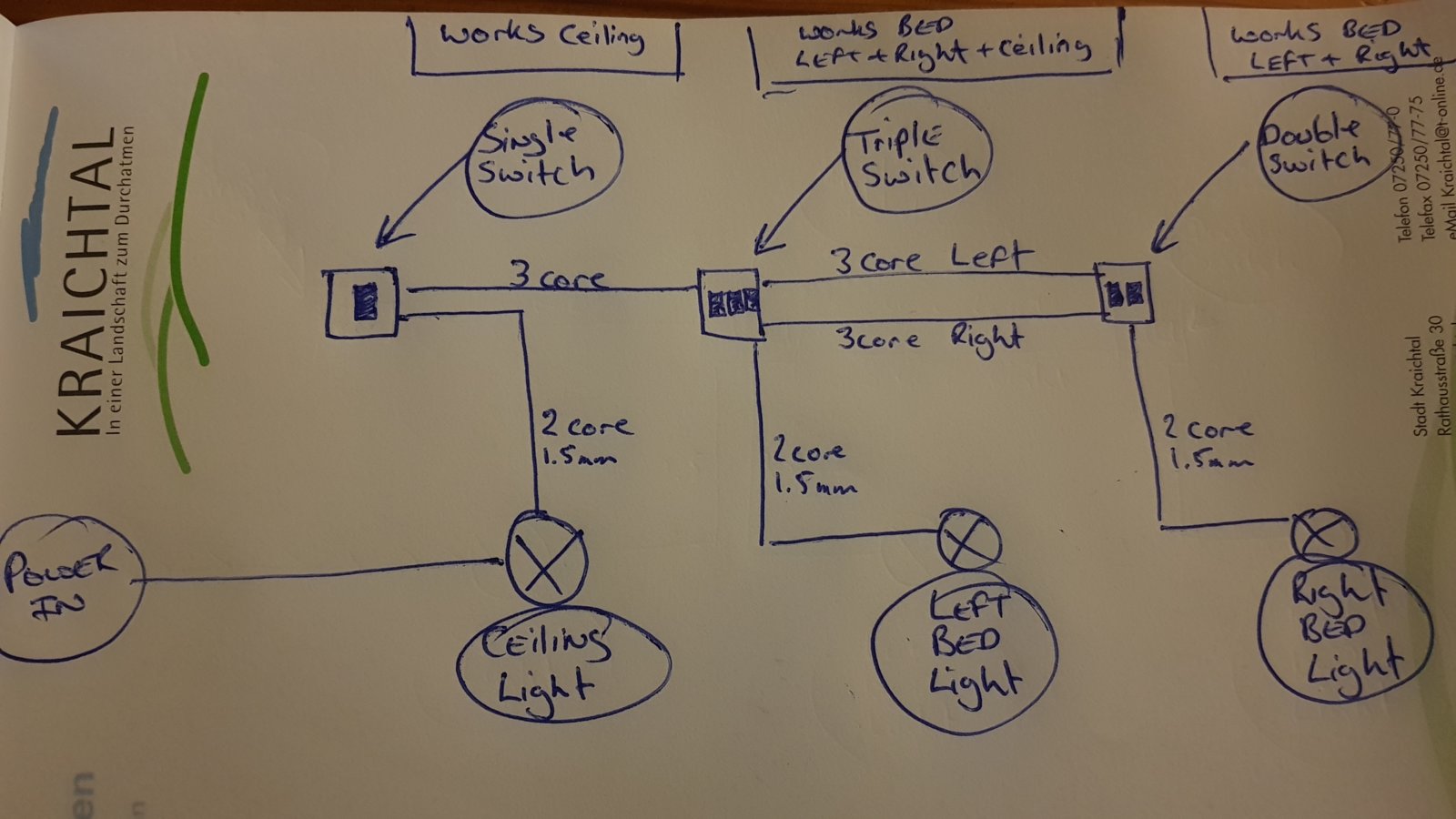

Hi all i am wondering if someone can advice me on the supplied drawing. As it stands the only thing in place is the power in, ceiling rose and single switch. And i am unsure if this layout is correct. I only want to run the cable ready for the sparky as hes away at the moment for me to ask and i want to plasterboardthe walls.
I am unsure if a 3core from ceiling rose to triple switch is also needed or if i can just power from the 3core cable.
Please ignore the 2core in the image ive provided as ive mislabled it as its infact a 1.5mm twin earth lighting cable.
Thanks in advance

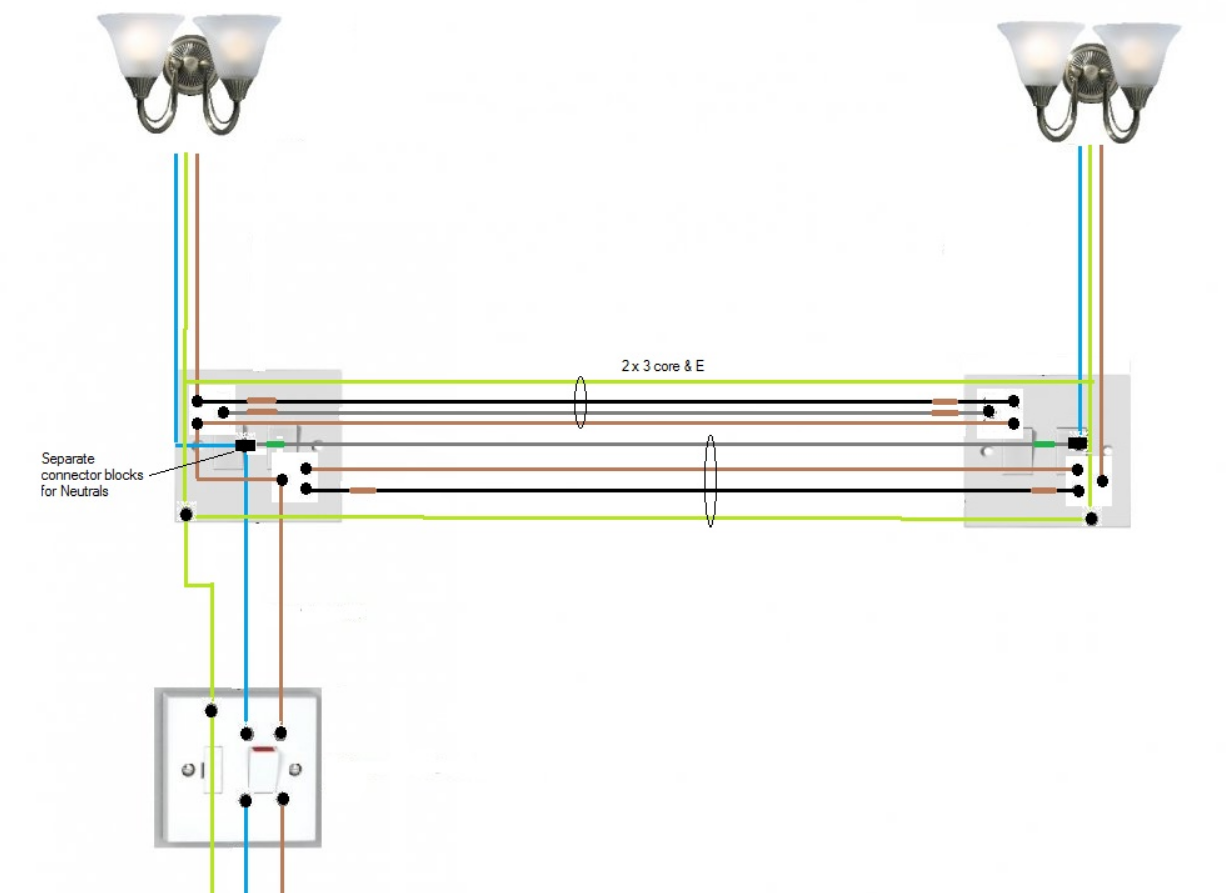

All core numbers will be excluding the CPC(earth wire).
1mm² will be more than adequate throughout - smaller is acceptable if you use flexible cables.

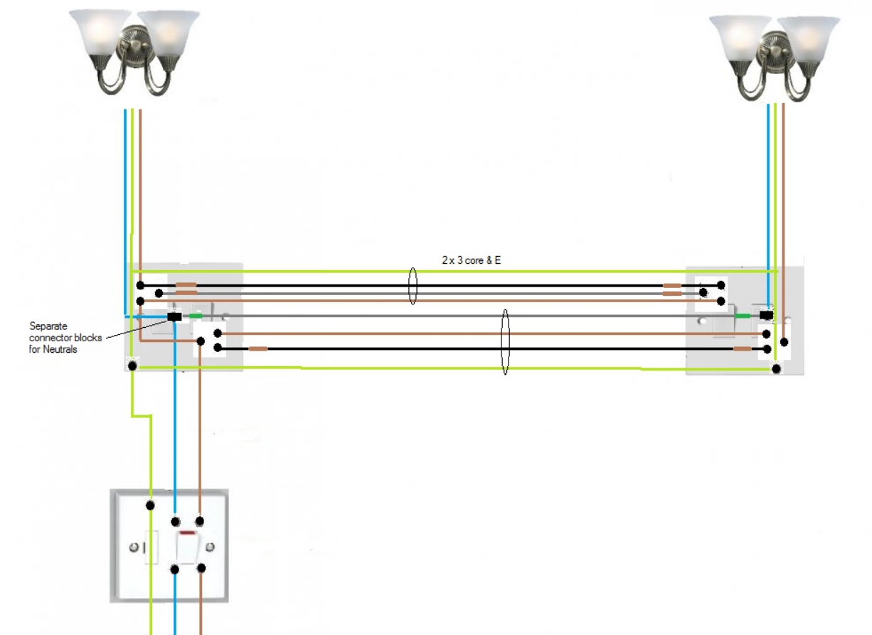

Also here is a diagram for two-gang bed lights.
Substitute your supply from the lighting for the fused switch.

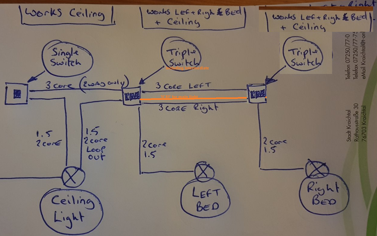

Thank you for the response much appreciated i am unable to work a spur and need to get the feed from the existing light circuit. I was wondering if this next layout with an additional 2core and earth feed be more acceptable.
You cannot use 2 core cable, it must contain a CPC(earth wire).
Flat cable is called twin & earth or 3 core and earth.
Flexible cable is called 3 core, 4 core, 5 core etc. including the CPC.
Flexible cable is called 3 core, 4 core, 5 core etc. and includes the CPC.
When i say 2core i think im confusing things. And misunderstanding the cable. I mean to say 1.5mm twin earth lighting cable which includes the earth cable that needs the sleeving and 3 core and earth for the 2way switches only.

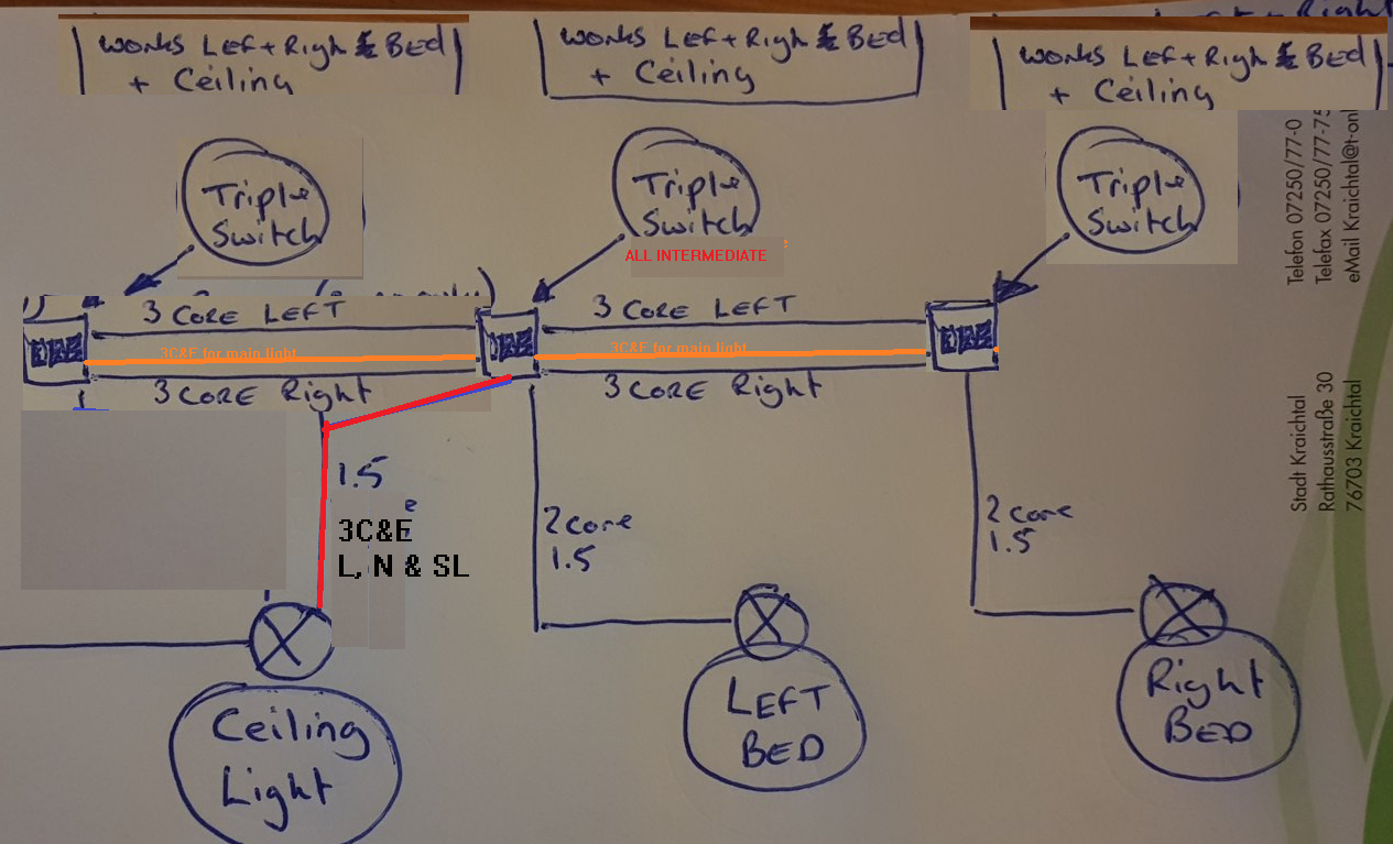

Just out of curiosity as im not a sparky but a carpenter, the 2nd picture you gave with the spur feed i was wondering if the wiring be the same if the spur feed was replaced with a feed from another light / ceiling rose?
Yes, I did say substitute your feed from the lighting circuit for the fused switch on the diagram.
You just have to make sure there is a supply Neutral available for the new lights.
The only thing that still makes me unsure with that picture is that both the 2way switch wiring is unclear as to which points are l1 l2 and common.
The point of the triangle is the COM, the other two are L1 and L2; it doesn't matter which is which; it is up to you to decide.
