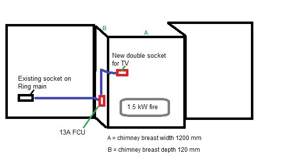

Hi, I have a fairly modern house (2006) which had a gas fire installed in the chimney breast. The fire has been removed and the gas capped off by Gas Safe engineer. The fire place has been boarded up and I plan on having a 1.5 kW wall mounted fire with the TV above it. Is it permissible to add a 13A FCU yo the existing socket on the ring main and hardwire the fire to this, then run a double socket further up the wall for the TV as per my very rough drawing?
I'd grateful for any advice.

Thank you for your replies, yes I understood this would be the case to avoid exceeding the total current.

Anyway, as said purely for an electrical point adding a point to a ring or radial is usually ok if you limit that total with a 13A fuse therefore the fire and the twin (or umpteen) sockets are on the fused side.
