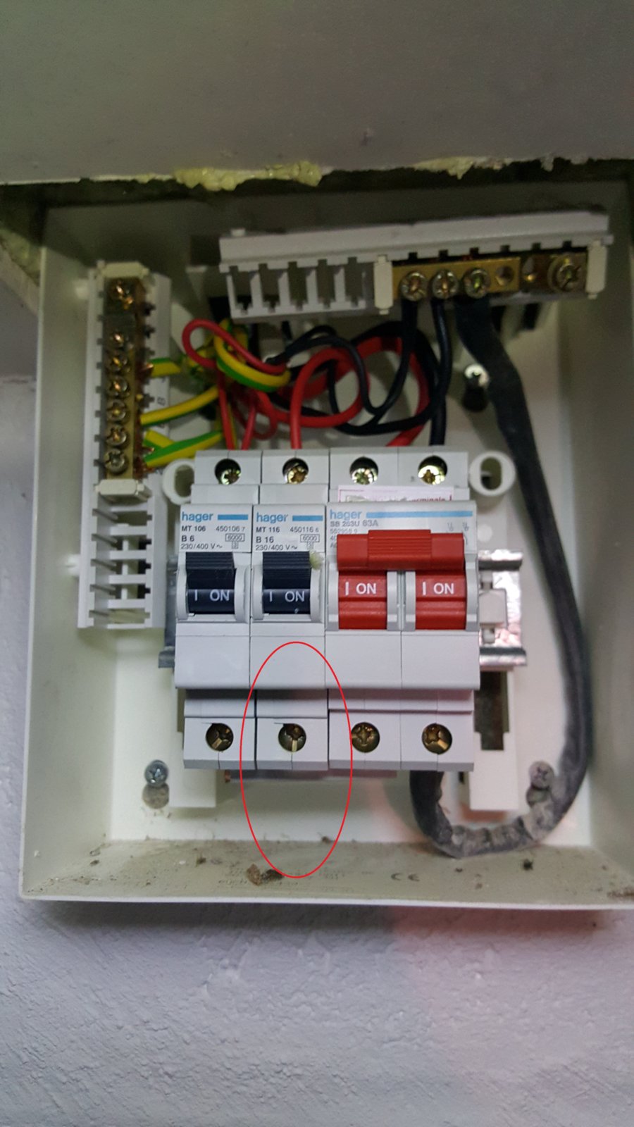

Hi all, I'm building a work bench in the garage and would like to add some sockets to it. There is a separate small consumer unit in the garage and the bench just happens to be right underneath it.
Can I just add another socket in from the bottom to the one already used
for sockets? (circled)
Circuits are connected to the top of the MCB.
There is no RCD in that consumer unit, which any additional sockets will require.
Is it possible to add another RCD alongside the ones there currently? Sorry I have no experience with consumer units but trying to learn. Thanks
show us the CU (presumably the main house one) that supplies your garage. Possibly the circuit is RCD protected there.
In your little garage CU, the main switch could be changed for an RCD. Its been a long time (over 20 years) since new sockets that could reasonably be expected to be used with outdoor equipment (such as lawnmowers, car tools) had to be RCD protected.
If that MCB already supplies one or more sockets, it might be preferable to alter or reroute the existing circuit cable to add more sockets along it. Be aware that the MCB is 16Amp, so you will only be able to run one large appliance, such as a fan heater, off it, or a larger number of small appliances.

No need what so ever to put a RCD in the garage. It is already protected by the one in the house.

I can just connect the live into the top of the current 'socket' MCD in the garage consumer unit?
Just to clarify if I was to install another MCD in the garage consumer unit I could have another separate circuit for the new socket?

Turn it off first, but yes live in the top, neutral in the neutral bar, and CPC in the earth bar.
RCD is the wider thing in your main cu where it says RCD protected circuits, MCB are the small switches one for each circuit.

There's a good chance your sockets MCB in the garage unit could be increased, but without knowing the cable routing there may well be a good reason for it being like that.
It doesn't look like you have any spare ways in the garage board, but you could do other things to get around the problem, possibly including changing the breaker to 20a+ and using a 13a fcu to run the existing socket circuit plus the new sockets in parallel. But that would be a job for an electrician.
Thanks John D for the great tips, knowledge and the time it took to reply. Much appreciated. I had just realised my mistake calling MCB RCD's and edited my post. At least now I have a little knowledge when I speak to an electrician.
