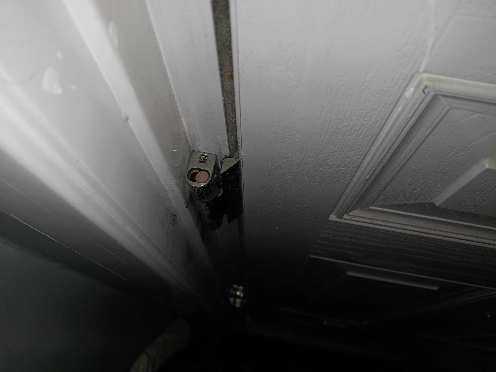

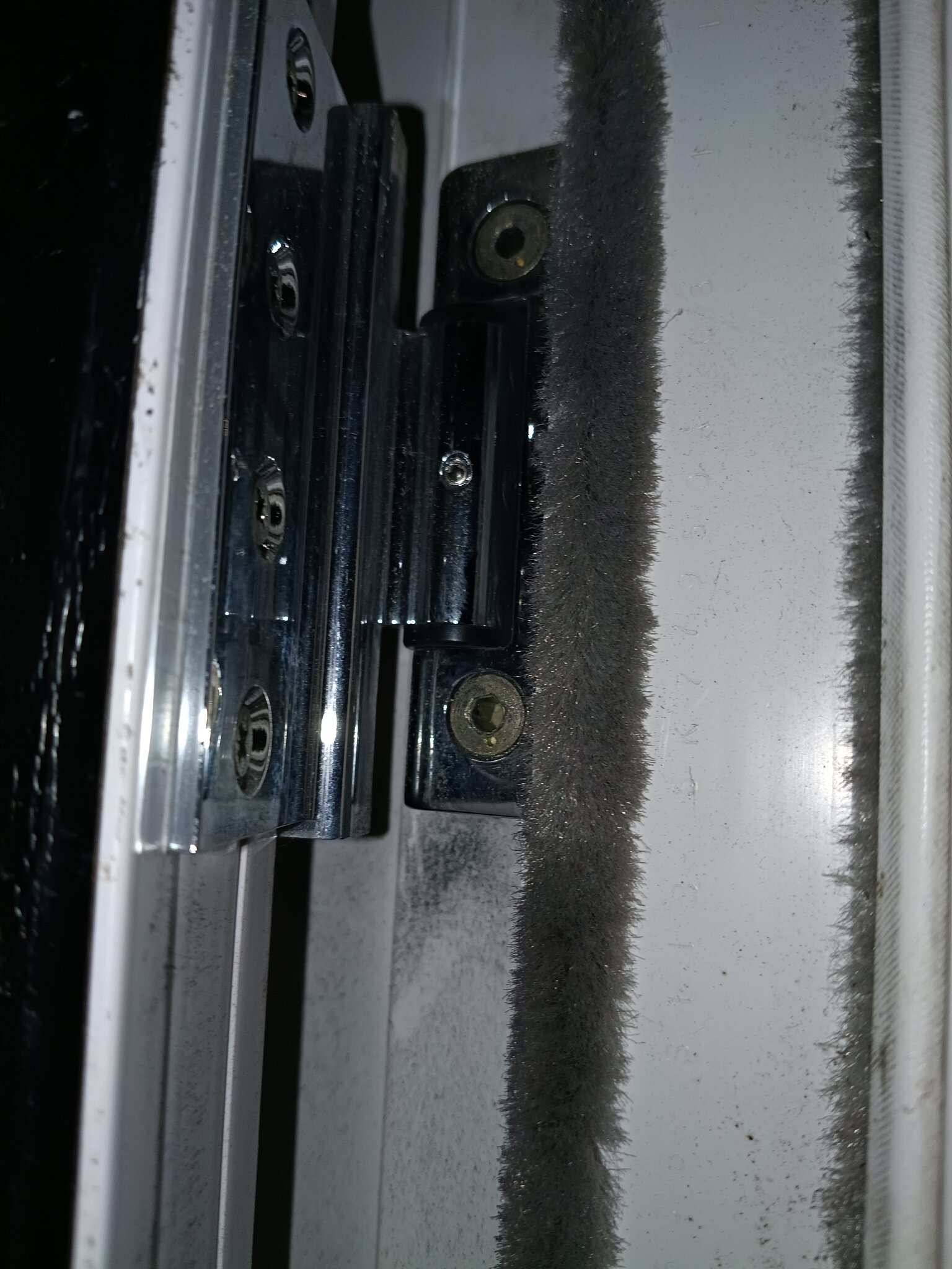

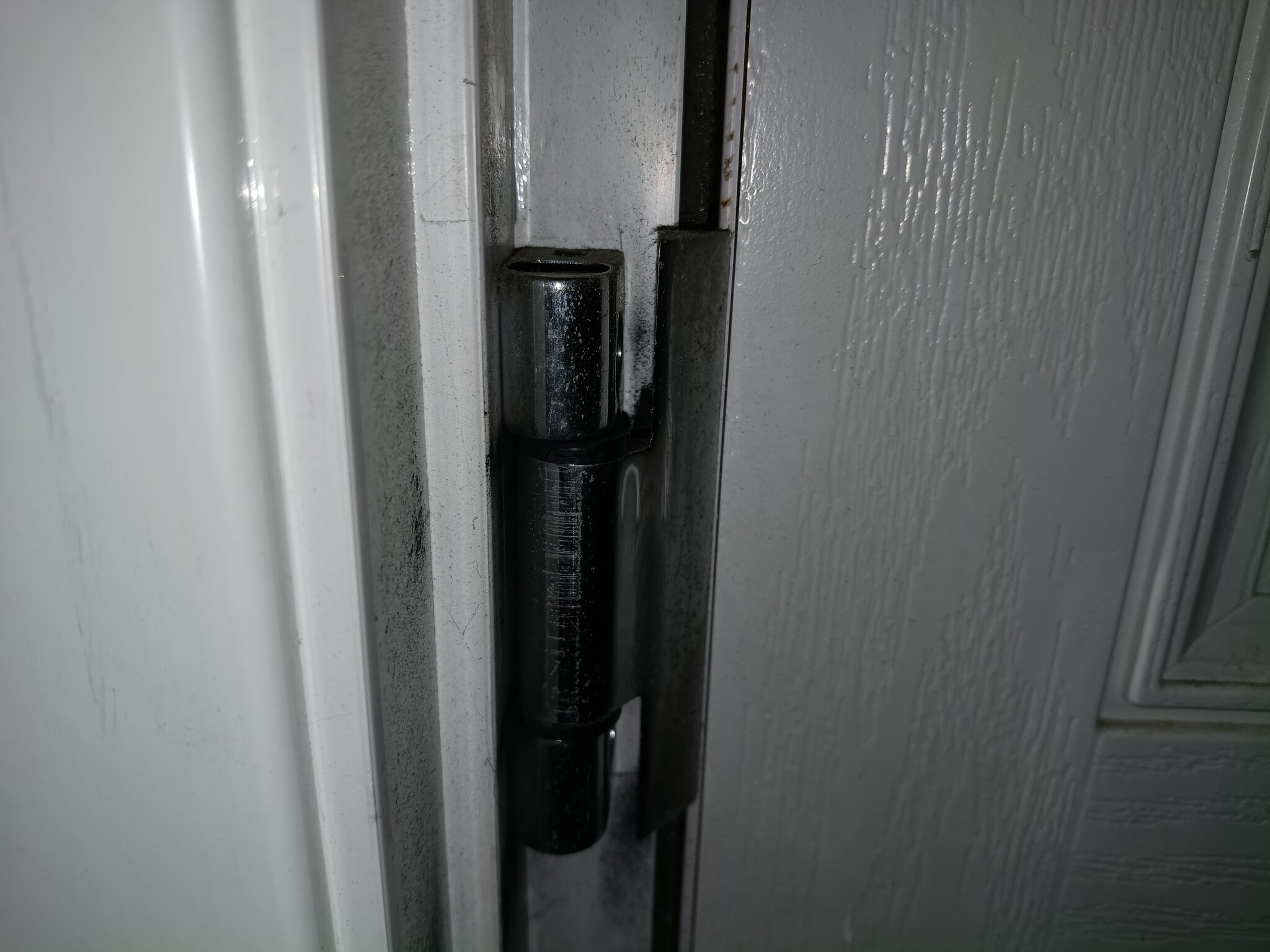

Anyone know how to adjust this hinge? I want to pull the door across towards the frame. I'm assuming it involves moving the pin in image 2 across to the left, but I have no idea how to do that.
In your third picture,the right hand side part of the hinge there is two Allen bolts, you need to turn these BUT they look incredibly worn. Looks like its a composite door too so toe and heeling the glass won't help either.
If they won't move you may have to get another hinge, or as a temporary measure possibly swap the centre hinge for the top hinge , just remember though if you adjust the top hinge, you will need to counter adjust the bottom hinge or the top hinge will be taking all the weight ( and vice versa)
The bolts do move, but it makes no difference to the hinge. The pin in picture 2 moves when the door opens, but adjusting the allen bolts doesn't move it.
Well it should, probably broken then
