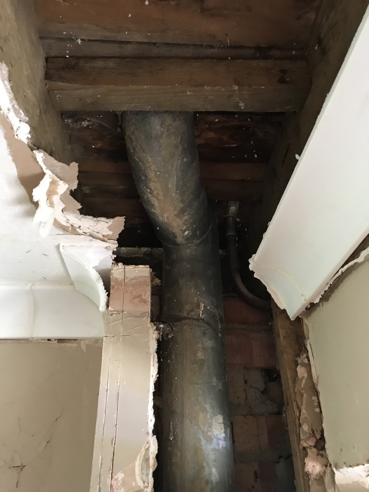

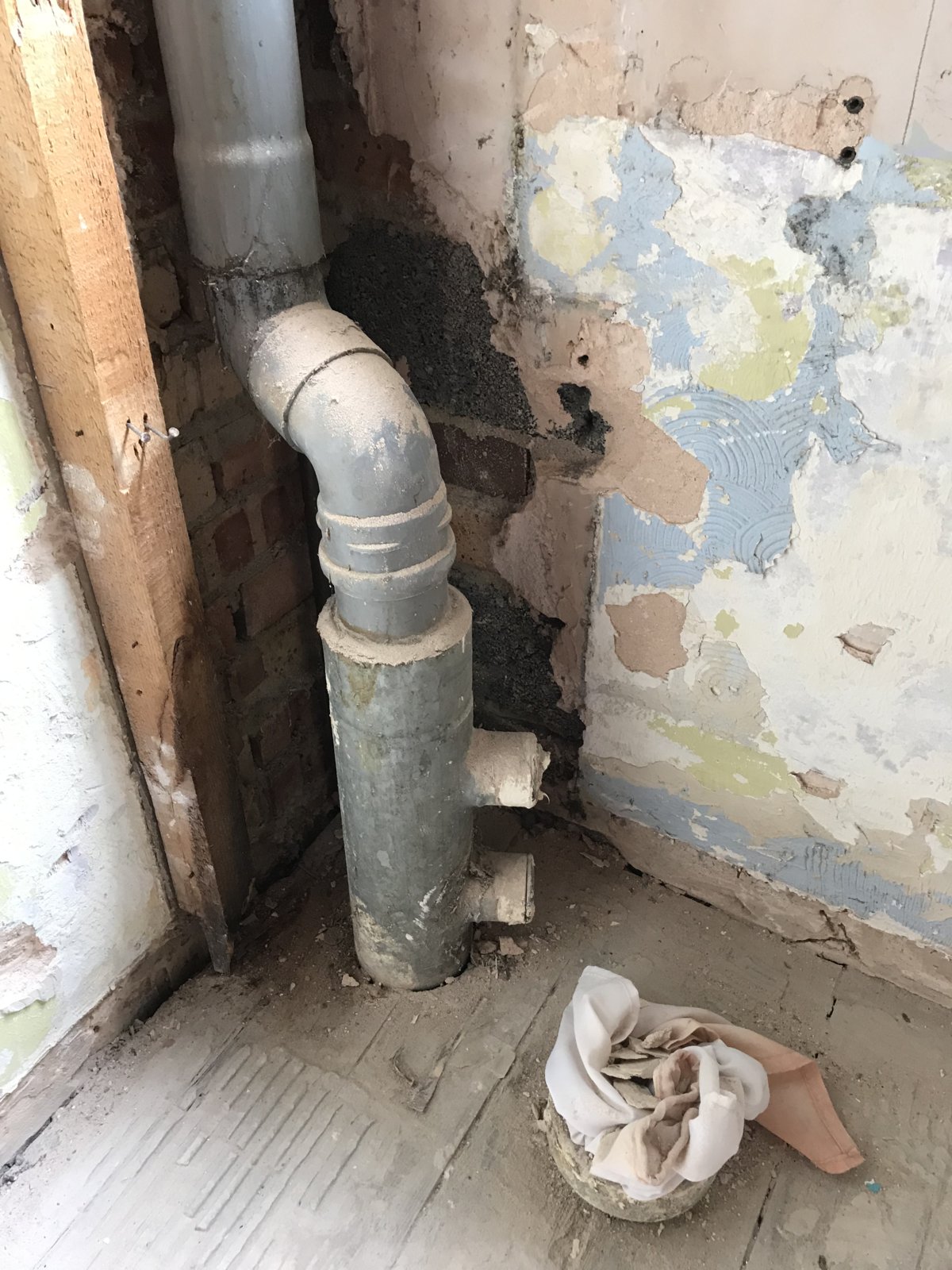

ive got this metal soil pipe that I need to alter to take a inlet from my 40mm waste and the pan connector.
This is the picture from underneath:
And from within the bathroom:
Is this permissible and can I cut this using metal grinder?
Once cut, which fitting do I use before I use the appropriate 110mm fittings?

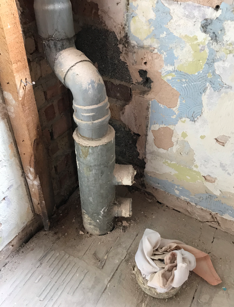

You need to try and identify the metal soil.
Looking at your photos, it appears the joint between metal and plastic has been made with a gap filler and haunched in... Is that sand and cement or some kind of putty or silicone? I'd chop away at that joint and get an internal and external diameter of the metal pipe, then you can search the mcalpine website to see what mechanical fitting can be used as a transitional coupling.

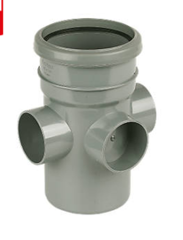

I will be purchasing a close coupled toilet and connecting the pan via a vertical connector (or flexible) into the ground. I am slightly unclear on what sort of 110mm pipe I need to have at ground level.
Is it for instance one of these with a rubber ring or a different type?
Hi @dilalio, can I have your advice on the above fitting please? Thanks for your help
I don't know if that's the "exact" fitting you need as I assume you'll be connecting the bath and basin to one of the bosses on the front or side. So, depending on heights you're trying to achieve, you may need 2 separate fittings (to keep one below the floor for bath waste and one up higher for wc)?
However, yes... That top female connection would néed a short bit of 110mm pipe put into it and then the pan con goes into the pipe... Or, you could use a solvent weld female with a bit of pipe in it... Which I'd prefer to use.

Sorry for the scant info in the earlier post. My current thinking is that I will have a T put into the current metal soil pipe. This will come out at the floor joist level (below bathroom floor). There will be a small section of 110mm pipe in the inlet pointing in the joists. At this point I need a connector which can take the toilet pan (this will push the toilet inlet towards the wall which is required for a close coupled toilet) on the top and a single 40mm bath waste. The basin waste will merge into this 40mm bath waste upstream.
Which fitting do you recommend for this please?
the colour suggests galvanised steel to me, which I have not seen in a house before and may need special fittings. Please test it with a magnet. is it by any chance a converted industrial building? What county are you in?
BTW you can still get a WC to fit that floor socket. Often called "bottom outlet" pan. Please measure the distance from the wall to the centre of the socket (accurately)
