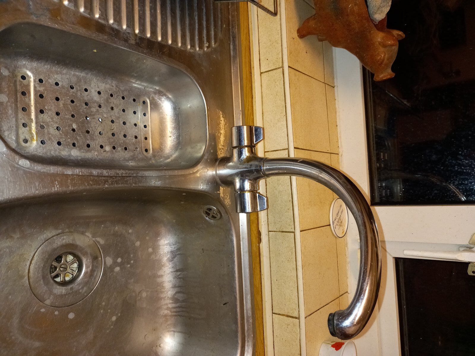

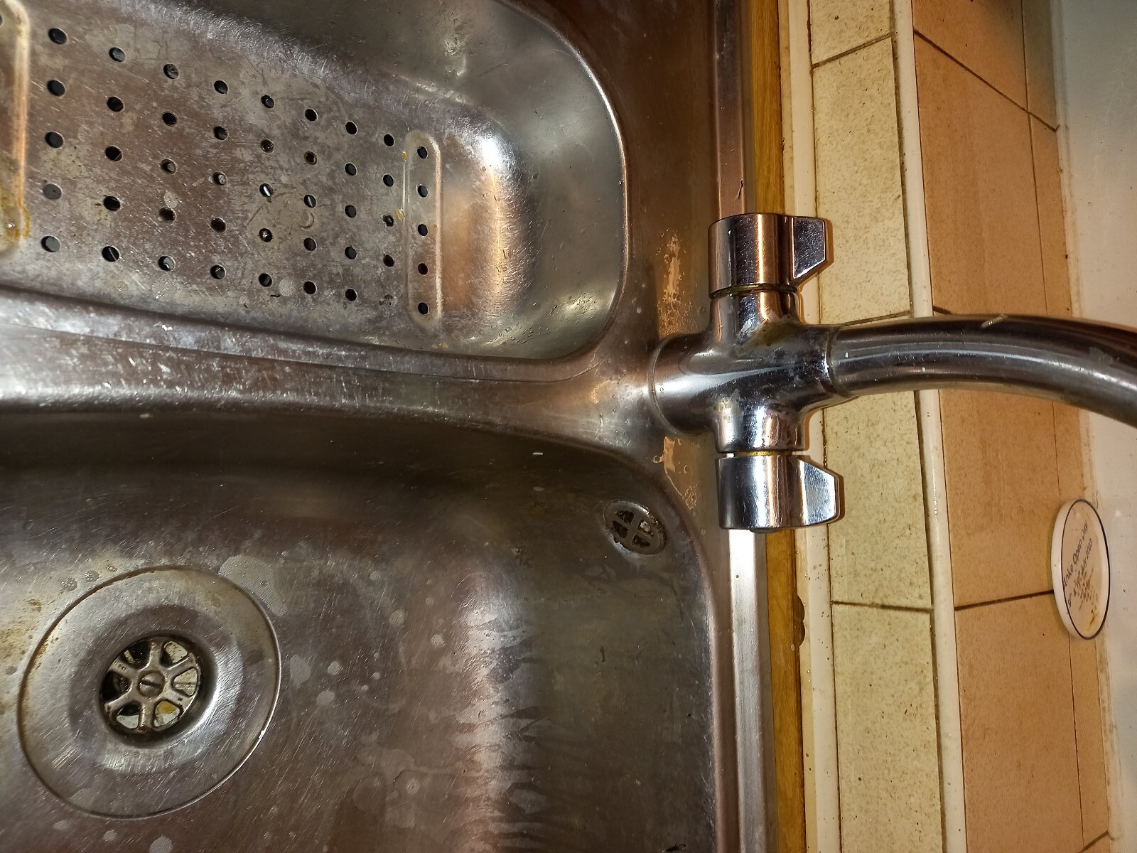

Taps rocking back and forth is the main problem with a flimsy sink. If you plumb in solid copper rather than flexis it gives a big improvement. More trouble, but unlike flexis lasts indefinitely as well.
My Blanco one I fitted in 2000 has flexis.
So do all the other monobloc's I have fitted since.
