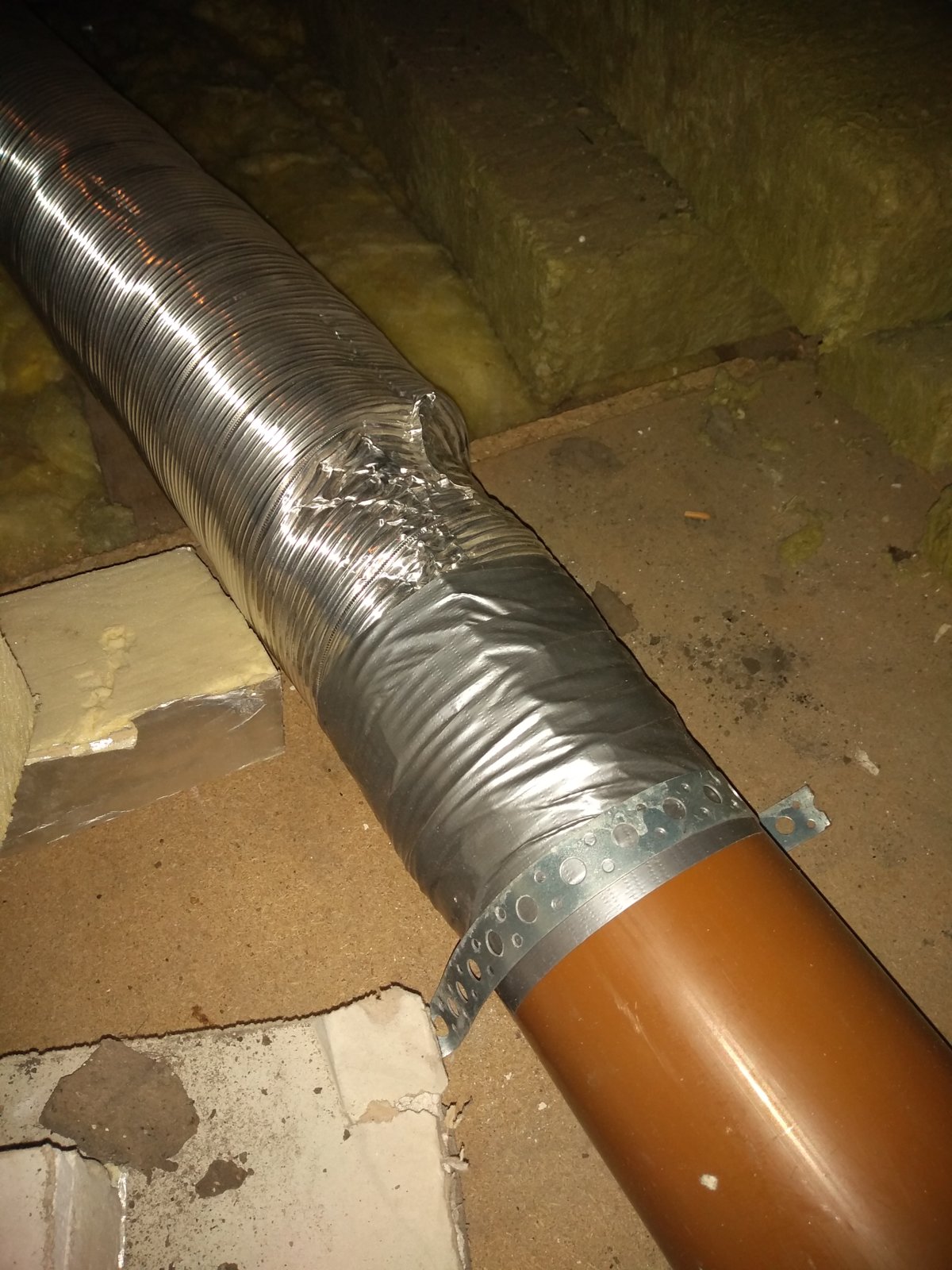

I previously thought I had a problem with leaking ventilation ducting from an extractor fan vent in the loft caused by steam from the shower fan and/or a leak in the roof.
This originally started as a nail had pierced the flexible ducting used to connect the 2 pipes in the loft and water was building up in the ducting as the ducting wasn't well insulated and very loose fitting (running horizontal in sections).
I've now established that this is actually a soil vent pipe after removing the ducting as we were still getting a leak into the bedroom ceiling below even after making sure the roof was sealed and not using the extractor fan at all.
It sounds and looks very similar to this issue experienced by someone else: https://www.diynot.com/diy/threads/soil-pipe-vent-full-of-water.453437/
Is it possible that the extractor fan for the shower could be connected into the soil vent pipe? They are in close proximity and I can't see anywhere else obvious where the extractor fan would vent via.

Firstly, I strongly advise you do not remove any existing vent for the soil pipe. Ventilation for the drainage system is required under Building Regs, and blocking it off could open up a whole new world of issues with smells, gurgling traps, etc. Drains need to breathe! Secondly, if the extractor is connected to the soil pipe, last thing you want to do is cap that off!
Possible there is water ingression from the vent during rainfall, are there any dips in the pipework where water could collect? Unusual for soil vent to run any further than need be, usually it would be taken up to and through the roof with the shortest possible route.

Can you do from the SVP up in solid pipe then use a smaller section of flexi for the final connection?
If you can get close enough you could make you connection with a bandseal (rubber connector with jubilee clips).
125mm aluminium extractor ducting will fit over 110mm soil, obviously loosely but with a decent overlap, a bit of manipulation and duct tape it can be made air tight:
This is for my extractor fan (I used plastic in the boarded area of the loft so it doesn't get squashed and changed to aluminium so I could bend it to reach the eaves. It is light enough and self-supporting to span between your pipes, as it's vertical you could also secure each end with a large jubilee clip - belt and braces.
Also I don't understand where water is coming from - it should have a mushroom on top.

Hugh - it's hard to fit everything into 1 photo so I've posted this short video.
Ignore all the empty chocolate tubs - ha ha. And the pipe bend on top of the soil pipe on the right hand side was just placed on top to see if it would help. This is an open soil pipe coming up completely vertically with no bend.
The pipe coming down goes straight through to the roof vent mushroom cowl.
As mentioned the distance between pipe ends is about 1.4-1.5m with minimal vertical distance, maybe 0.5m.
Ignore my comment about water coming in from the roof. I don't think this is a problem anymore after fitting the mushroom cowl. Do you think an AAV would work well here?
