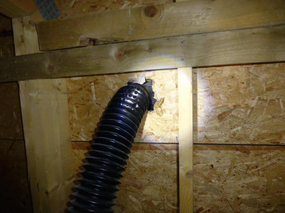

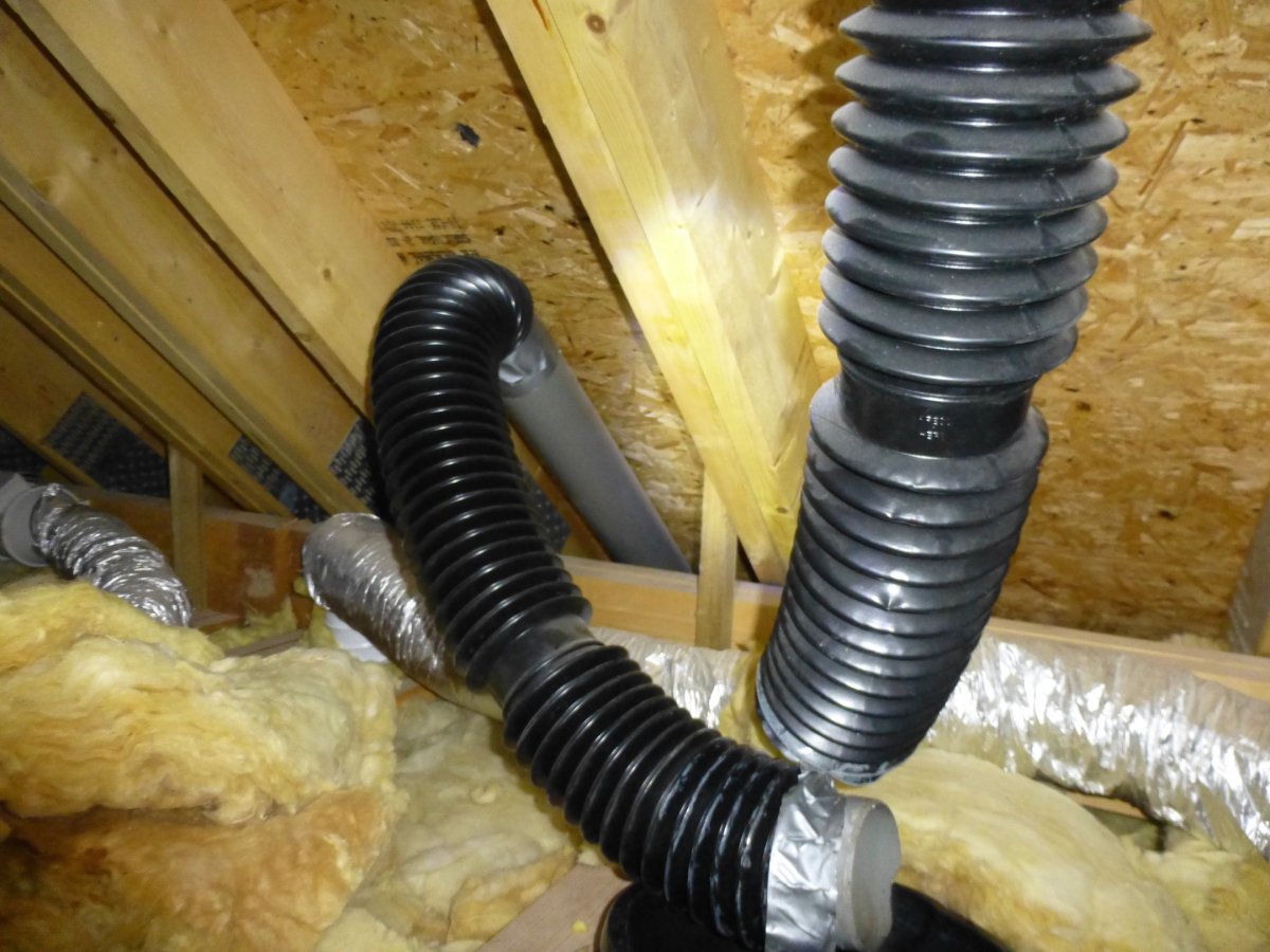

A damp patch on an upstairs bathroom ceiling took me into the loft - I found the source of the leak was a dripping flexible pipe that connects the soil pipe to a vent in the roof.

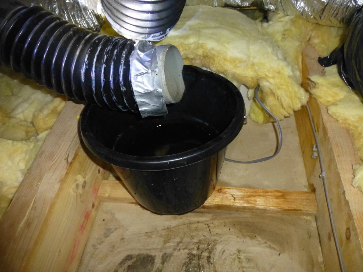

The outside of the pipe was dry - but inside contained about 2 litres of water which had collected in the U-shape dip in the flexible pipe.

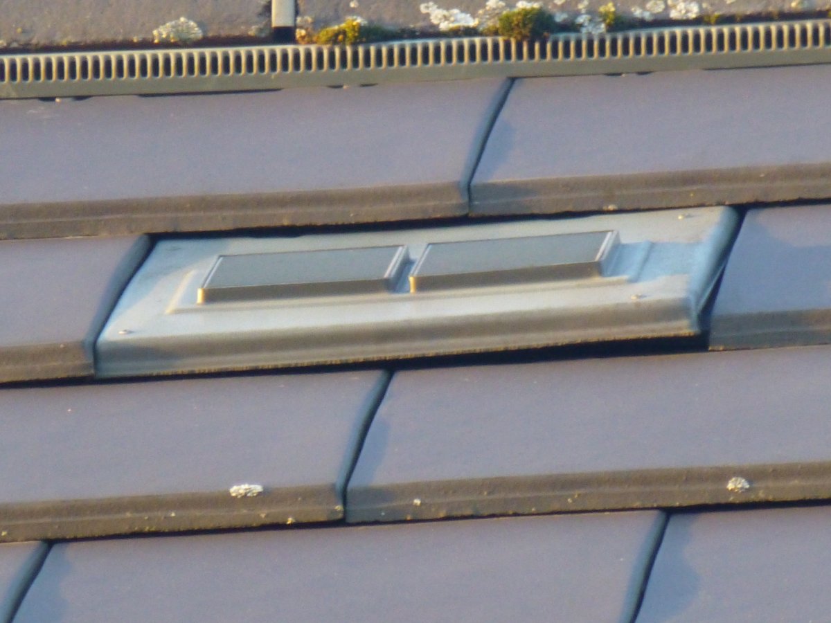

I assume this must be rainwater - but how has so much got in there - does this suggest a problem with the vent tile? The house is 8 years old and I suspect this has been happening for several years.
Also, is this installation correct - long dangling U-shaped flexible pipe taped up like this?
I am looking for advice on how to stop the water entering the pipe and how the installation should be done properly, maybe to stop water collecting like this? Photos attached. Thanks for any advice!

That looks like an extractor vent - I would suspect that the water in the pipework is condensation rather than external water ingress.
Ideally no dip in the duct or a condensate drain off point needs to be fitted.
Shorten the duct so that it doesn't have a low point in it where water can collect

It's possible to get condensation in a soil vent pipe and equally possible that a tile vent can leak.
If you want to eliminate the leak coming from the the roof then leave the section of flexible ducting disconnected and put the section attached to the tile vent in a bucket, wait for heavy rain and take another look.

If that's a soil vent pipe then it's been bodged with tape, it should be properly clipped without dips or the grey soil pipe taken through the roof & weathered/terminated properly.
If you have hot water entering the soil pipe (bath/shower/basin etc) then steam could travel up the pipe and condense in the dip located in a cold attic over time.
Thanks for all the replies. After some more investigation definitely the soil pipe, and definitely condensation not leaking vent tile. Added an extra section of 4" pipe and removed the bodged together flexible sections so now no dips. Hopefully no more leaks as well...
