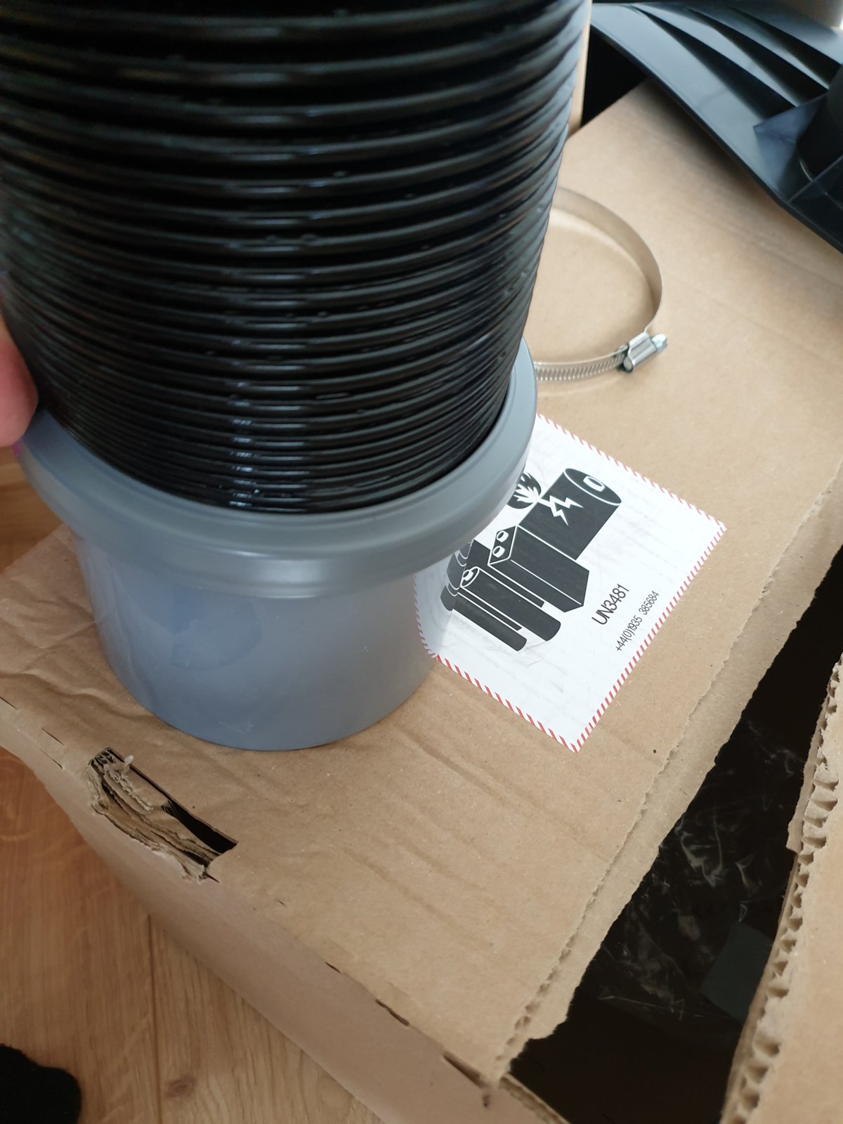

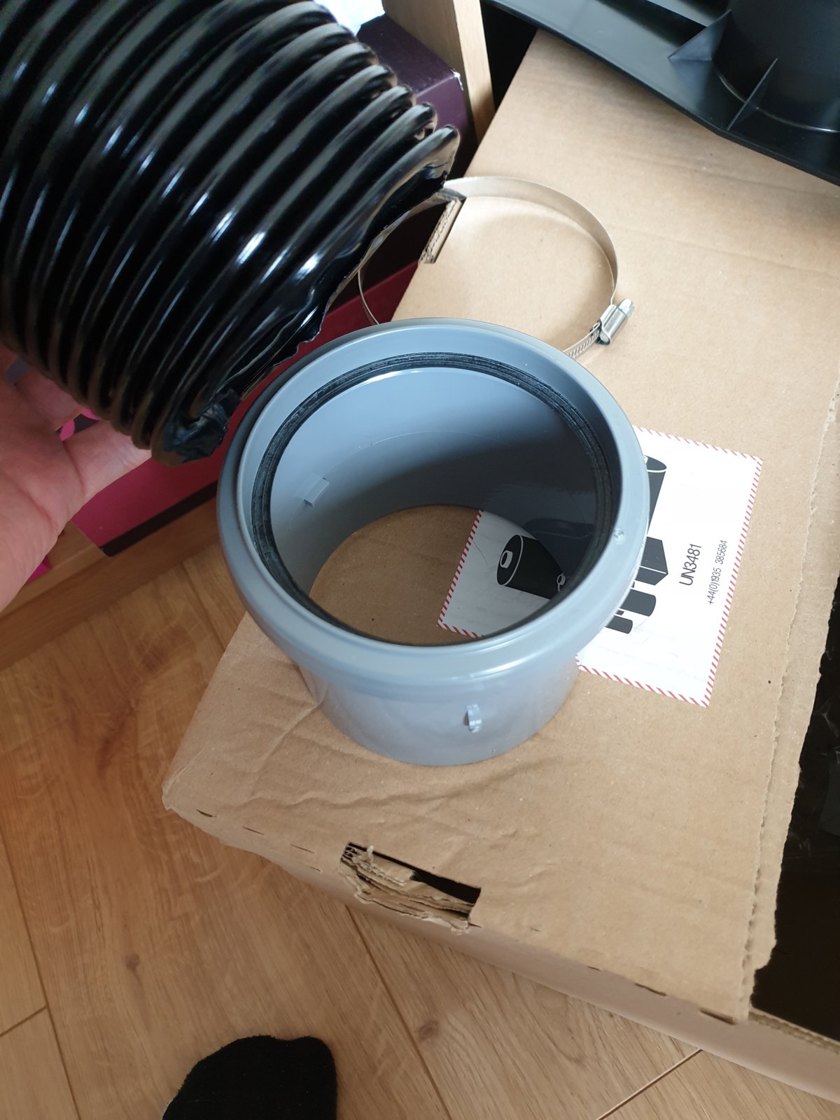

To do this I was going to connect a 1m pipe to an adjustable bend pipe ( https://www.screwfix.com/p/floplast-sp560-0-90-adjustable-bend-grey/50087) to connect to the existing roof vent pipe. This part should work fine.
The final part is what I'm unsure about. I then need to connect the wider end of the 1m pipe to the also wide end of the top of the existing vertical soil vent pipe.
I was planning to connect the 2 wide ends using this flexipipe ( https://www.screwfix.com/p/flexipipe-pipe-110mm/76775 ).
The problem is this flexipipe is too narrow to slip over these wider pipe ends. See photo examples using a pipe connector of the same width.
Are there some kind of pipe connectors/reducers that I can use to securely fit this flexipipe to wider pipe ends?

That flexipipe @ 110mm is the same o/d as soil pipe . In your pic. would the flexi go in if you pulled out the rubber ring in the socket ? If so you could remove the ring seal, cover the flexi outside with neutral curing silicone, and push it into the socket. Then leave it for the silicone to go off. Then the other end of the socket can be glued using solvent weld pipe glue - onto the soil pipe. If the pipe connectors are in situ with the wide ends, do the same with the rubber rings and so on.

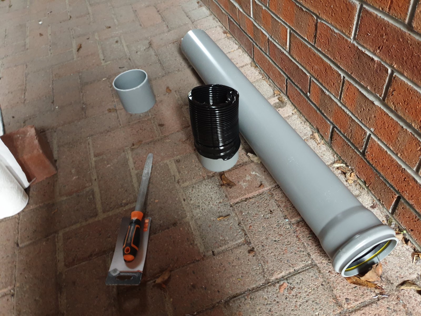

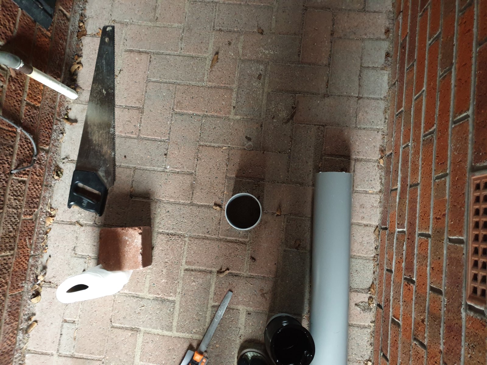

I think I've come up with a solution if I cut 2 small (10cm in length each) narrow (110mm) sections from that 1m pipe.
If I file these at each of the cut ends it gives me some narrow connectors to join everything together:
- connect 90 degree bend pipe directly into existing roof vent pipe
- insert cut down 80cm pipe into this bend leaving the wide (uncut) end unconnected.
- Then insert 1 of the cut pipe connectors into that wide end of pipe with the flexi pipe attached to the other end of the connector
- the final cut pipe connector can then be connected into the other end of the flexipipe and the wide end of the soil vent pipe.
Using jubilee clips to secure both ends of the flexipipe and the rest should be push fit connection.
The pic shows me putting this into progress before going up into the loft.
Still need to file some of the cut ends.
Surely this will work fine?

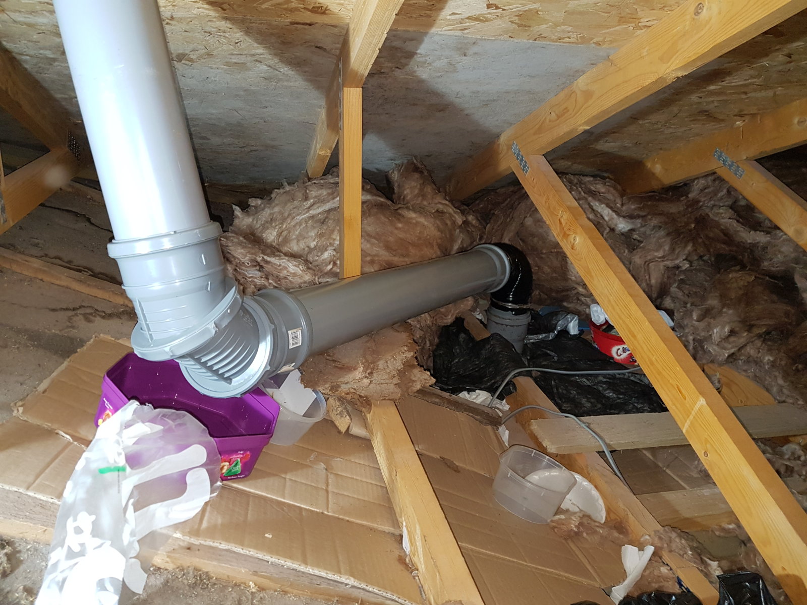

That's me fitted it now (see photo).
Everything connected well except for the final cut pipe end (attached to the flexipipe) connected into the soil vent pipe.
This fits in and fills the soil vent pipe hole well enough but it's less secure than all the other connections. You could easily pull it out without much effort. It's just sitting in there. Although it should stay in place with gravity.
The pipe also runs more horizontal than I was expecting.
Is it safe to assume that both of these issues should not cause any problems further down the line given that there should only be limited moisture in there anyway?
I think I'll apply some tape Self-Amalgamating Rubber Tape to seal the cut pipe end and soil vent pipe to be on the safe side
