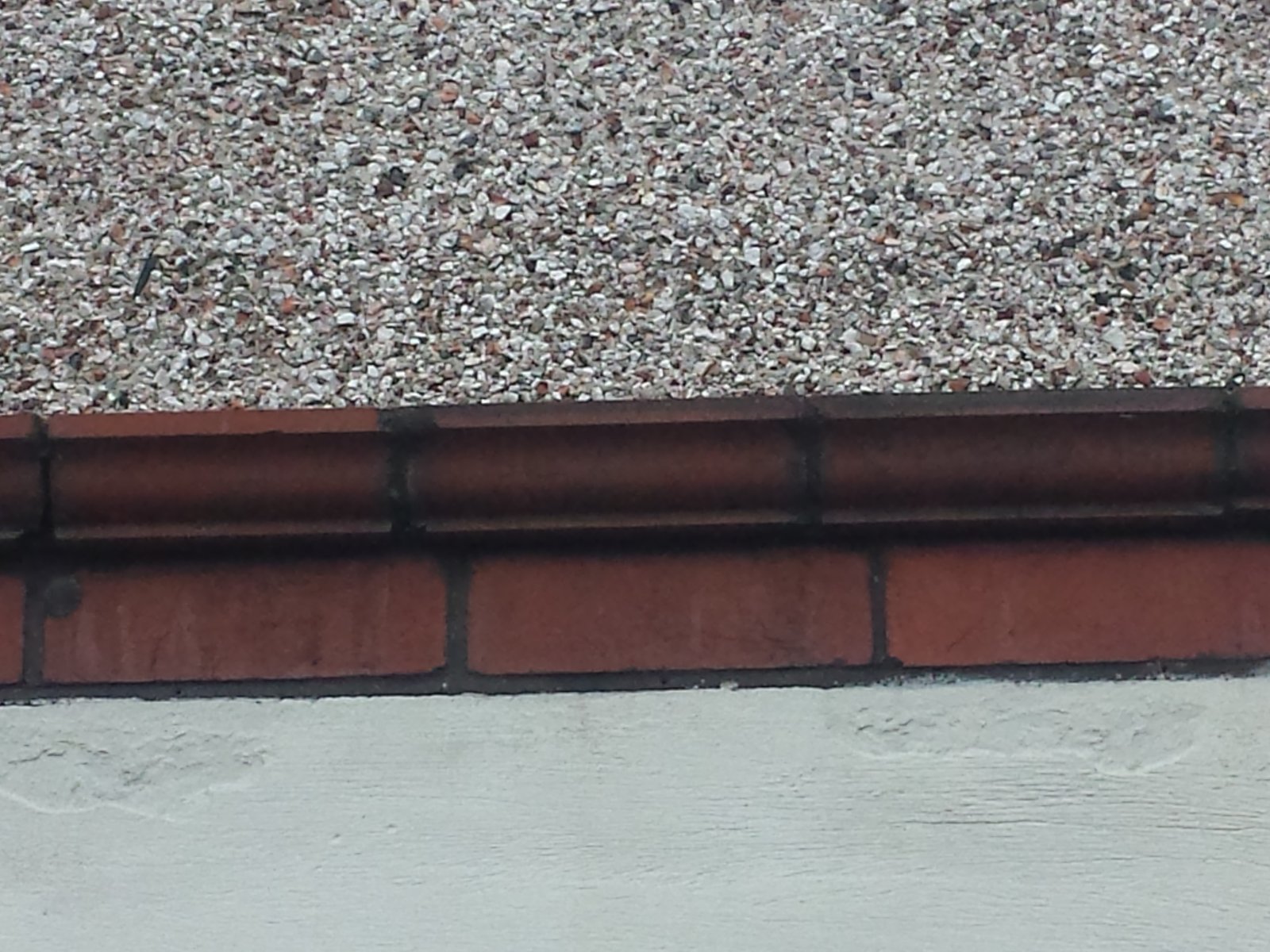

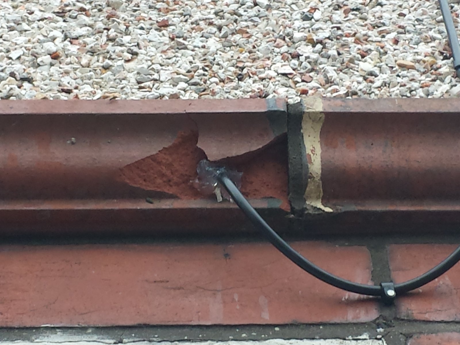

Hi people,
Had Openreach install a new line but the idiot who installed it, despite being told to lay the cable along a ledge went and pushed right through it from the inside out and ended up blowing a brick. Their people sent out someone to inspect it, while I was at work, and they have rang to say it would be hard to replace so they are going to repair it using the brick doctor and that 'you won't notice it had ever been damaged'.
A bit concerned about this as I think it should be replaced. So questions:
Is this a valid method of repair or should it really be replaced?
Would this brick be really that hard to replace from a reclamation yard?
Had trouble describing what the installation guy had done - is there a special term for this 'ledge' ?

What a stupid place to drill a hole.
A repair, done properly, may well be less obtrusive than a replacement. Perhaps a brick surgeon may be better than a doctor.
I'd have that cable relocated as part of the operation.

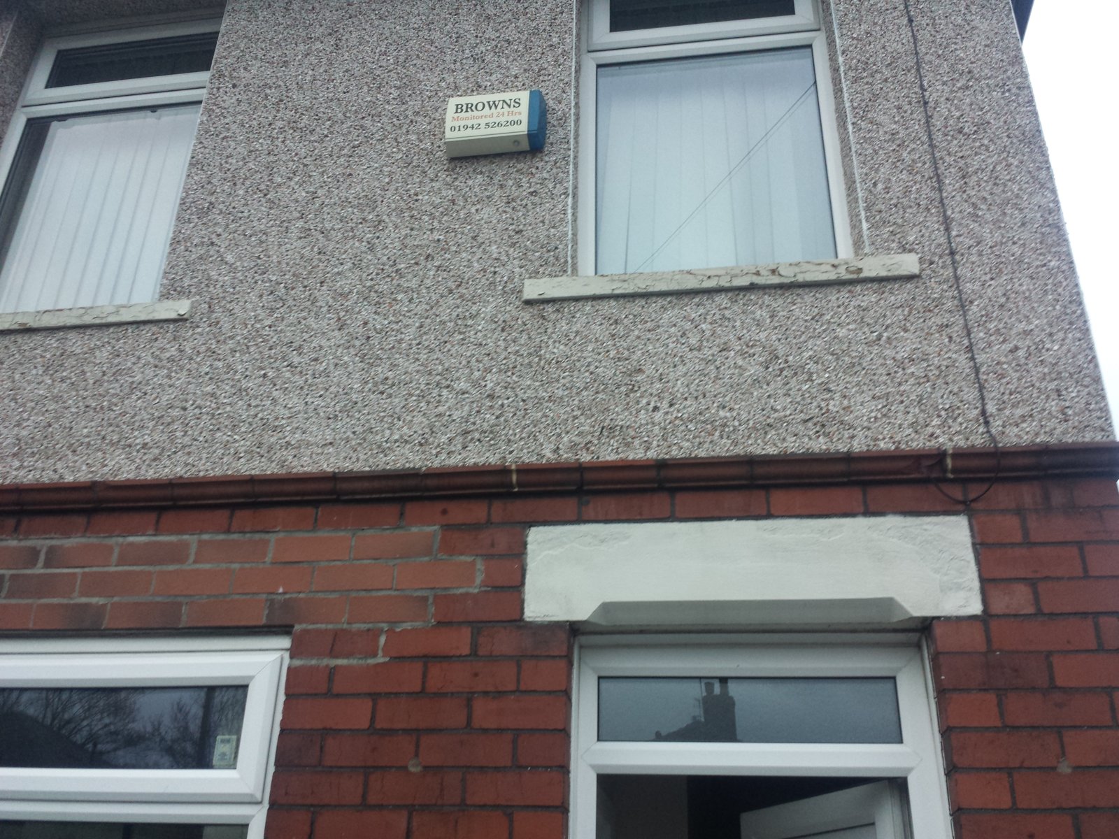

Don't worry once they've done the repair it'll probably blend in as well as the repair job done above the window.

If it is 'The Brick Doctor ' he will do a good repair. My house was built with bricks which had fissures as a sort of feature but I thought some were a bit deep and could collect water which could freeze and spall off the face. The housebuilder sent The Brick Doctor and he did an excellent job I thought. He repaired blending in with the bricks. If you have just one brick damaged just let them repair it.
ps I see now it is a shaped string course that is damaged (couldn't have picked a worse place to drill through !) Brick Doctor should be able to fix it.

I would just like to say thank you all for your replies. I think I'll let the brick doctor have a go.
'...it'll probably blend in as well as the repair job done above the window....'
I know :( when the window guys did it I was assured the dye would last for 'a long while'. Well I suppose if you are waiting for a bus, then nearly 3 years is quite a while, on the other hand if you are granite..not so much. Hoping to tap the brick doctor guys while they are here to see what they can do, so if they can, I guess every cloud, etc, etc.

Black dye does turn grey quite quickly, so you need to make sure the colour is much darker than the existing to start with. Even if it stays a bit darker than the existing it shows up less than when it's lighter.
I avoid mortar dye like the plague.
We tend to blend different types of sand to achieve the colour we need.
I would've loved that to happen at the start but was assured that not only was it costly but hard to source with the mortar/cement being part mixed ash or something
