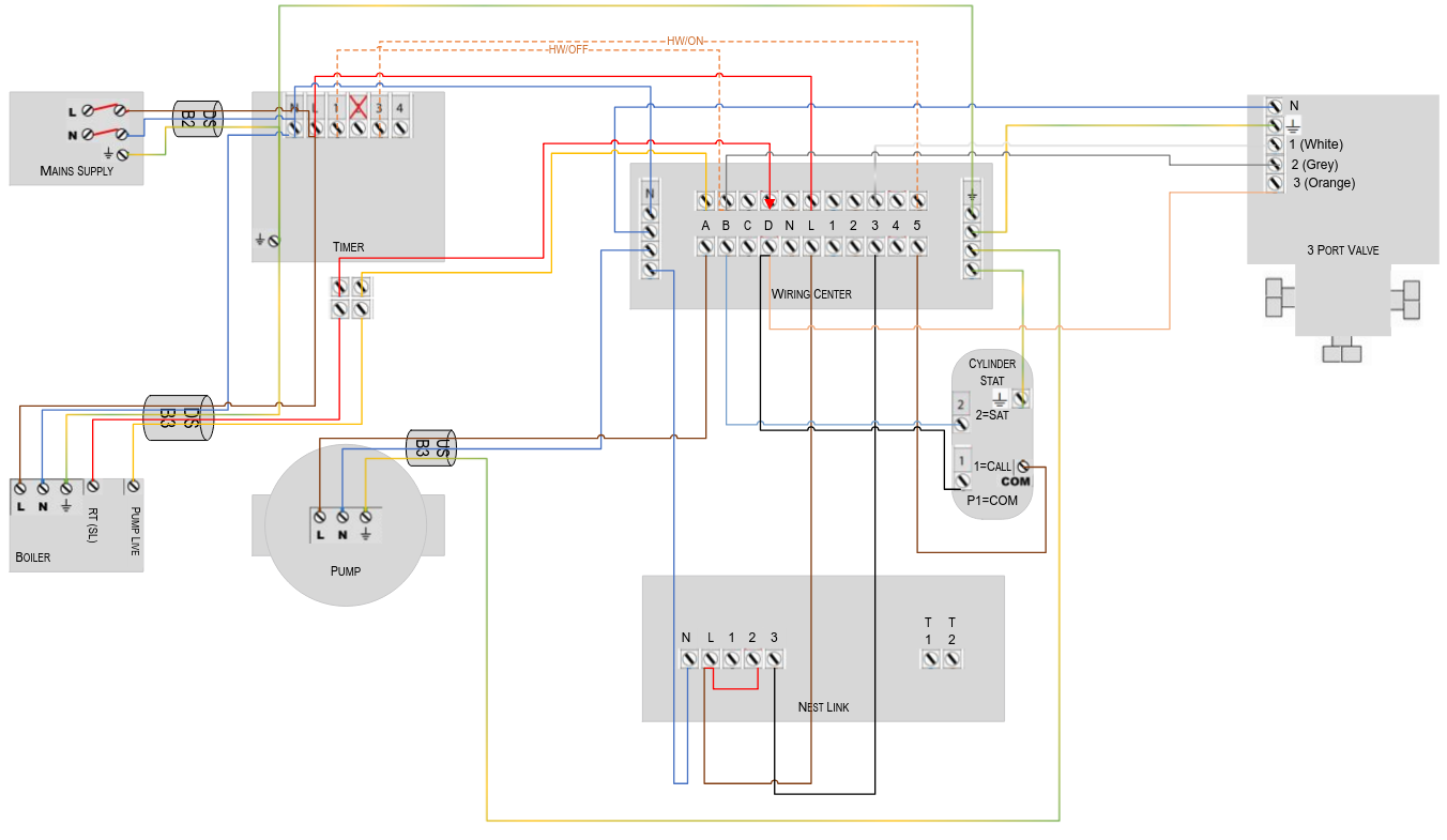

Hi all,
I'm wondering if someone can validate my wiring plan for my Nest + Vaillant Ecotec Plus boiler. It's an early Gen1 nest so only does the heating. The boiler is new and the installers were confused by the older Nest so at the moment the Heating and Hot Water both have to be on all the time and I'm reliant on the cylinder thermostat for sensing when there is no hot water demand.

- Boiler - Vaillant Ecotec Plus 415
- Programmer - Drayton LP522
- Valve - Honeywell V4073A
- Cylinder Thermostat - PT100
- Central Heating Thermostat - Nest Gen 1 (Heat Only)
- Pump - Grundfos Alpha2 L
Let me know if there is anything that's useful to know.
