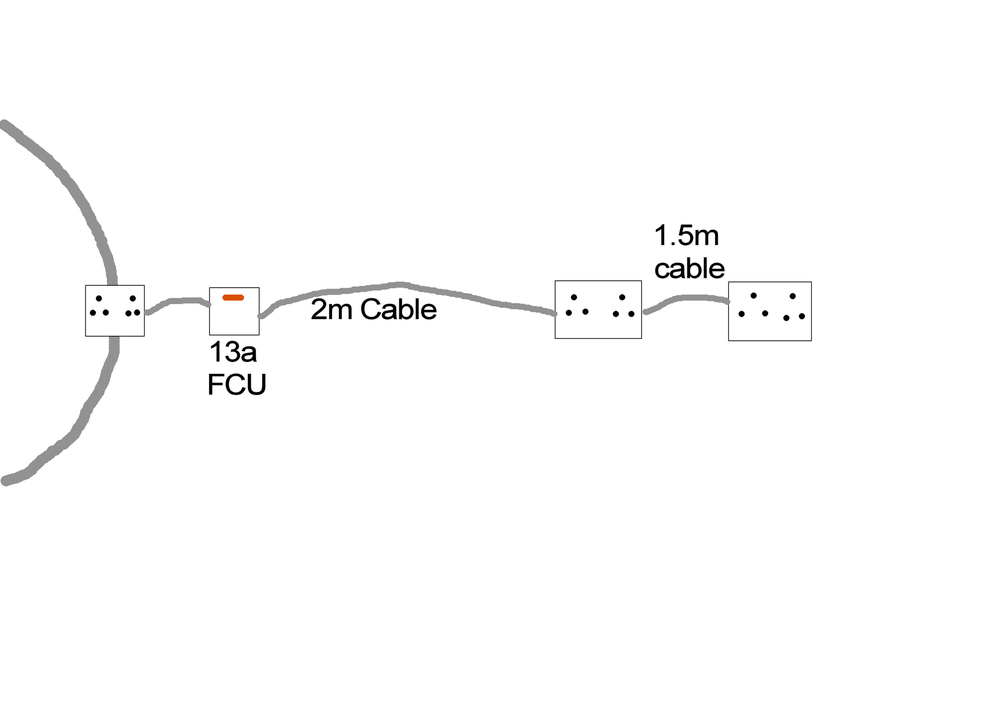

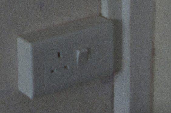

We were recently quoted by three electricians £370-£470 for doing this and sadly we don't have the money and it's somewhat urgent (see additional information).
I have spoken to my uncle who used to do a lot of DIY when it comes to electrical work and while I trust him i just wanted to run it by a few more people.
I'd like to run a fused (13a) spur from the main ring, and add two double plugs a few meters between each other. Here is a very amateurish diagram.
The double plugs sit on the wall. The wire from the spur etc will be in conduit/trunking.
Questions:
1: Is it okay to run a single wire from the first (main ring) double socket to the fused amp? I've read it's safe but many prefer to just add the Fuse to the main ring. The wires behind the double plug aren't long enough to stretch to add to the ring. Is daisy chaining okay?
2: Is it okay to daisy chain The cable coming FROM the FCU to the two new double plugs?
3: Does this diagram look okay? I'm not asking for critic on my 'art' lol.
4: Is 2.5 mm² Twin and Earth (6242Y) cable the correct cable to use?
Additional info:
I am not trying to trauma dump just explaining why it's 'urgent' and we can't afford that money. We moved into the house about 2 years ago and my wife became ill. We were told it would take about 2-3 years to recover. Sadly, last week we were told it's terminal and she has about a year left. Maybe 18 months. I've had to give up work and i'm on U.C and £400 is just not possible.
The room these plugs are going in used to be our 'gaming' room but will become her bedroom as it's on the ground floor near a bathroom. Sadly the room has one plug and we need at least three.
Questions:
Additional info:
