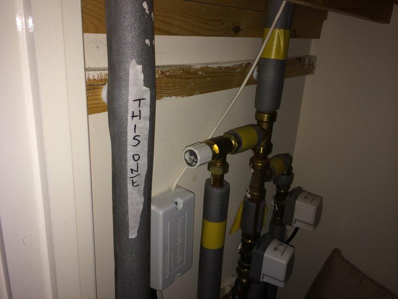

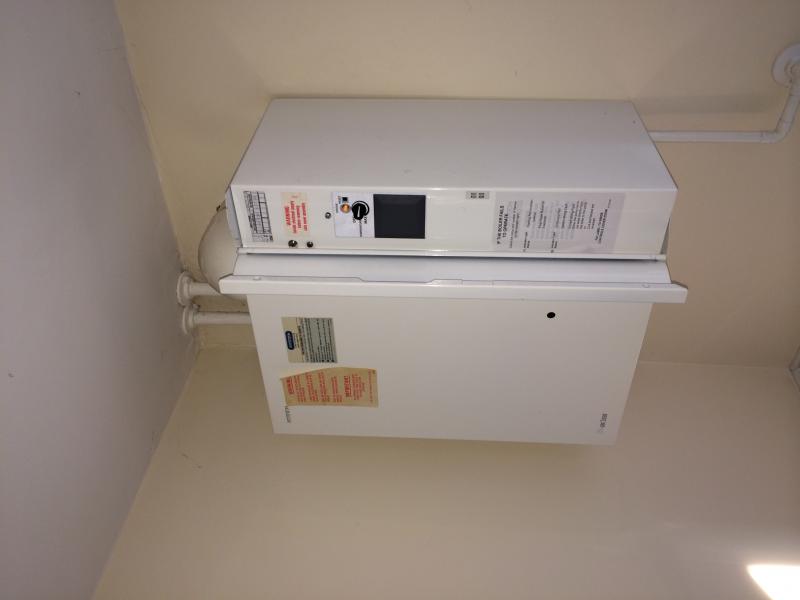

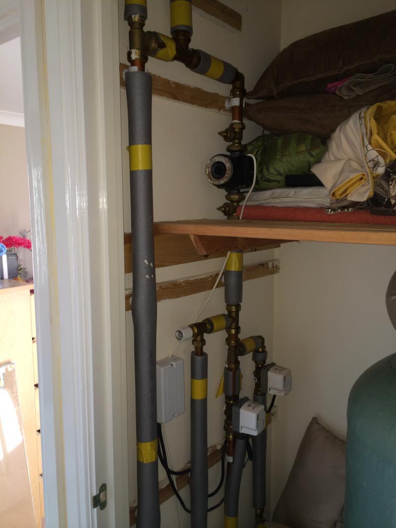

I'm now going to drain the system completely and put in Sentinel X100 plus I want to fit a Magnaclean, problem is I've read the best place to fit would be the return to the boiler, but as you can see from the pics the pipes are in the wall, so would it be OK to fit to another visible pipe in the airing cupboard ?
I've taken pics of the airing cupboard plus the boiler, I'd really appreciate any advice as to which pipe to fit too as I really haven't got a clue, also is the maganclean the best option to go for ? And can anyone suggest the best/cheapest place to buy from ?

Put it on the pipe far left in the airing cupboard. This is the flow pipe from the boiler. Its not as good as fitting on the return pipe to the boiler but you dont have that option. Plus the carp will allready be in your boiler so the positioning is not going to make a lot of difference in your case. Empty it regularly and it should help a lot. However its never going to do the job of a proper powerflush if your system is badly sludged up :wink:
Dont fit a magnaclean on the far left pipe. The magnaclean comes with iso valves which are not allowed in that pipe, put it in the pipe on the right, next to the pump.
Thanks for the quick reply, the pipe you said to install to on the far left is a larger diameter, the pipe which is third over from the far left I think is 22mm and would be long enough to fit the unit too, would the third from the left be OK to install too ? as they seem to come in 22mm standard ? I just put the boiler on to heat the water and the pipe you said far left is hot and the 3rd over from the left is also hot ...

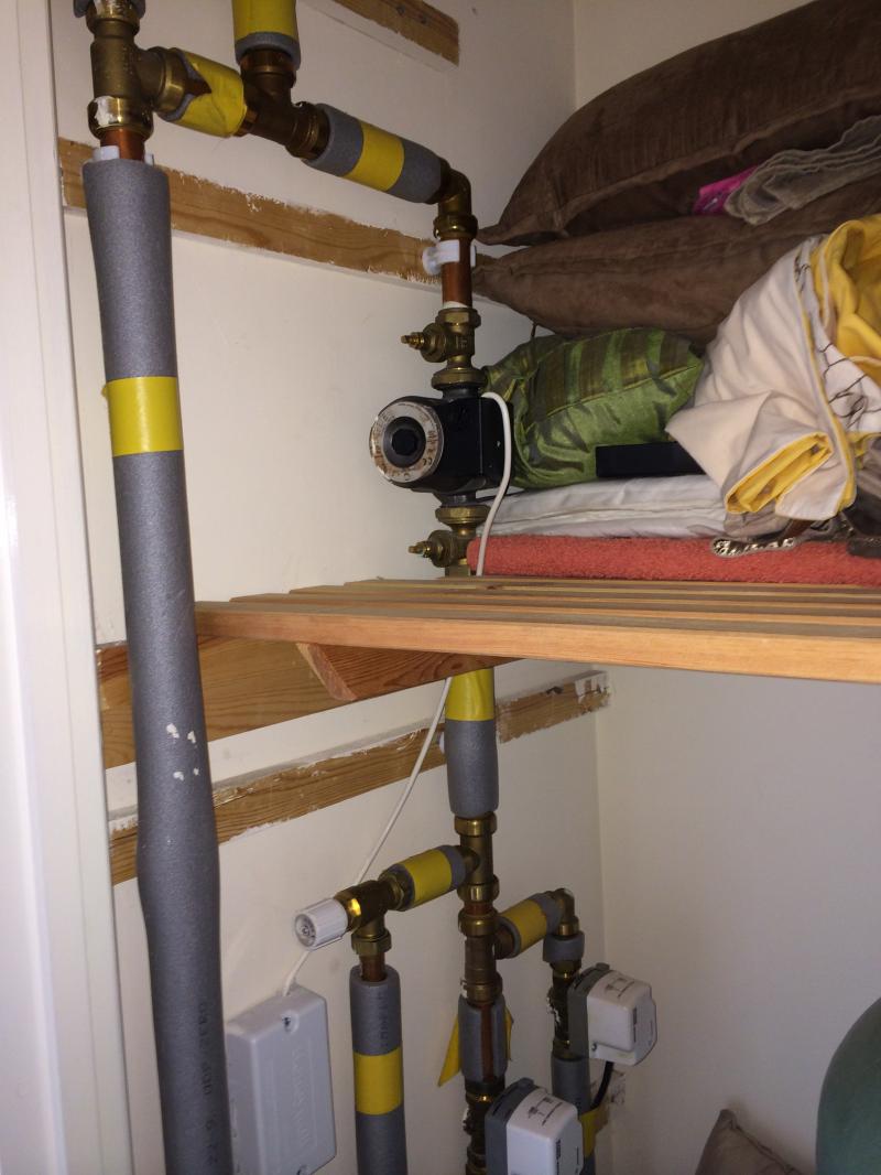

I've taken pics of the pipe I'm looking to install it too just to make sure that would be OK (third from the left), just above where I'm looking to install it it has a Myson power extra unit so unsure if this would affect anything and make it unsuitable to install the filter in this pipe ?
Also would the FERNOX TOTAL FILTER TF1 be just as good ? As this seems to be cheaper and does the same thing, don't want to install to the 3rd from the left which seems to be 22mm dia if this is going to do nothing to help my cause....
Thanks TWGAS, so would I be OK to fit it to the pipe which would be the down pipe from the pump which would be below the MYSON unit, there are 2 Myson fitted one on the far right and one on the left, so I would like to fit to the pipe below the Myson on the left, also would this pipe be 22mm dia can't see any way of seeing the size of the pipe ?
If you extend the pink square down, on that same pipe is the Myson unit, can I install just below that Myson unit as there is a long length of pipe below the Myson and would be the easiest place to install ?

Apologies. My bad :oops: twgas is absolutely right. It needs to be installed after the feed and vent pipes on your system as it is an s plan system. It looks like you have enough room under the pump for it. But you may need to chop the shelf a little.
Not a great idea to install it after the mororised valve as you are suggesting. But from looking at the pics the motorised valve you are thinking of installing the magnaclean under is serving the heating. So it will still be fairly effective.

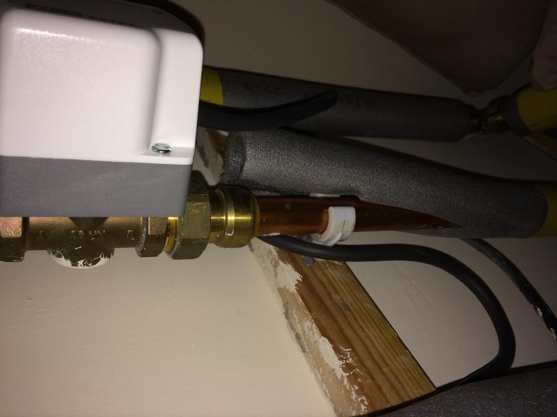

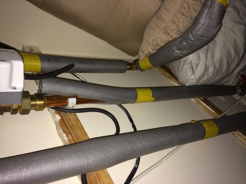

The pipe under the pump is 7" looking at the installation this would not be enough as it says to cut 195mm out in order to fit the filter
This is why I wanted to place under the Myson in the same length of pipe as it's long enough, but based on what you said this is a No No ?
If you dont have enough room under the pump then putting it under the motorised valve for the heating is your next best option. But with a slight bit of repiping you should be able to fit it after the pump. But before the valves. :wink:

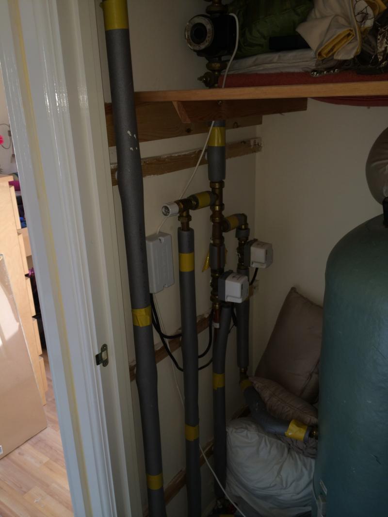

looks like the MB3 will fit and the Magnaclean pro2 if I cut the shelf, what would the dia be of that pipe that I need to fit it too just below the pump as it's definitely a larger diameter pipe than the one below the Myson, just don't want to get one drain and then cut the pipe and it doesn't fit, now that would be a nightmare...
Can't see any marking's saying the dia of the pipe anywhere....
