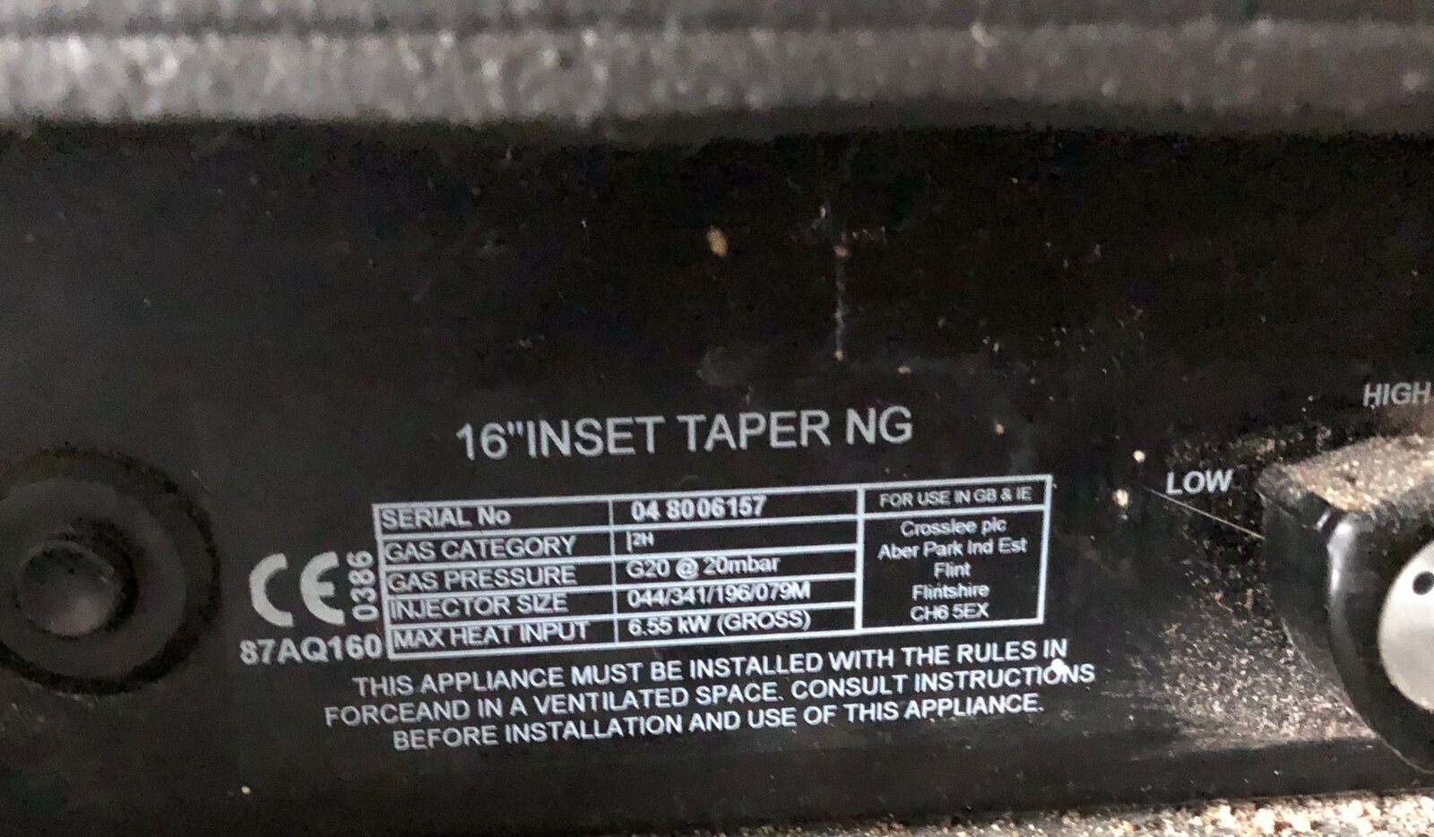

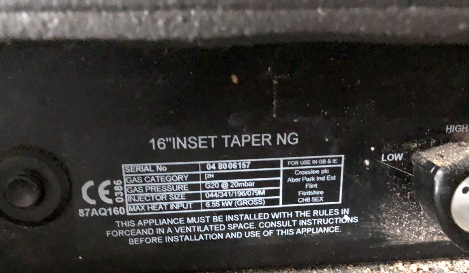

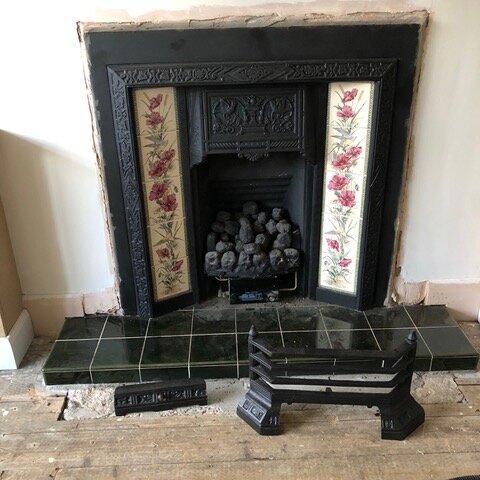

Hi,
I'm looking for advice on a fireplace we have inherited, we organised a service and the engineer said ventilation was a required, transpires this has been blocked up since 2005.
We had a copy of the last gas service completed by the previous owner on which 'Ventilation' was marked as pass. The engineer was not impressed and said if they had inspected the vent they would have seen it was blocked...
I contacted the company who did the orginal certificate and raised my concerns they arrived in 5 minutes unexpectedly! They were not happy with the suggestion from the other engineer and stated an air brick wasn't needed as there is adventitious air, they changed their minds after I was unable to produce the MI booklet and therefore said the vent needs opening.
I have tried finding the manual for this fire Crosslee Royal CozyFire 16" Inset Taper with no luck, nothing on the web.
Guidelines are confusing and suggest an open flue fire under 7kw MAY need additional venting depending on spillage test results, but exact requirements will be indicated by the MI so I suspect they have erred on the side of caution.
What do I do? I love the original fire but this vent is ridiculous, I live by the coast and the vent is just not acceptable.
I'm due to get a carpet fitted soon and wondered if a spillage test could be requested and if passed therefore satisfying the need to not need this vent.
I find this all rather odd as I can't believe since 2005 the fire hasn't been used once... if only I could find the manual!

the vent could be a life saver. If there is inadequate ventilation then :-
(1) the oxygen supply to the fire will be inadequate to ensure full combustion of the gas. Result is higher levels of carbon monoxide which can kill.
(2) the flow of combustion products up and out of the chimney requires the room to have enough ventilation to allow that flow to happen
Get a better vent? You can get all sorts now and can usually hide them away somewhere.
I don't think I'd be using it without the MI's anyway.
As long as the fire passes a flue flow, and spillage test, no additional ventilation is required, as the heat input is less than 7kw.

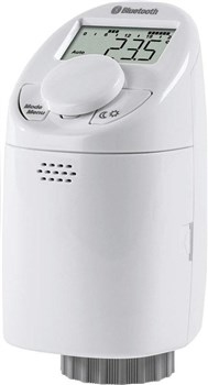

Central heating today has moved on, the first I had although vents could be opened or closed, it heated whole house, no way could living room be turned off, and other rooms very limited controls, today the programmable TRV on water heat transmission allows us to select how much and when each room is heated, these EQ-3 Bluetooth Smart Radiator Thermostat.jpgin 2019 cost me £15 each, clearly not the best TRV head, but today the boiler may be centralised, but each rooms has some independence from others, so we can now heat just one room at a time. And more important without over heating any room, main problem with a fire, be it gas or solid fuel, is no automated control, so rooms end up too hot.

Back in the day we didn't worry too much about ventilation for fossil fuel burners because there was always enough air entering the house around windows and doors etc. These days with hermetically sealed homes a permanent vent is an absolute must for any non room sealed appliance.
With a DFE, no allowance can be made for adventitious ventilation unless specifically mentioned in MI.
And that vent, for a single appliance, must be 100cm2. No fly screens or closability. Do not use the 5cm/Kw calculation.
An inset tray often has the letters “NV” as part of the model name. This means “no vent Reqd”. In the absence of that designation on the data plate, and no MI’s to the contrary, then the minimum is the 100cm2
In the absence of specific M I !00 cm2. Will also need a class 1 flue,
