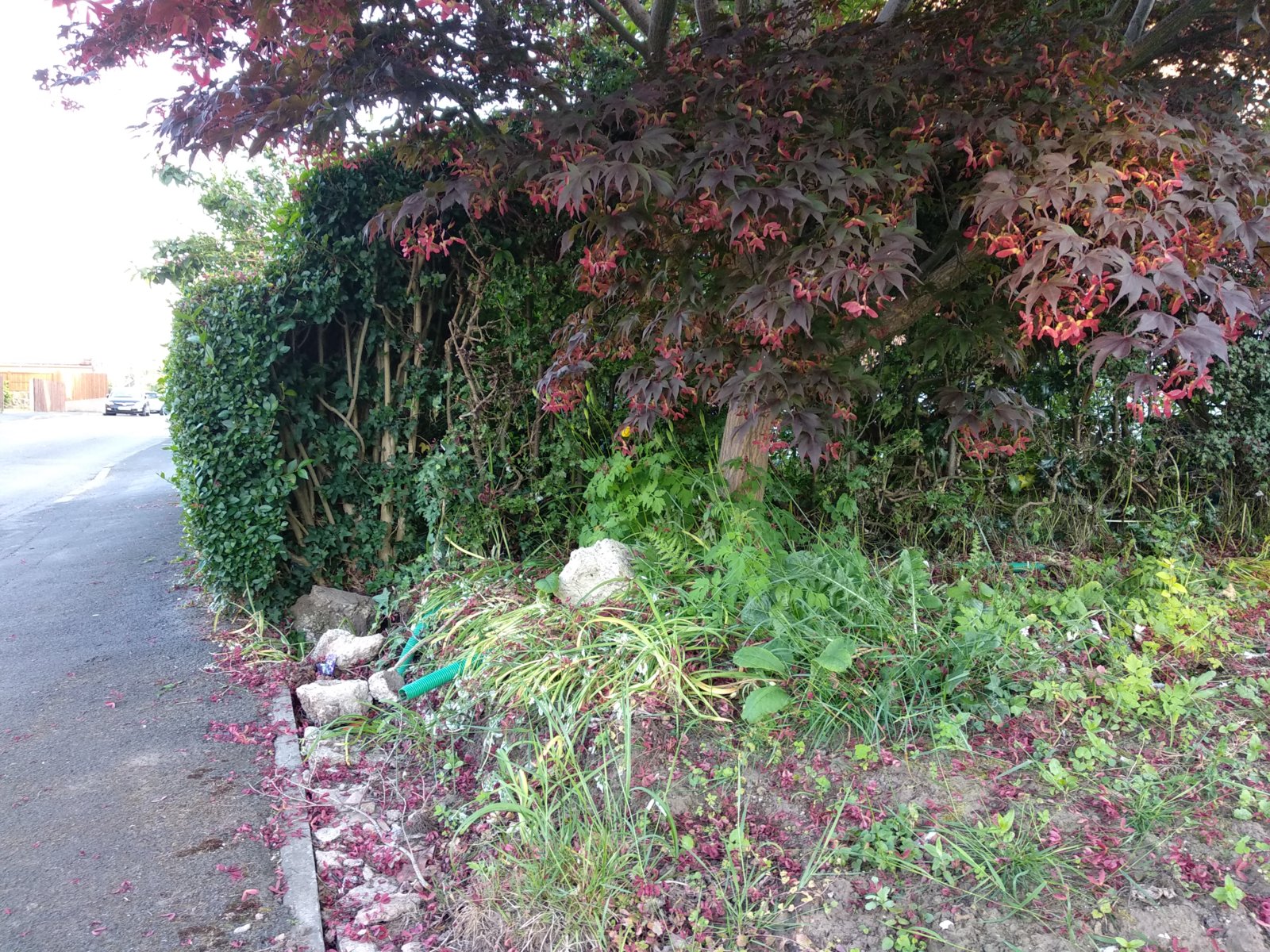

Hello,
We're looking into having a new wall built to the front of the property and have had two quotes so far but I had a few questions I wanted to ask before we went ahead.
The wall will be 8m long double skin at about 1.1m finished height with blues on edge, supported by three 1.6m pillars. There is a relatively big Acer tree (question to come about this) about .7m away (see photo) from where the old wall was.
The existing footings were probably 100mm and were all cracked and broken from when I took the old single skin wall down so these will need to come out and new footings to go in for a double skin wall.
One of the builders suggested a 450mm wide X 800mm deep footing for the new wall with the width around the pillars being larger. Does this depth seem right? They build houses on 1m footings.
With this depth I'm sure that the Acer tree roots will come into play and I'd hate to kill it as it's very nice to look at. Could the footings be made shallower around the tree without any major issues?

Just dug a test pit near the tree, no major roots in the bit that I excavated. The footing will end up being 500mm from the trunk which is about 150mm diameter.
At around a foot down it's red clay, will this affect anything?
Do we need anti heave footings this close to the tree?
You're over-thinking things regarding the tree. Roots wont be a problem, if anything it will be moisture extraction and related soil movement, but in these cases if anything at all it will be relatively minor and even movement not disproportionate and the foundations down slightly in to the clay will deal with this.
800mm deep foundations is nonsense. Does the builder have a clue? 500-600 or just 100mm in ti the clay will be fine and 300 wide will be too.

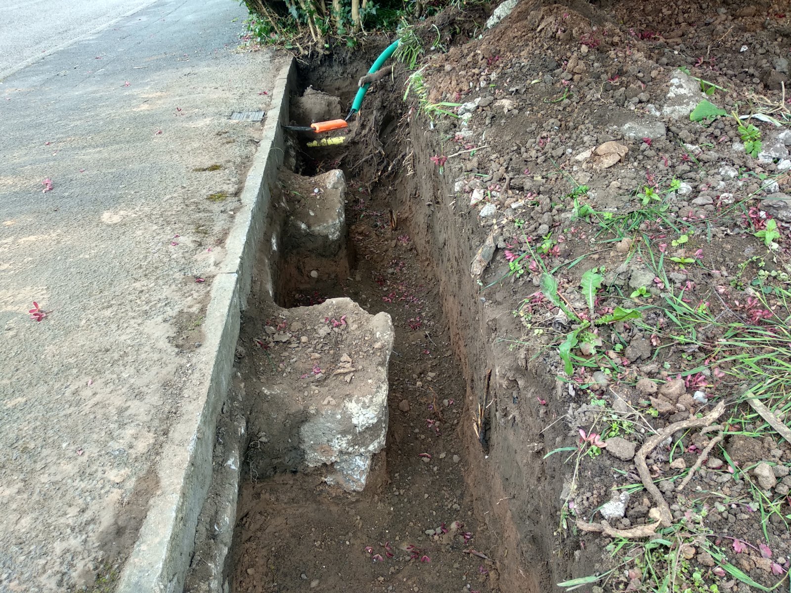

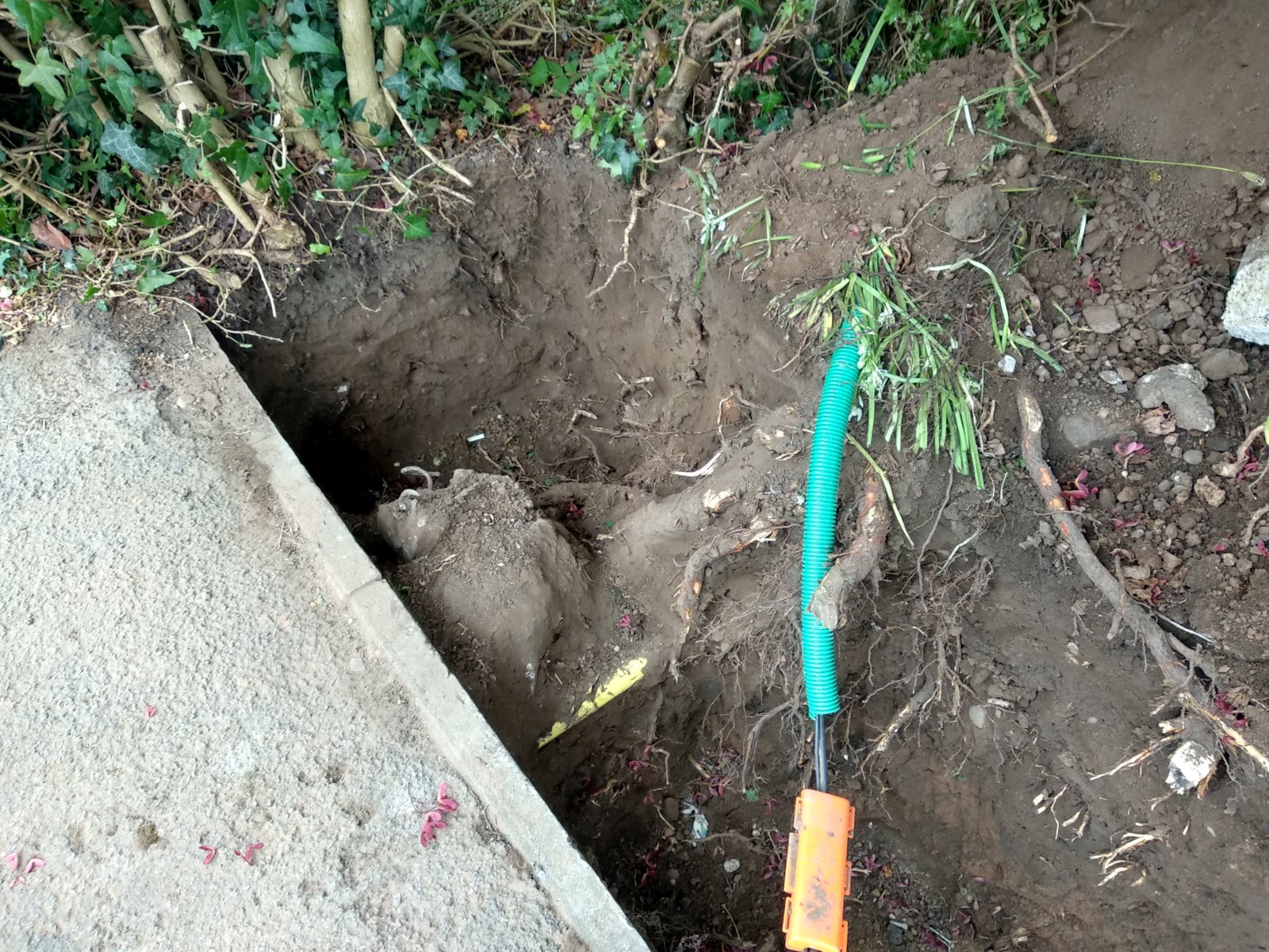

Thanks for the reply Woody, I'm struggling to sleep as this is on my mind.
I'm not sure I understand, from what I've read the footings need to 150mm below for frost protection and he mentioned two or three courses below ground level which would make the concrete depth only 300mm wouldn't it?
He also found some decent sized tree roots from the Acer going under the footing, this slims the concrete down to 250mm at one point.
There are also 4 old concrete posts about 300mm square dotted throughout the footings, they finish about 200mm below ground level. Are these ok to stay in?
Thanks.
A small shallower bit will be weaker but it will just bridge over if the ground is stable. My worry would be your incoming gas and presumably electric supply if present. You need to make sure they aren't concreted in by surrounding with some compressible material.
Thanks for the reply John, I spoke to him this morning and we agreed that we'd cut the posts off flush after some discussion.
We've also made the trench deeper but he didn't think we'd have enough ballast to take us up to the 150mm below mark. We're currently 300mm below with concrete still going in but not alot left.
I've put some thick pipe insulation around the gas pipe as it was worrying me also. The tree roots are pretty much touching it but I think the tree is at full height seeing as it's over 20 years old so hopefully this won't cause issues later.

"Foundations" are the bits of a wall below ground level.
Foundation depth is the distance (depth) of the wall (including any concrete) below ground level.
Foundations may be brickwork or blockwork or may be concrete but are often a combination.
So as long as the builder has dug down to a suitable depth and width, it does not matter if it is concrete or brick or block, or how deep any concrete is. It's the depth of the trench that matters.
Where those roots and cables pass through the trench then they should be bridged over and if possible the concrete foundation strip would pass under them. And a suitable gap each side of the roots left.
