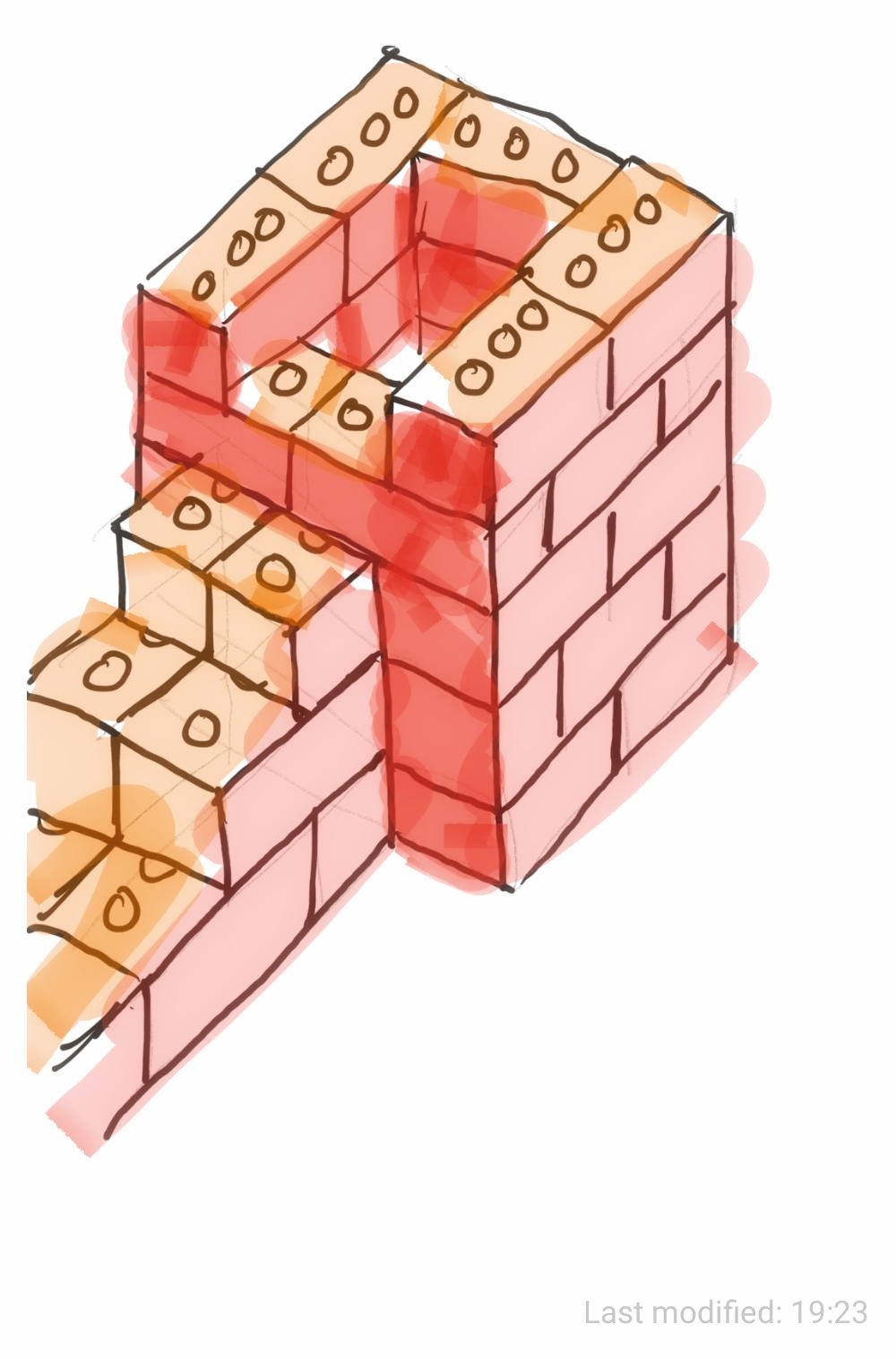

Thanks again for the reply Woody, I'm happy with the depth that they're at but not with how short he was on concrete. I've measured today and we're 225mm on one end and 295mm on the other lower than the pavement.
This means he won't be able to go the entire length in concrete blocks as you'll see them for the last 1.5m as the footings are not quite level.
When I've spoke to him he's suggested cutting the blocks down so that they're under the pavement edgings, but we're talking 60mm at the other end as the house is on a slight hill.
Is this right?
Do you have any diagrams about what you mean with building the walls into the piers?
The builder is an idiot if he did not get the concrete level. Any messing about now should be at his cost not yours, and you don't want to be seeing blocks above the ground.
Bonded pier.

Thanks for the illustration, is it offensive if I send this to him as he hasn't suggested that.

This means he'll be able to do the first two courses in blocks either laid flat or done in the usual fashion. I'm guessing it'll be 2 pairs of blocks at 90 degrees to each other for the pillars? So 4 stacked.
What i would do is build 2 course block right through ignoring pillar for now,then when he sets his brickwork put concrete block in foundation where pillars are, to be honest if any bricklayer can't get this right then i woud'nt trust him doing facework.
