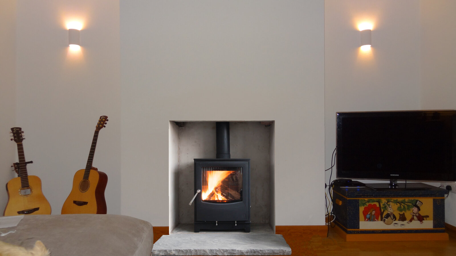

I'm looking to open up a fireplace to have a wood burning stove fitted. My query is regarding using fireboard and how it is finished with the front face plaster wall. See the image (a mock up graphic) for the look we are after. A guy who is putting a quote together for us says it really needs a finishing plate (to cover the front edge of the fireboard), which basically looked like angle iron around the face (if that makes sense) and personally thought it looked naff. What we are after is basically something which looks like it is just plastered. Is this possible?

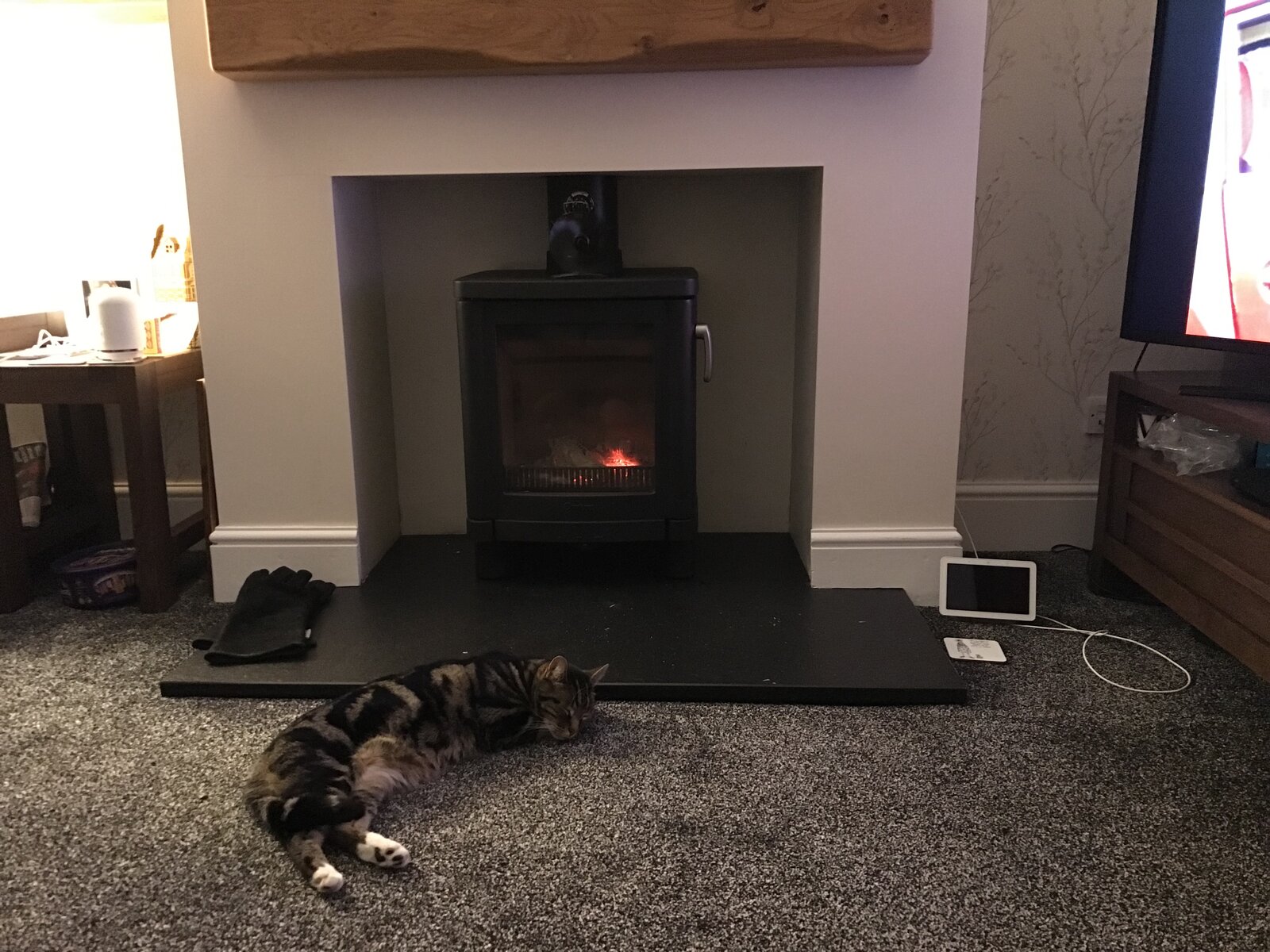

Been like that since 2013 no cracking , fire board inside and plastered on the outside

That's good and looks great, pretty much identical to what we hope to achieve. As a matter of interest what is the distance from the stove to the inner wall? Do you know was it standard plaster or heat resistant such as Vitcas? I just want to get it right first time:-)

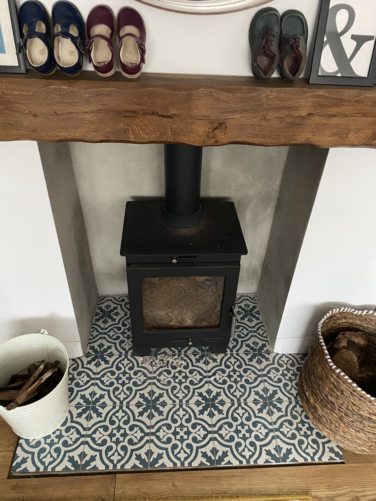

I rendered mine (sand and cement), just another option. Been rock solid since 2016, no cracks, not even hairlines. No need for any fire resistant plaster or board then. You just render to one side of the corner bead and skim the front face.

The inside part was done by the stove fitter , fire board ( cement based I think ) which was just painted and my mate made good with plaster up to this ..

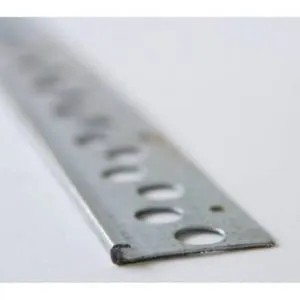

Does he mean a metal edge skim bead
If so, won't be visible when plastered.

He’ll probably be fine if you suggest it, it’s just a subtle difference in how the plastering’s finished off, and needs a very accurate sizing of the cement board, and some attention to detail on the beading, so the exposed board edge is behind a stop bead, and not exposed and needing to be covered by a trim. (As shown totally by @jacko555 pic)
