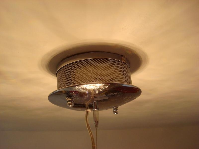

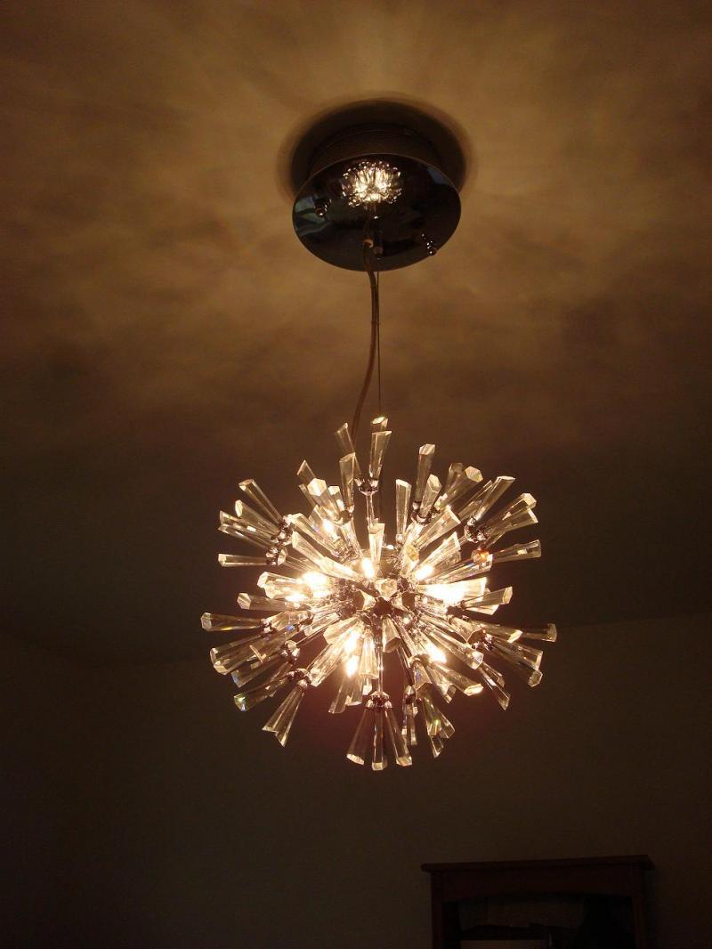

I bought the 15 light pendant chandelier from John Lewis a month or so ago in the sale, but is it now discontinued. It is called "Snezka".
I have uploaded some images of when it is actually on!:
I think a dimmer will help as some of you have suggested and I would like to be able to dim it anyway as it is very bright!.
I am going to try and contact the manufacturer and I am aware I can't use any old dimmer switch, but assuming it is a wire-wound transformer and uses 15 X 20W G4 low voltage bulbs (300W), any ideas on what dimmer switch would be suitable?.

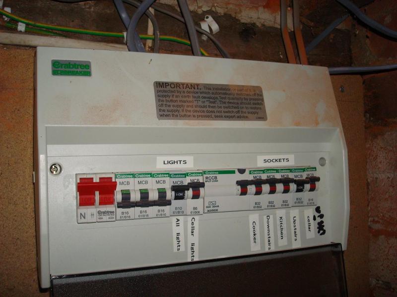

I meant, the brand name and pics of your consumer unit (fusebox) :oops: to see what can be obtained that might not trip at switch-on
Hi JohnD,
Sorry, read your previous post quickly and obviously not properly :oops: .
The consumer unit is a CrabTree StarBreaker.
You can see from the pic the switch labelled "All Lights" is for the upstairs and downstairs lights. I forgot to mention before, there is a seperate circuit only for the cellar lights (so when the other lights trip e.g. when a bulb blows or the chandelier surges), I can see to turn the switch back on.
Thanks,
kixChloe
'mmmm, part no beginning "61" means it is the later type with the "prong" busbar connector.
I don't think there is a fuseholder to fit :(
Just type "B" and "C" MCBs, and type "C" RCBOs
You could *try* connecting it to one of those B16s and see what happens, be sure to change it back though - then you'll know whether the suggestion above would work.
Best to check still with the maker.
What dimmer they recomend and the wattage you need.
Also ask them if you can use 10 watt lamps , or will it affect the transformer.
Something like this maybe
http://www.danlers.co.uk/dimmers/softstarthome.html
These maybe too deep
Or mk intelligent dimmers
http://www.tlc-direct.co.uk/Technical/DataSheets/MK/Logic_Plus_Dimmer.pdf
Not so deep these ones
To dim that , if it is wire wound you will need one suitable for a INDUCTIVE LOAD and if possible " soft start" as well.
They are not cheap though.
As the load is 300 w , I would think one rated at 400w or 500w might be suitable,
Is the existing switch just a normal square single switch or part of a two gang or more.
The problem you may have is the back of the dimmer is big, and your existing wall box may not be deep enough.
You will not know unless someone competent isolates and checks behind the switch.
There are white surface spacers if required but you might not like that idea
or else you will need to chop out and fit a deeper back box.
Your other option but a bit more involved is to remove that big lump of transformer and site a 300va soft start dimmable electronic transformer through the hole.
These tend not to surge as much.
Something like these are 315VA (Like watts)
http://www.modelighting.com/index3.asp?id=503&ion=Transformers&set=2
The chrome light plate will then refix flush to the ceiling and may even look better.
You would then need a dimmer suitable for that transformer type instead,they are generally slimmer than inductive ones.
