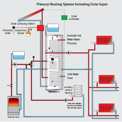

My brother-in-law had a integrated system with LPG, wood burner and solar panels, the idea is simple, Torrent pipe example.PNG but in practice rather complex, there must be room in the water store for the hot water produced, and solar panels and wood burners can't be simply switched off like a oil or LPG boiler, so he had twin large tanks, upstairs so power cut would not stop water circulating, and it did work well, he could go to Germany where his daughters live, and home was maintained while away with solar only.

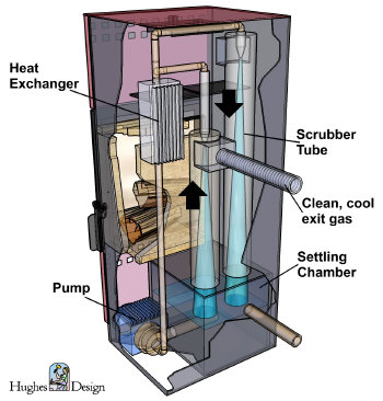

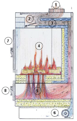

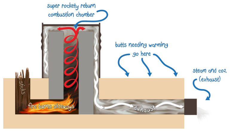

Clearly there is more than cost saving for you, but there is a huge difference between an emergency solid fuel fire, and a fully compliant fire which will not cause particular emissions, the main point is to stop particular emissions the fire needs an after burner of some kind, so flue gases get very hot, some where extra air is fed into the burner, I knew a guy who was very keen on natural forest practice and wanted me to write a website for him, first step was research, and when you look at the units being sold it seems there was a flaw.
Hughes Condensing Stove 2 small.jpg wallnoefer.PNG rocket-mass-heater-diagram.png The first two seem great, until you consider it needs electric, and emails asking what happened in a power cut failed to get a response, the third is the rocket mass heater which is home made, and presents a problem with house insurance. I have lived with solid fuel heating, as a boy in a steel works town we could buy small coke cheap as small stuff no good for steel making, to burn coke means doors on the fire, and the Aga stove had a side boiler, and I have needed to rake out the fire onto a shovel and take it outside when the water supply failed. Also run off hot water when it started to boil. The fires were efficient, but poor installation, there was no ducting to take combustion air from outside, so they caused drafts through the house, and parents used high backed chairs to stop draft hitting them.

As with all uncontrolled heat sources needs carefully design proposed cooker will need heat leak radiator sized according to output. You may well need to consider a buffer tank dependent on size of cooker.
