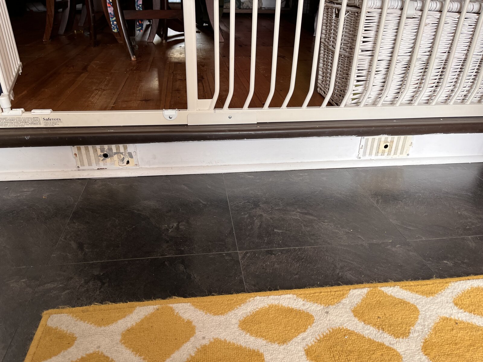

I’ve attached a picture to show where it ends inside the house.
I fully take on board the timber issue and while money is a factor here, it’s a home for life so there is wriggle room for the right solution.
As you can see from picture, it’s not ideal.
Many thanks for any advice
Danny

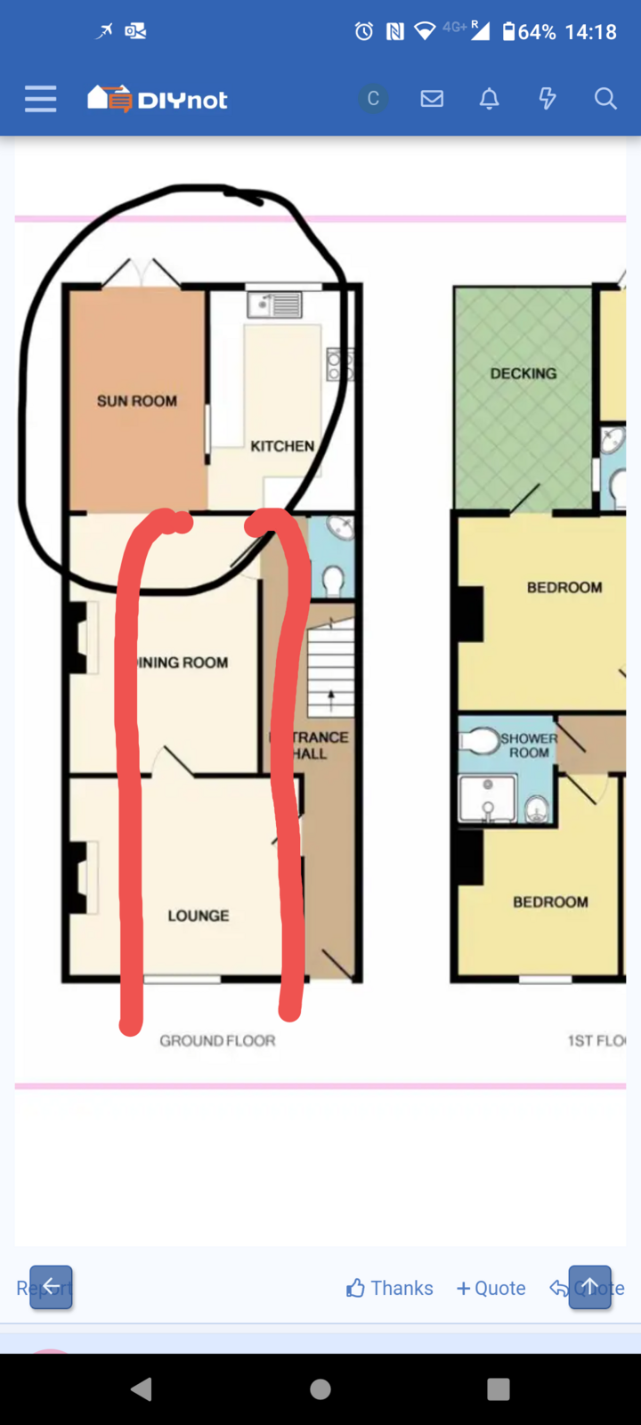

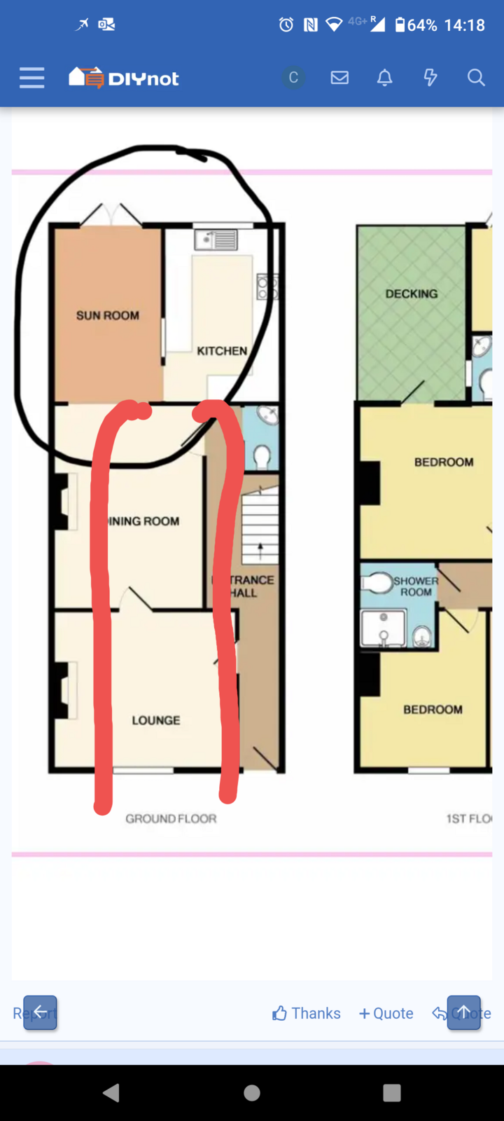

I have a crazy idea, only because I've run air supply pipes (110mm plastic) from front to back of my house for wood burner and gas tumble drier.

So if you can duct to the outside either in the side wall or the roof then you just need some extractors at the front to draw the air through, is the void under the original living and dining room floors restricted do you know?
There would be no point ducting from front to back, as you'd have all vents at the front. It relies on the wind to move air through, which only happens if they're in different places - usually front to back but front to side or roof would be reasonably OK.
That's why special extraction fans were linked to earlier in the thread, to mechanically draw the air through.
