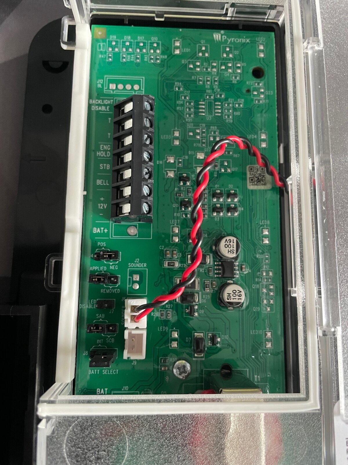

Hi, long story short.
Burgular Alarm kepad is Gardtec 370, the main unit is also a Gardtec 370 but installed on a sperate floor.
The bell box is a new deltabell. The goal is to connect the new deltabell. The old bell was removed years ago and disposed of. The cabling remains in place.

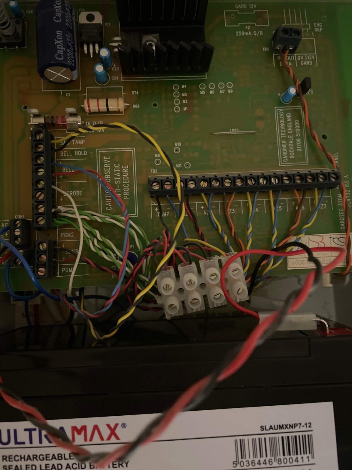

Pic 1 - Main unit wiring
Pic 2 - Keypad Wiring

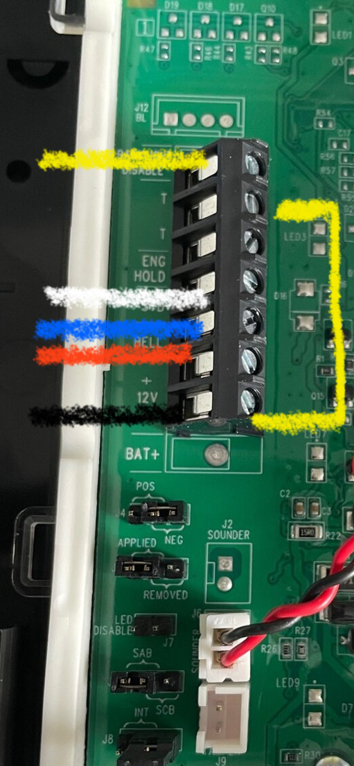

Pic 3 - empty terminals on the new bell box

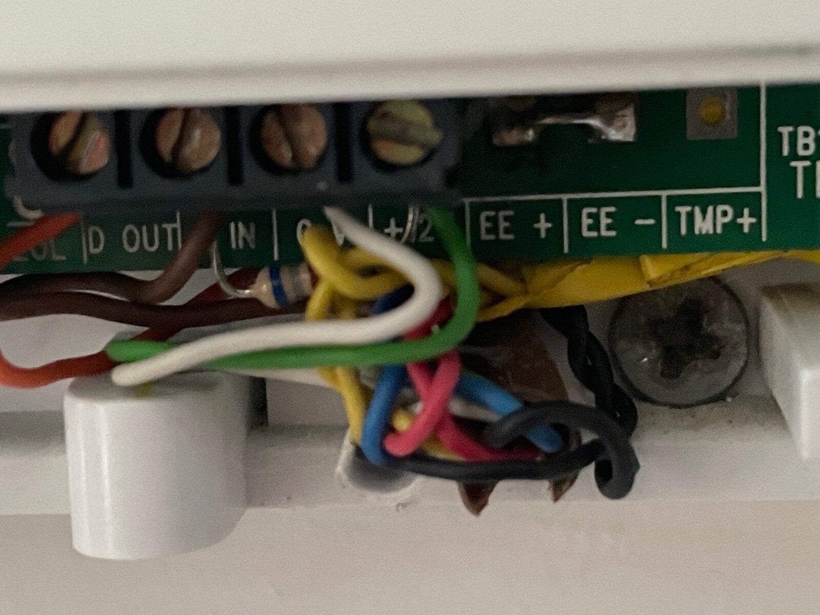

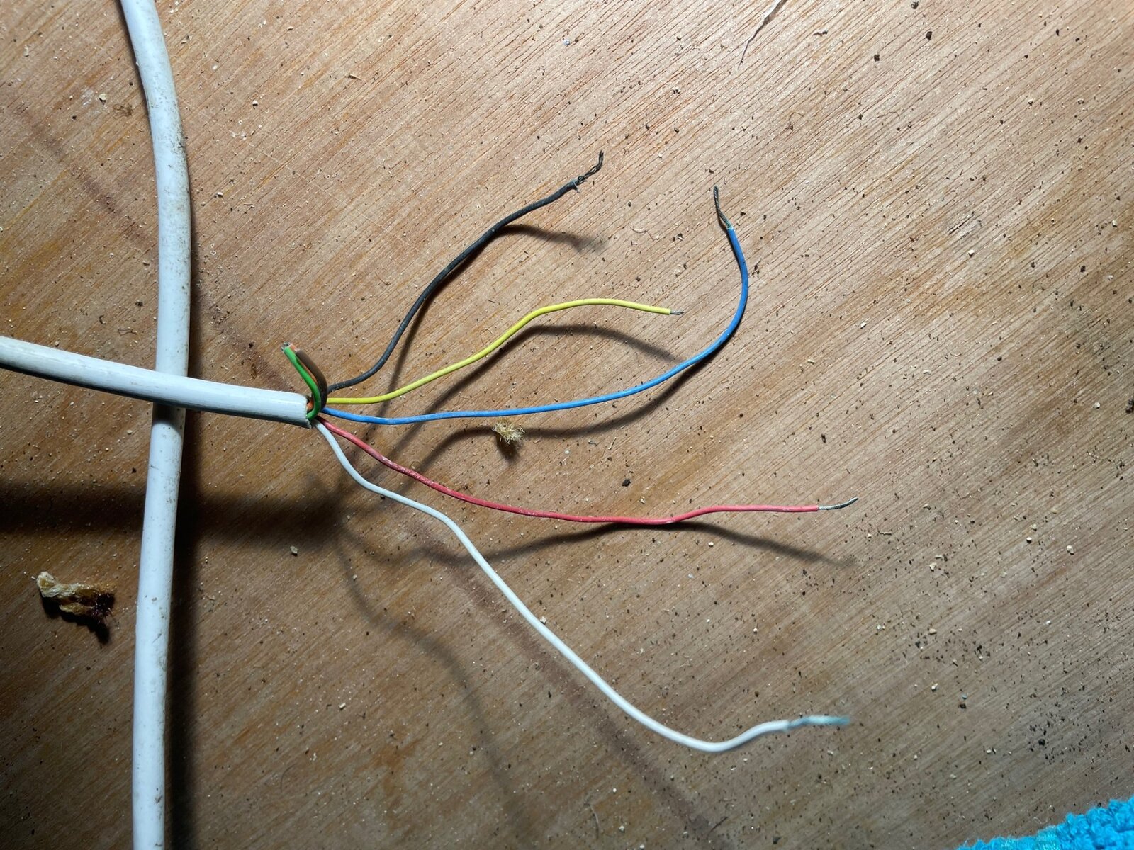

Pic 4 - cable to connect into the bell box still in situ.
Can a kind soul please tell me which colour cables goes into which terminal in Pic 3 (Bell box). EG
Black =
Yellow =
Blue =
Red =
White =
Thank you

Delta bells don’t ring when you first connect them … only after closing micro switch , then opening it for first time , don’t forget to move the bottom battery link
Following on from this, I thought I may have solved my issues. Turns out there was 2 door contacts that have been removed and the wiring cut but not terminated and stuffed into the walls. The wires are too short to terminate. When arming the alarm the system sounds and presents a number "7". I assume this is reference to Zone 7. I can see there are a number of Z1, Z2 etc to Z7 on the main wiring unit (PIC 1). I disconnected z7 from the board and terminated into a block. I then proceeded to remove the wires from each Zone on the board to hopefully identify which PIR's were related to which zones, alas, each PIR stayed active. I now asssume I am removing the comms wiring from the board rather than the PIR power?
Does anyboday have any ideas how I proceed to recomission this system. I assume I have to remove the zone wiring on the board 1 by 1 then rearm each time to establish which zone wiring represnts the abondoned door contacts then terminate them at the board? Pic 1 in the first post in the main unit,
Put a link in zone 7 … set system , activate each device one at a time and write down the zone number
not sure what you mean by "Link"? I reconnected zone 7 on the board, and disconnected z6, tried arming, and had a cycle of messages. 66, C6, t, 6, 1. Cant seem to find a reference to that cycle of codes in the maunal. any ideas very welcomed.
Link=small piece of wire 'linking' the two terminals for zone 7.
Put all wires back in any zones you taken out, put a 'link' in zone 7 terminals-the problem zone, and report back.
