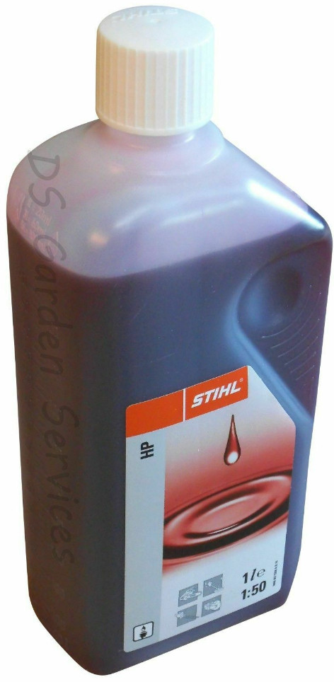

I have a nice selection of petrol tools now so purchased a larger mixing bottle & bigger bottle of two stroke oil.
Oil is Stihl & red in colour, same as before just bigger quantity purchased.

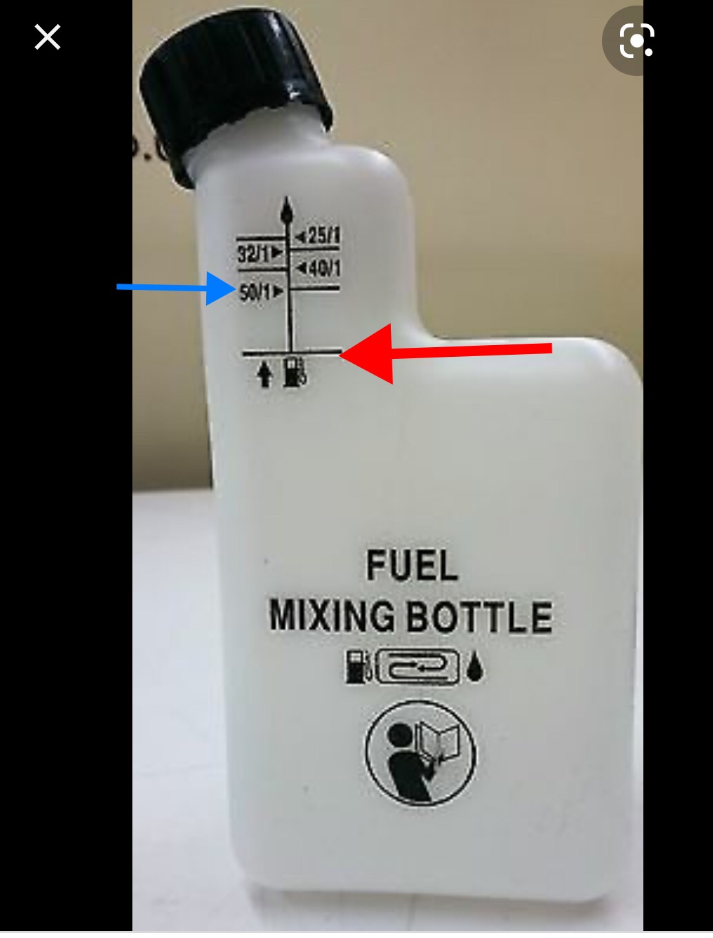

Bottle is shown in attached photo.
All my tools require 40:1 mix
All my tools were running fine.
So I filled the bottle up to the line shown in red with fuel.
I then filled the bottle from that line to the 40:1 line shown by blue arrow.
Today I used 3 different tools and when I Rev the engine ALL show white visable smoke.
I mixed it correctly didnt I ?

In your picture the blue line you have marked is actually on the 50:1 ratio
The 40:1 line is actually the lower one of the 2 on the left. So if you have topped it up to the lower line on the right you have actually made a 50:1 mix.
On your next mix fill it to the lower line on the left and see if it improves anything. If it makes it better then good. If it's worse then simply drain and re-mix to your original mark.
