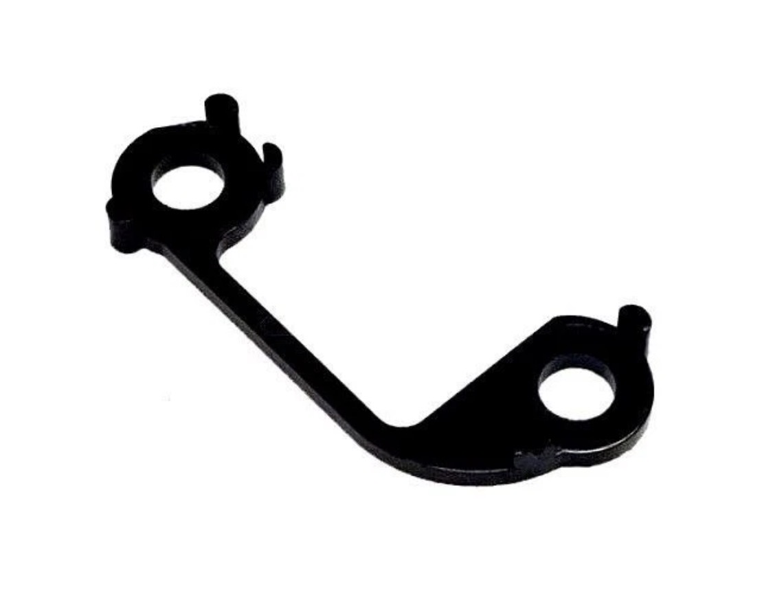

What is the purpose of this item.
It sits between engine block & coil.
Surely without it the coil will still operate as the bolts mount flush with the coils metal part so shorting out isnt an issue.
So assume for vibration etc ?
Just trying to look at every possibility now.
This is a heat insulating spacer, and won't stop the coil working.

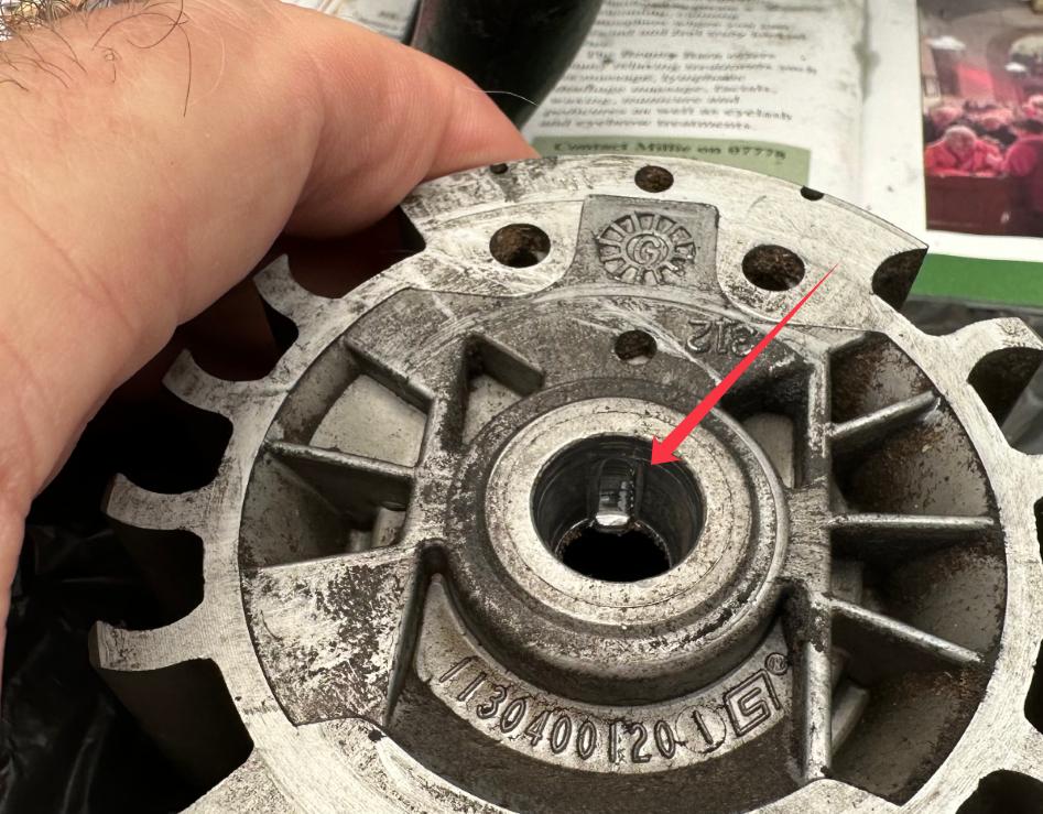

Hmmm
On ebay & Amazon market is flooded with chinese copies even well known garden suppliers are selling chinese copies.
Dont want another but what can i do as original is £££££££££
The photo i supplied was taken from internet to show there isnt a separate woodruft key & is part of the flywheel as shown.
I then took mine apart again & see photo of what i found.
So i would say as i am getting a spark it isnt at the correct time hence why im having these issues.
If key was 100% present the spark can only be made at around TDC and mine isnt so i dont think it is sparking on the correct stoke / time.
Majority of mine is missing & i found it stuck in crank.
What do you think now ?
My luck would be also something else ha ha
It looks like the flywheel key has sheared (from here, anyway) so a new flywheel is required.
Is the crankshaft key slot damaged at all?
John :)
Crank is fine so i assume spark doesnt fire at correct time, another flywheel has now been ordered
Just a word of wisdom when fitting the new flywheel........grip the flywheel as you tighten the nut - avoid the temptation to hold the other end of the crankshaft as it will twist.
John :)
