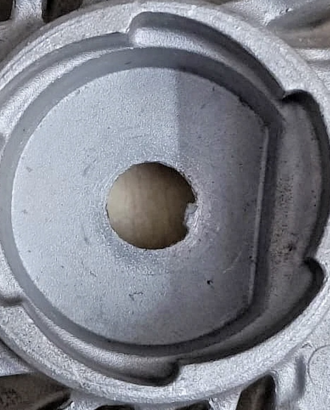

Question regarding key on crankshaft.
I’ve just looked at old engine that I removed. The crank has a key way and nothing else.
On car & bike engine there wood be a woodruff key that you tap into the key way on the crank.
Is this the same situation for this saw or does the magneto have a protrusion that aligns it thus not needing a woodruff key ?
So just look for some photos and see that the key way is part machined in the magneto / flywheel.
