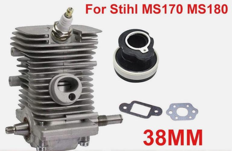

So ive decided to just fit a new complete engine unit, see photo attached.
Swaped it all over no problem.

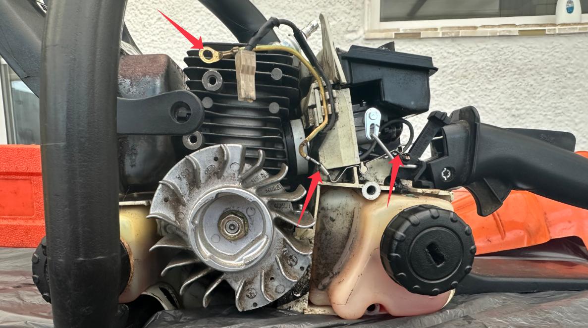

Not sure what colour it is according to manual it says STOP . If the lead runs from the coil to the engine body via the switch and nowhere else then yes that is what I would disconnect.
Page 40 onwards.
It is the wire mentioned above.
The yellow wire is mounted to the top of the coil & travels down to a connection.
The black wire goes to the coil itself & also travels down by this connection.
The connection between the two are made by a spring like piece of metal that it attached to the chock lever.
When i tested it yesterday i was hoping by pulling the wire off the coil itself would allow the saw to start thus bypassing this wire altogether should it be shorted to earth along its travels but that was not the case, hence why i ordered the coil.
Ive just done a continuity test between the top mounted wire & the wire directly to the coil then operated the choke lever & my metre reacts each time so i know that side of things are working.

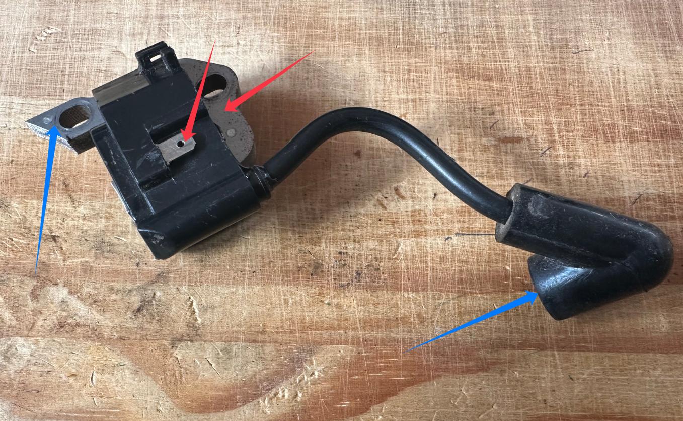

Anybody know about checking the coil ?
Meter set to 200 ohms
Connection from coil metal body to kill switch spade terminal
My reading is 02.2
Primary Winding
THEN
Meter set to 20K
Connection from coil metal body to plug lead inside cap
My reading is 10.16
Secondary Winding
Like shown in photo

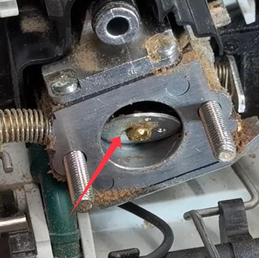

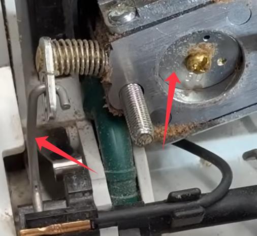

Whilst im waiting i noticed when the choke is set to be on the flap isnt shutting 100% so ive bent the metal rod a touch so now it does.

Why do you say not ignition ?
Obviously I don't know what is the matter with your machine.
However, coil failures are very rare - at least with genuine ones, don't use a pattern part here - and the spark is very small, hence looking for it in the dark.
The cut out mechanism isn't good, so disconnect any other coil wires for now.
I've found with faulty coils there is no resistance reading anywhere, but the resistances vary tremendously.
