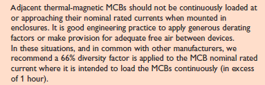

And the NEC says that breakers should not be loaded to more than 80% of their rating.
... and Wylex say ...

If there is a 'requirement', or even just a recommendation, that something should never be loaded to more than 80% "of it's rating", doesn't that mean that "the rating" really should be reduced by 20% ?
What is the point in having, say, a switch "rated at 100A" which comes with a recommendation/requirement that it should not be used to switch more than 80A?
It would also mean that the same 'restriction' would, in consequence, apply to cables (if overload possible).

Indeed - nd I think that probabl;y gives insight into why "do not load beyond 20% of rating" is silly. As we've often discussed, it's pretty apparent that the CCC 'ratings' of cables we work with have substantial built-in 'safety margins' already.
With cables, for example, we know that they are deemed to be able to carry 1.45 times their "rated" CCC for an hour without coming to harm, and I strongly suspect that the 'built-in margin' is even greater than that ... and hence, I suspect, similarly for most electrical items/devices (at least, those deriving from half-reputable manufacturers!).
Sloppy work there.
Me, I mean.
Pretty sure (but didn't check and didn't clarify) the NEC requirement isn't "never", it applies to "constant" loads. Which I assume must mean "for more than X minutes/hours/whatever".
My point was that different countries have different rules, and what they want in the USA is as relevant to the UK as what they want in the ROI.
Sloppy work there. .... Me, I mean. .... Pretty sure (but didn't check and didn't clarify) the NEC requirement isn't "never", it applies to "constant" loads. Which I assume must mean "for more than X minutes/hours/whatever".
Fair enough. In that case it would be similar to what Wylex say about 'adjacent' MCBs in what I quoted in post #61 - namely that (if I understand them correctly) that adjacent MCBs should be not loaded to more than 66% of their 'rating' (In) for periods in excess of 1 hour.
