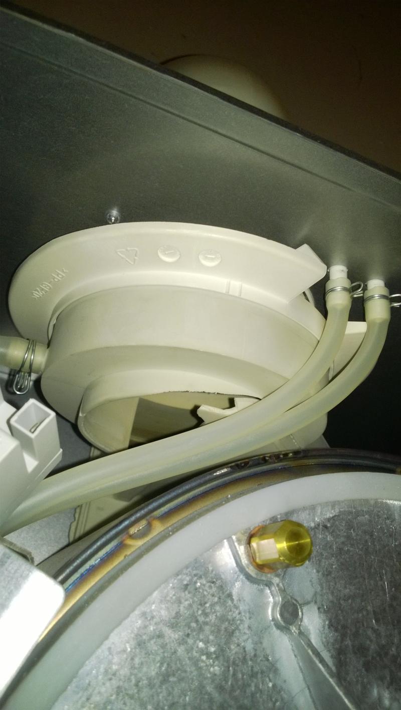

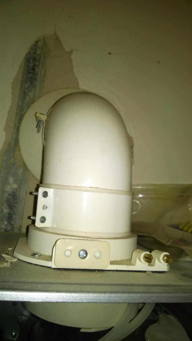

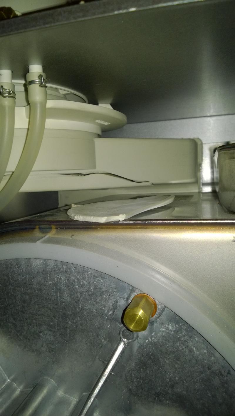

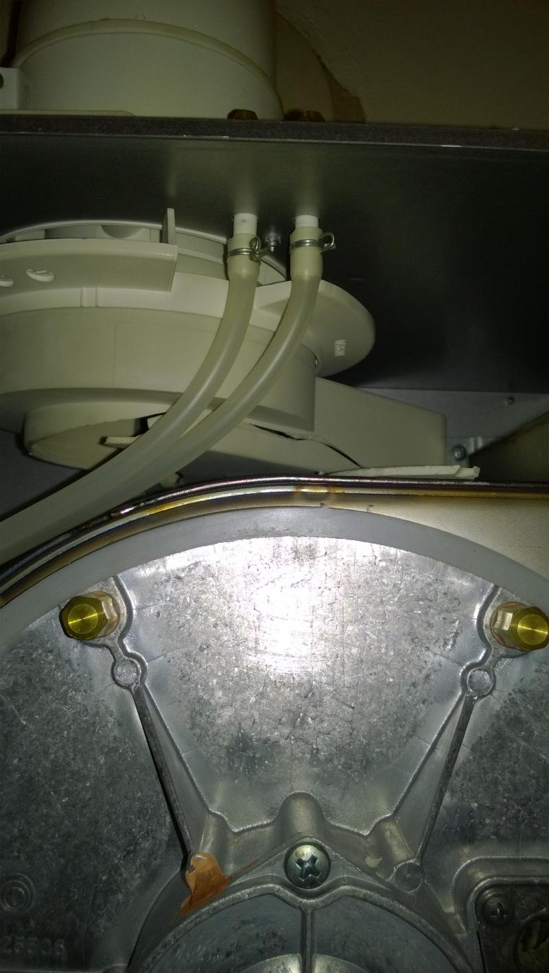

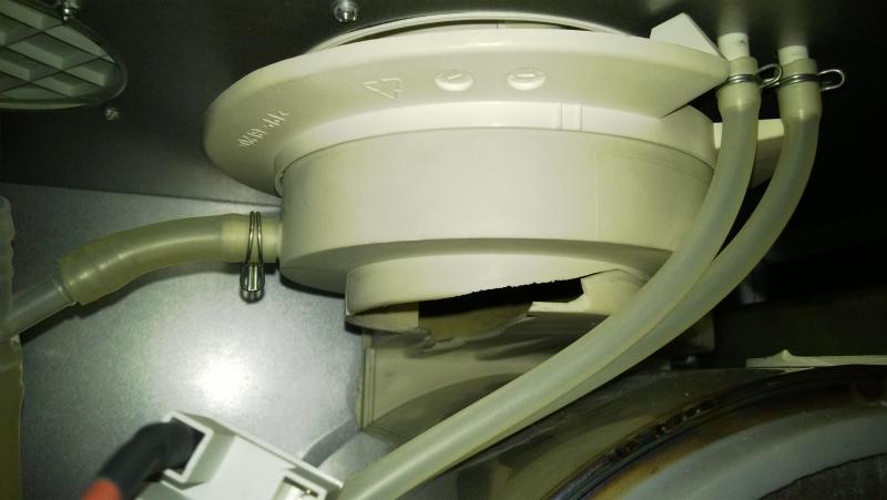

We finally managed to catch our Boiler Engineer nephew between jobs The missus frogmarched him upstairs by his left ear while verbally assaulting his right about him not returning her calls ... no heating...etc. She hates being cold does my missus . Poor bloke. Unfortunately, I wasn't here to rescue him.
Anyway, as soon as he removed the front cover, the problem was quite evident . The flue hood inside the boiler housing had literally been blown apart. ( SEE PICS ). Fortunately, nobody was at home when it happened else I am sure we would have heard something. The heating is timed to come on half an hour before her Ladyship gets in from work - but I bet it made the dog jump!!
He offered a few suggestions as to probable cause but was unable / unwilling to investigate further due to the damage so....over to you. Any ideas ?
My next question is..do I need to replace the whole boiler or do I source a replacement part ( if possible ) ?. That said, the flue replacement is not going to cure the root cause which is so far unidentified and may well lead to further replacement parts until we have a working boiler. £££££'s.
When things go wrong......!!!!

i would get someone to replace that part. That is almost certainly the fault.
Your nephew if he knew much about boilers should be able to confirm this
Even after fitting said part id check a few other things. E.g explosive ignition and its cause. Door seal etc.
My Nephew retrained as a plumber following demob from the Army. He began his new career as a plumbers mate and went back to school. He progressed through Corgi / Gas Safe and now runs his own very successful Company specialising in industrial gas / cryogenic installations. He installed my central heating during the ' wet ' stage of his career but has progressed far beyond fixing leaking taps and dodgy boilers - but he's still got it all in his bag. Who better to ask ?
The damage to the flue is not the problem...it is the result. The part will obviously need replacing before progression to solving the initial problem ( faulty gas valve / flow - blocked flue etc ). As I said in my previous post, he was unwilling and unable to go any further until the flue problem is cured. Makes sense to me.
