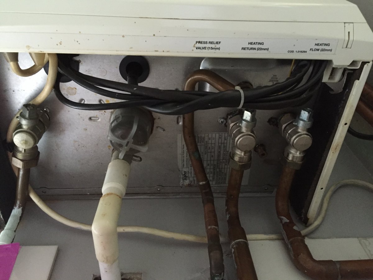

Hi all, my wife and I just moved into a house with an alpha cds20s boiler. Pressure is low so I want to top it up. As I understand I need the use of a filling loop which should be connected, however I cannot work out where it is. I believe I don't have one but any advice is most appreciated! I've attached a pic of what I'm looking at.
Many thanks!
Your boiler is a system boiler, have a look in airing cupboard, where the cylinder is, there may be one there.
Daniel.
Many thanks Daniel, it was in there and we now have heat! Thanks again for taking the time to reply!!
