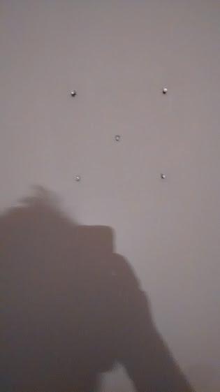

Just purchased a house. Previous owners has places Solid wall anchors to hold TV barcket,. Im not able to remove the anchors from the wall. So want to cut them off. Also assume i will need to grind the anchors after the cut to get them below wall level, so i can fill over them.

See pic attached.

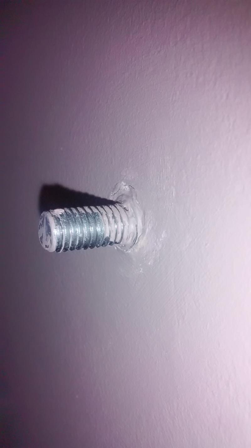

Pictures a bit rubbish but have you tried putting mole grips on them and turning them anti clockwise to remove?

They potrude out of the wall about 10mm to 20mm
Post a close up in focus picture of one of the studs. Unless they're chem fix studs there will be a way to remove them.

The Dremel Tool is a Rotating Multi Tool. Used for for delicate hobbyist tasks as well as ligtt diy, the Dremel 3000 Vut through the bolts very well. I use the speed click cutting discs, they wer every affective. The grindstone bits to grind down the final bits below the surface.
Took about 40mins to cut all 5 and grind them down. Maybe a bit longer than an angle grinder, but worked very well.
Sealed Bolts with Nail varnish to protect against rust.

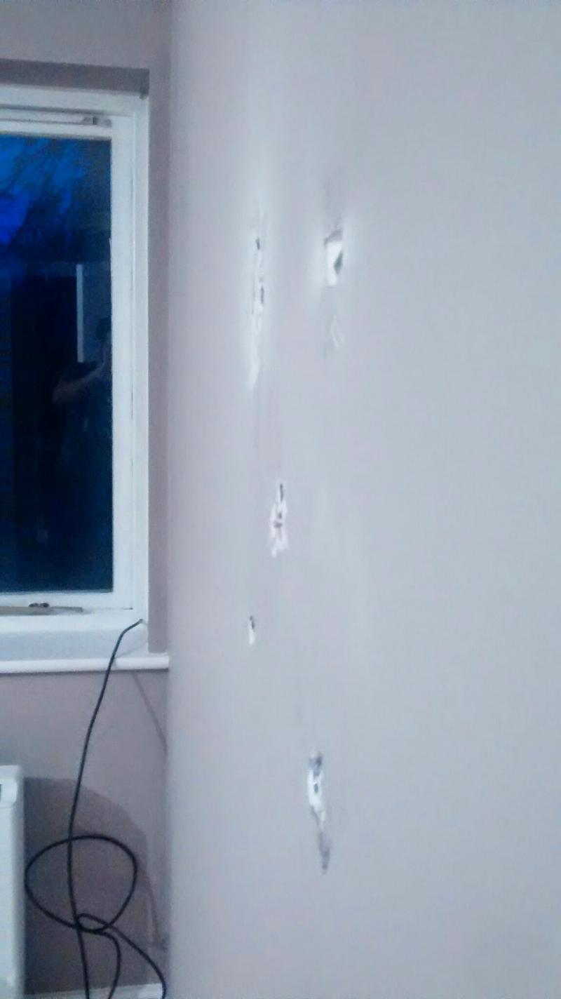

Pic before filling and sanding
