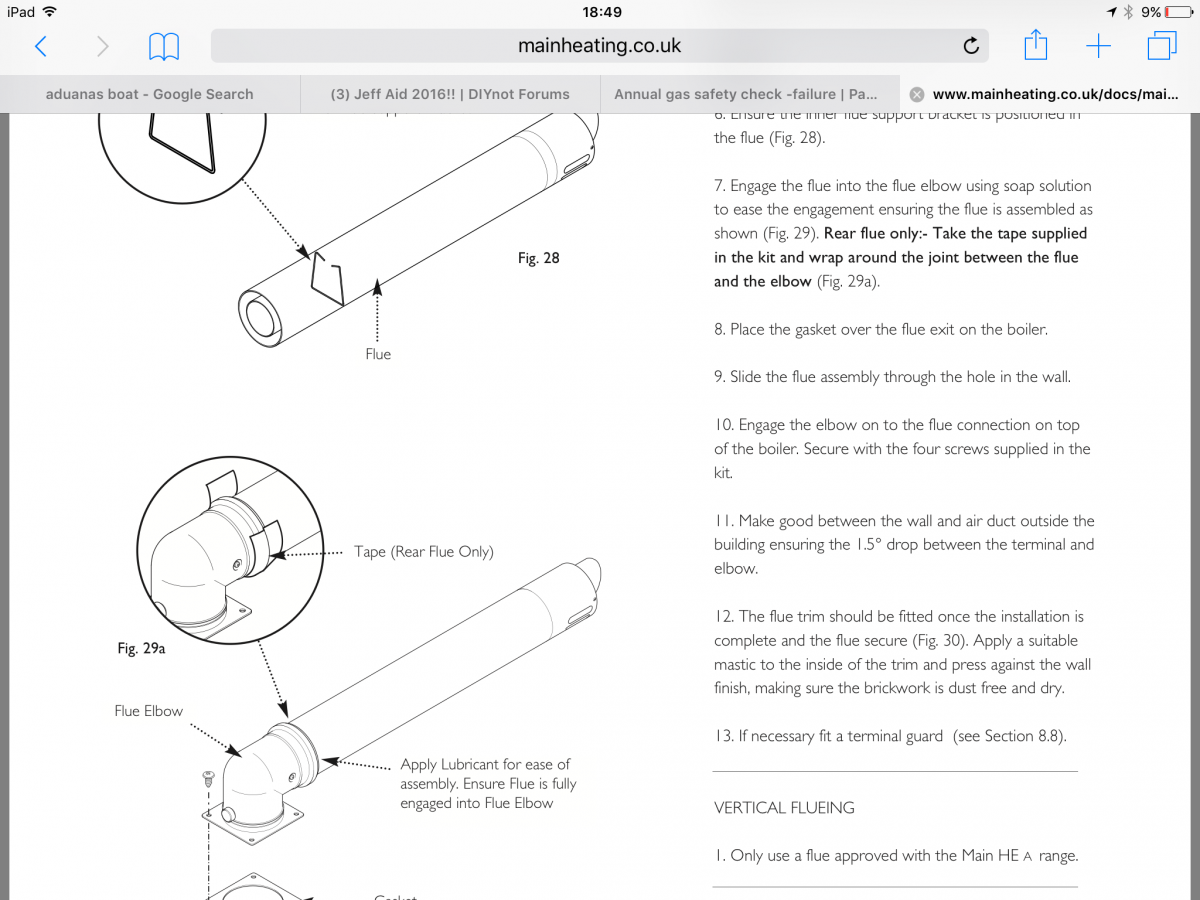

Op: the only person or person(s) who can explain why the duct tape issue was "missed" previously, are the attending engineer(s) who attended and certified the installation on those dates... Had it resulted in an 'incident', then that person would have been liable if proved an at risk situation was missed! Only gas safe can determine if it should have been picked up previously, but then again, there is no irrefutable evidence that it was there before the latest gse attended and inspected the install - your word is not enough in the eyes of the law!
Accept your new boiler and be thankful that the latest engineer was thorough and diligent.
Am I missing something in that pic and the subsequent one all I can see is a perfectly good flue passing through a sleeve that has been installed presumably because the flue passes through a bricked up window and they have used a sleeve as the flue passes through the cavity, havent a clue why the tape is there but dont see any signs of any products escaping, the actuall boiler flue is intact
I have to say I expect that is the case as well.
The duct tape being used to seal the inside of the sleeve through the wall.
Not totally correct but it does the job.

If that boiler is a worcester Greenstar then that flue isn't a Worcester flue terminal. Looks to me like two differnt flues have been lashed together unless I'm mistaken.
I dont think they have Pablo to me looks like a flue inside a sleeve but wont say anything against the attending engineer as he has seen more than any of us, havent a clue why the grey tape is there
who the fook would mix flues when working for HA , but does look different but not 100% sure thou
The Baxi Potterton Main flue used to come with some duct tape to seal the fittings. Looked absolutely shyte when fitted. Looked amateurish! If you didn't know you would assume the worst.
