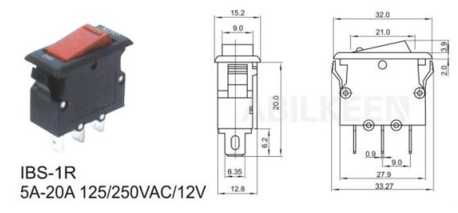

I want a panel something like 100mm x 200mm x 2-3mm, probably black ABS, with rectangular apertures in it to take push-in panel switches like these:
So far, so feasible.

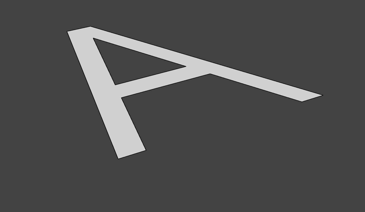

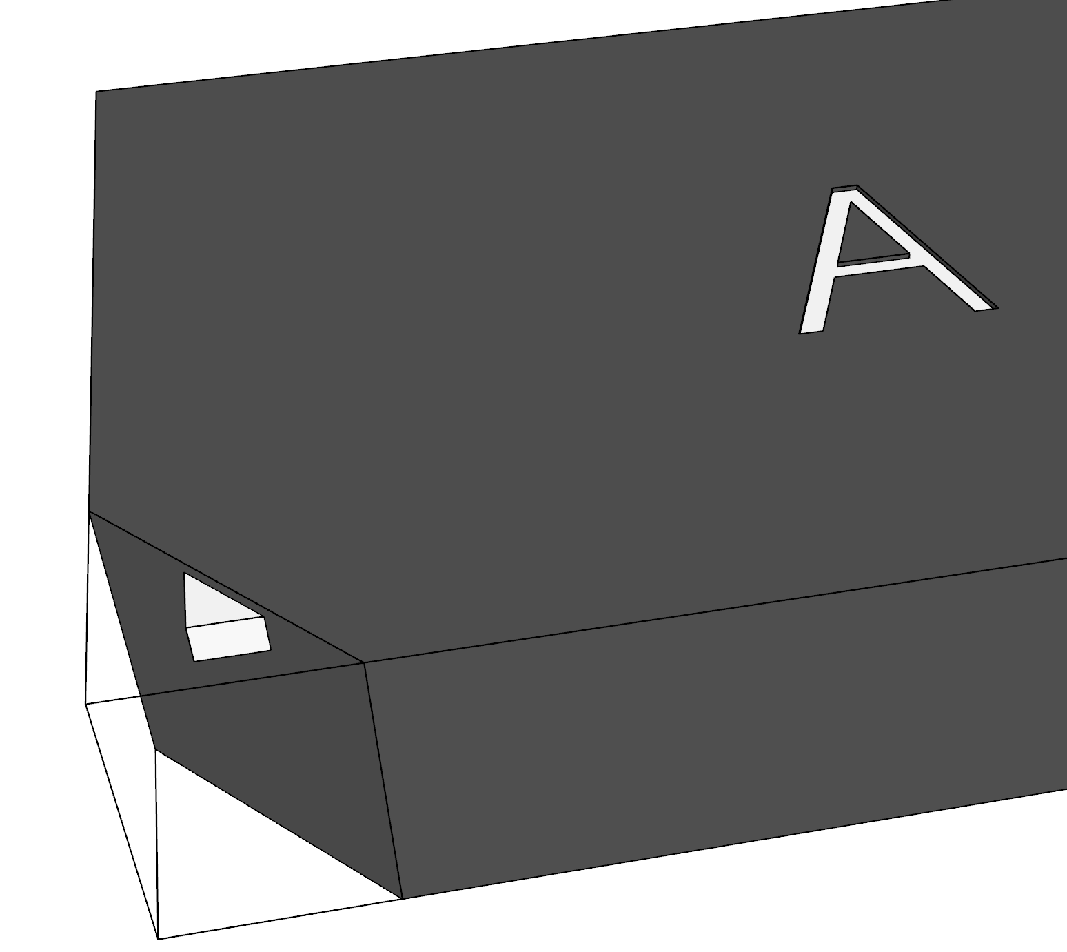

But I want legends above each switch, so I was thinking an embedded layer of a contrasting colour - drawing here with a cutaway corner to show what I mean:
And the top surface cut away (i.e. not printed) to make letters:

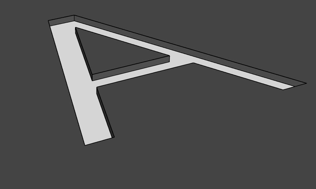

Or ditto but with the contrasting layer printed with raised areas flush to the top surface:
Either idea OK?
Either idea utterly bonkers?
Easy enough with the right stl file. Contrasting colours or two colour printing is becoming popular. I don't because of the amount of waste generated with the colour change but commercial outfits would be easily capable. Raised or sunken letters is easy.
