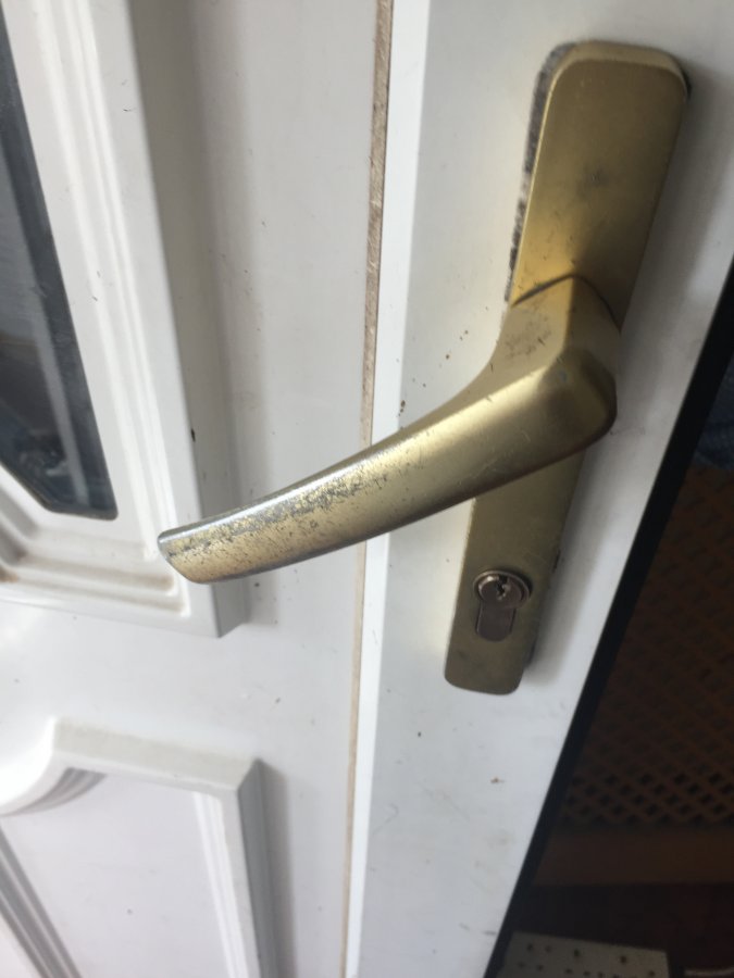

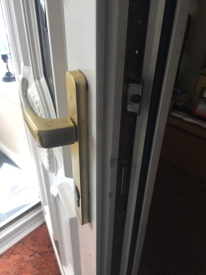

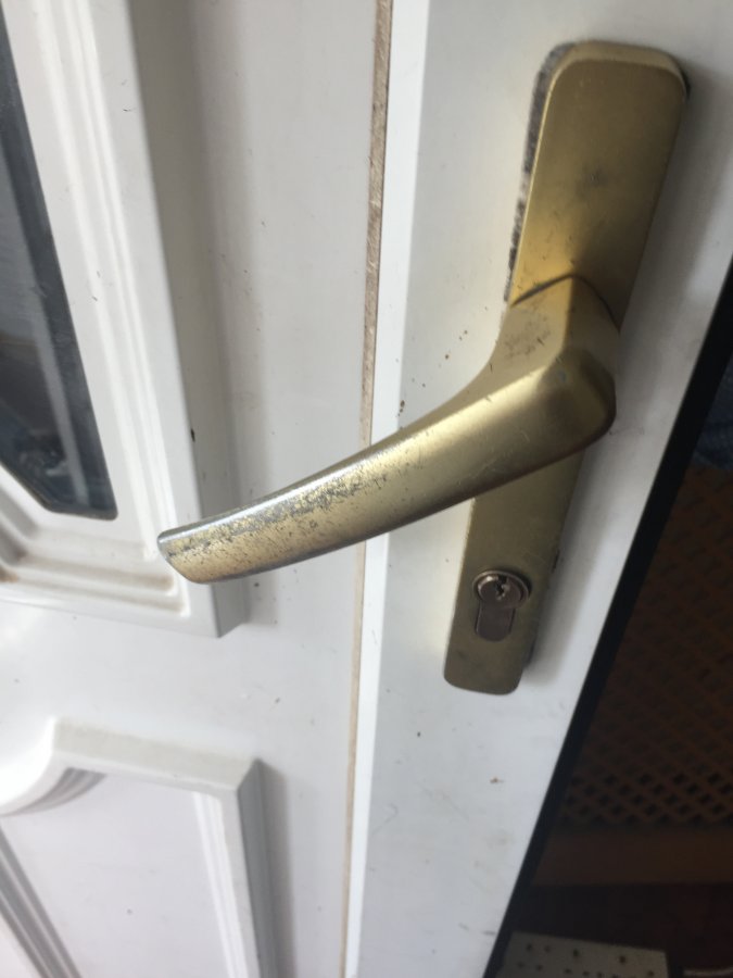

IMG_1056.JPG IMG_1053.JPG Hi
Have used search facility so appreciate previous posts on this subject. Photos attached to illustrate. Handles stay down, and in open position, without bouncing back. I've taken handles off and no visible springs, so guess it's latch mechanism. If so, am not sure which/how many of the screws on the side plate of the door Is neee to remove to repair or replace said unit?
Door about 20 years old.
Many thanks.

Some have a spring mechanism in the handle, and others have nothing, simply relying on the fact that you push the handle into different positions depending on what you want to do. Sounds like you have the latter.
Thanks. No spring in handle, but must be spring mechanism elsewhere as handle used to bounce up after use.
If not in the handle it will be inside the gearbox (maybe need a whole locking mech) Assuming you can find the right one.
Would be cheaper to buy and fit sprung handles.

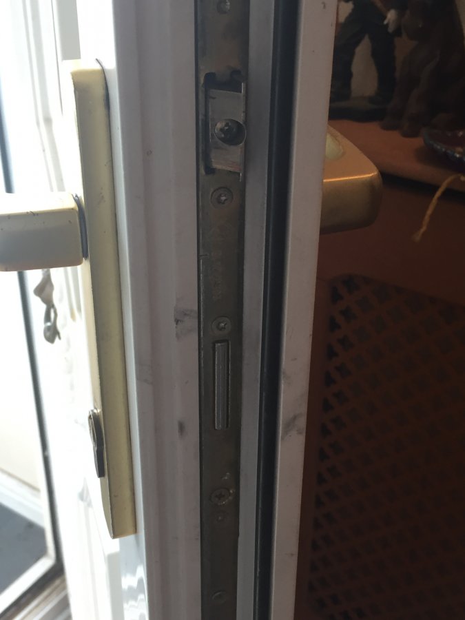

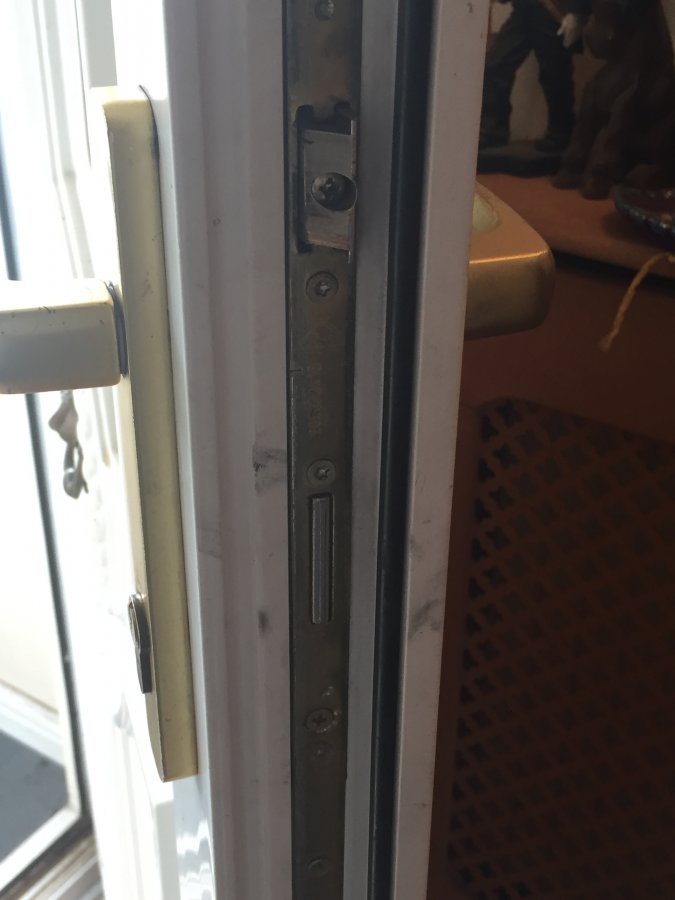

Thanks again. I was clumsy in referring to "locking mechanisms" above. I don't need or want to replace the whole thing as door locks securely. I simply meant the latch section (secured by screw) which operates via the handle.
Can I remove that and inspect for damaged spring etc? (I note you said above that spring might be in locking mechanism or gearbox anyway)
I guess easier to order handle with spring, so assume spec says that before you order.
Sorry to be dumb but terminology a tad confusing.
Ah got you, Thats sort of a separate issue possibly.
Yes you can undo the spring on the latch to have a look. Some will only come out so far to allow it to rotate for opposite handles doors. Some do come right out (I think yours will by the looks of it). Then if you can find one the right size you could just replace the spring

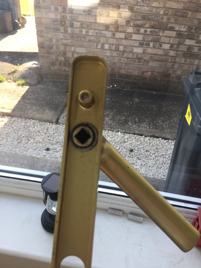

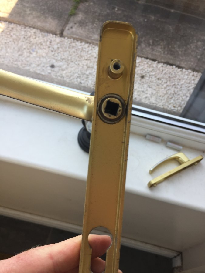

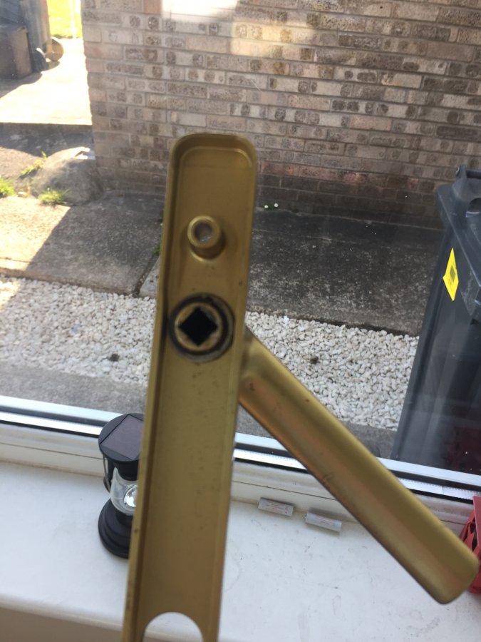

IMG_1058.JPG IMG_1057.JPG Hi again
New picture showing back of handles. It may be that there was once something there but not a trace left.
No definitely not in your case; but let's do a double check, how long hasn't the handle not been centring itself. What's changed.
Do you have a Toolstation nearby. They do handles (which may or may not match your size, and these have the self centring springs in the pack, but you don't need to use them if you don't want them.
