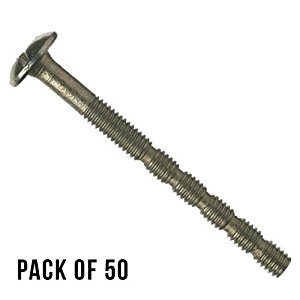

Glad you got it sorted in the end, going back to your comment that the screws should be the right size, well handle manufacturers don't know which system the handle will eventually be fitted to so either supply long and short screws or some even supply these.....
......you just snap off what you don't need, these screws will cover every eventuality but hey you've got yours sorted so all's good
