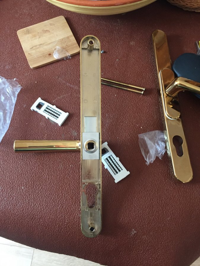

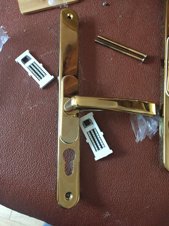

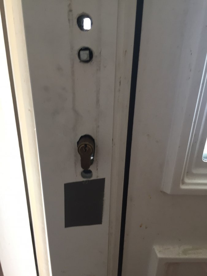

Hi
Just bought Universal Handle from Handlestore. I've repositioned new handle over Euro lock and one of the new fixing holes required is precariously close to existing one (photo). The other problem is diameter of hole as needs to take screw and fixing lug for first inch.
I'm just a bit worried about creating a massive hole with lug then wobbling around in door frame etc.
Any advice would be much appreciated.

An oversized (elongated) hole won't be an issue, but the spindle and euro lock positions doesn't look to be lining up. But that could be a perspective issue.
Hi again
When you say "oversized elongated" do you mean the two holes that overlap are sitting underneath each other, rather than horizontally next to each other??
If so, wouldn't that still create movement, even when screws tightened? (Would also be same on other side)
Spindle and Euro lock alignment is fine.
Cheers
