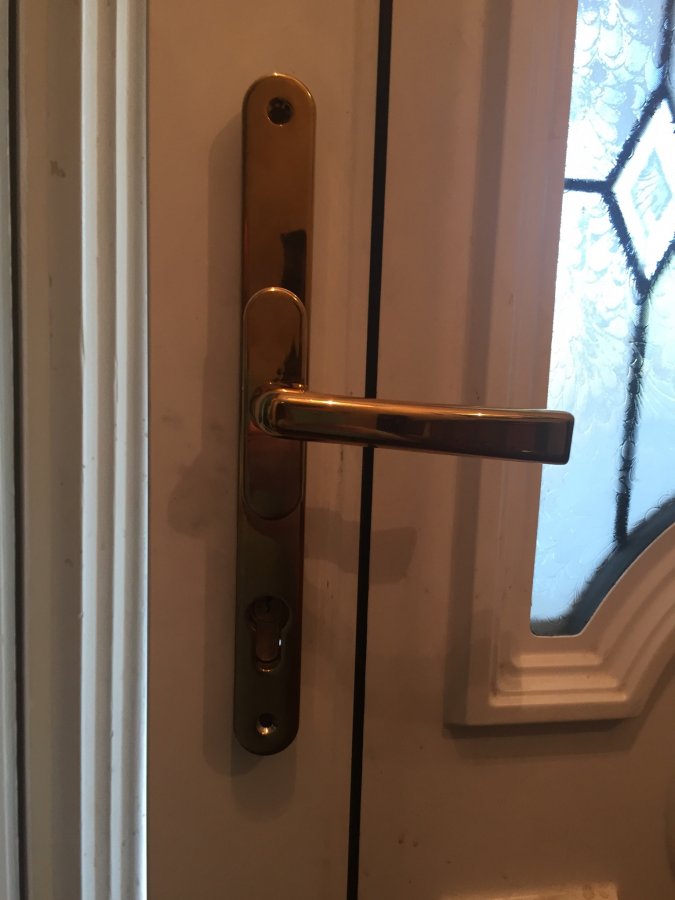

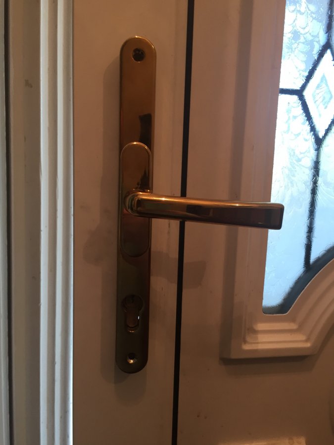

Have taken these photos. Hope they explain predicament. Handlestore completely useless.
I can see why you're concerned, but as long as you're carful, and don't make it too wide, I think you'll be fine. Worst case scenario, you'll end up filling the upper hole with 2 part body filler to reinforce it.
Ok thanks. So I should be able to use 10mm bit as advised by Handlestore?

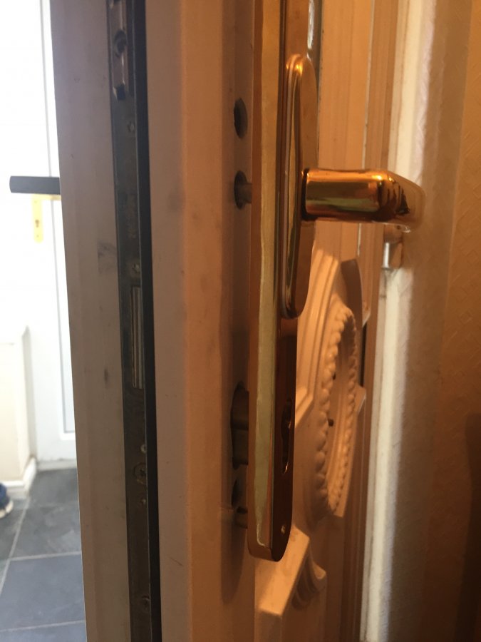

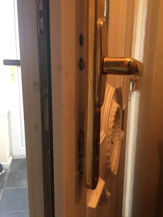

Update. Above are more photos of my disastrous Universal Handle, post fitting.

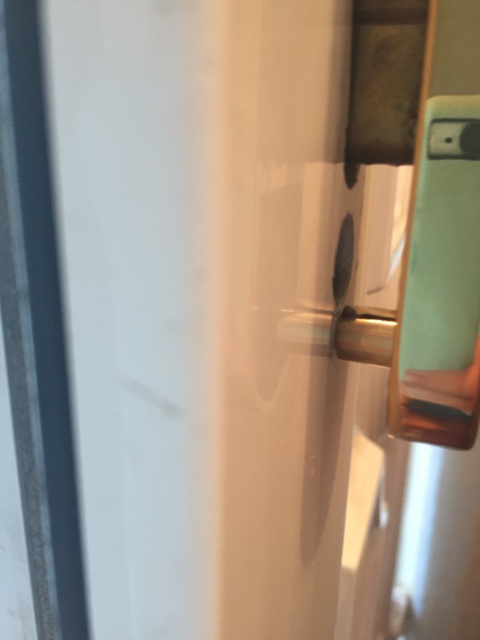

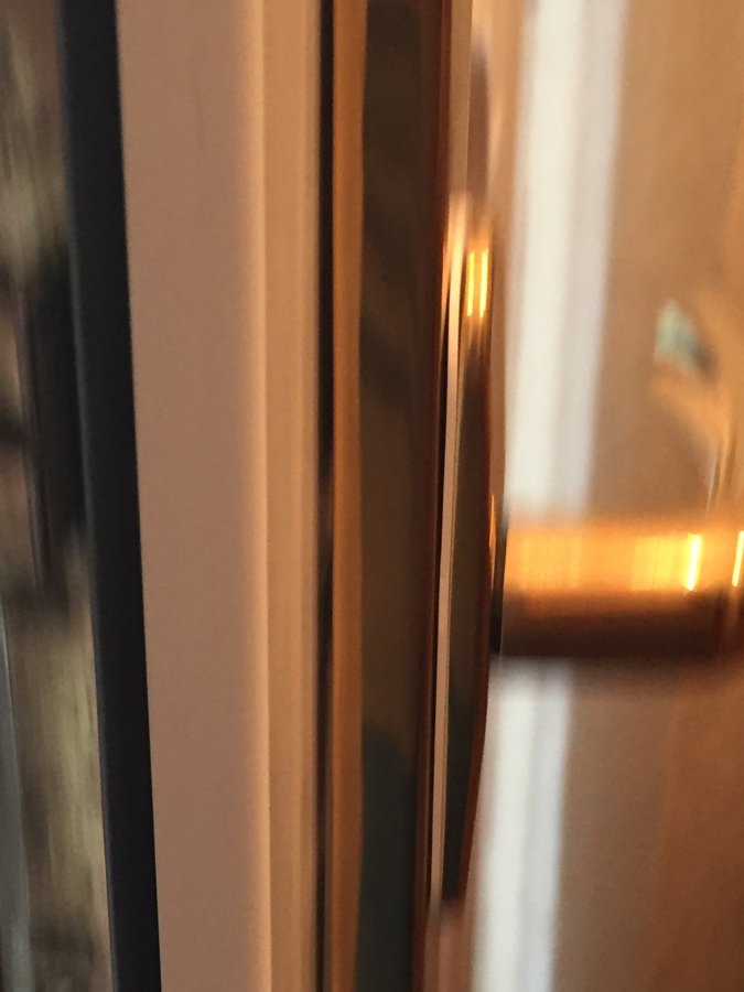

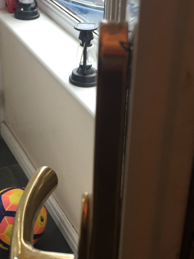

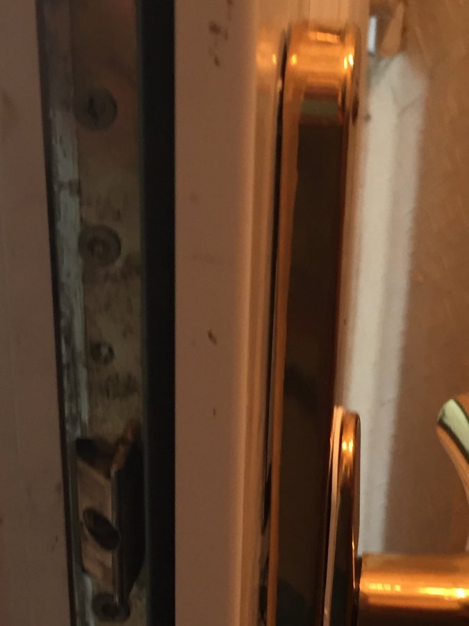

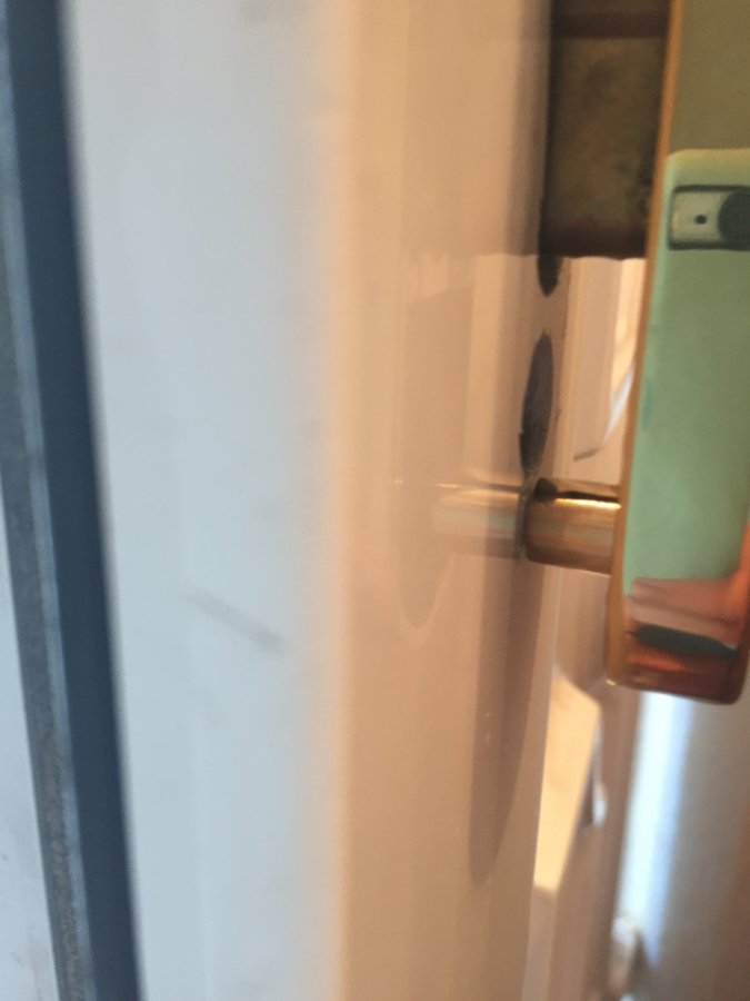

As expected, I ended up with bigger screw holes due to proximity to existing screw positions. I now find that, no matter how tight screw is, the lugs on each side pop out so not flush finish.
Grateful for any advice.
The lugs are probably touching the second layer of pvc, either enlarge that hole also or file or hacksaw a bit off each lug, check also that the screws aren't too long and are reaching the end of the threads on the outer handle, some handle packs have 2 sets of screws - long and short
Thank you for that. Will check the second layer of upvc inside hole and enlarge that if necessary. Re hacksawing end of lugs- will try. Re screws- only one size provided so shouldn't be too long??
If you've drilled through the door, then you'll have gone right through. If the screws are too long, the handles will be loose. If the handles are tight together, then it's the lugs that need filing down.
Thanks again. Do you recommend filing down both lugs on each side? (I.e even the ones with the thread)
If both handles are being held off the pvc then yes, I suspect the lugs are touching the pvc
That'll be a judgement call on your part, but you should be able to get away with just filing down the lugs on one handle. But looking back at the earlier pictures, I think it'll be the screws being too long
