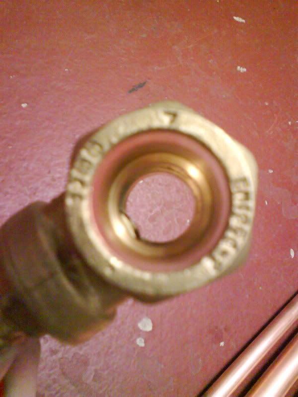

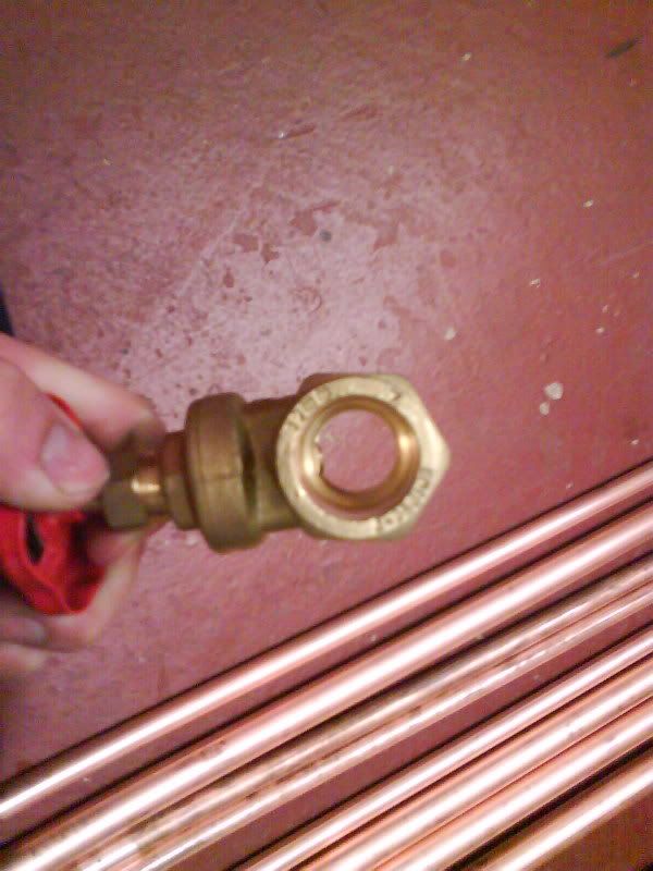

Most gate valves arn't full bore; the lever valve shown by Seco is!
The gate valves that I've got look full bore :shock: :?
Look down the end into the centre where the gate is located; if it's not the same diameter all the way through (as the pipe olive) it isn't full bore!
Close enough full bore. Alot better than standard iso valves, also the pump inlets are 15mm, so as long as they're close to the pump, shouldn't make a difference (I hope) ;)
Agreed, that’s better than most & it won’t matter if your pump inlets are reducing down to 15mm. The only true full bore valves I know of are the gas approved lever ball valves, as shown by seco. the central section is little more than the pipe thickness. Rather more expensive but you don’t have to pay the stupid prices your local plumb store will rob you of; they also look a damn site more attractive & are easier to operate than gate valves.
