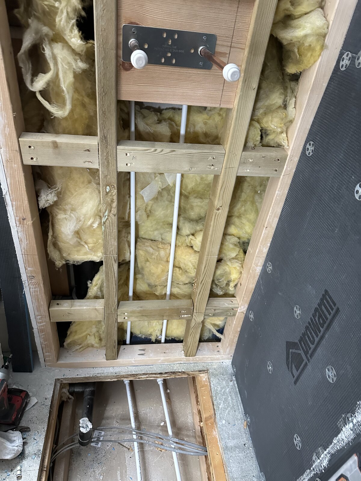

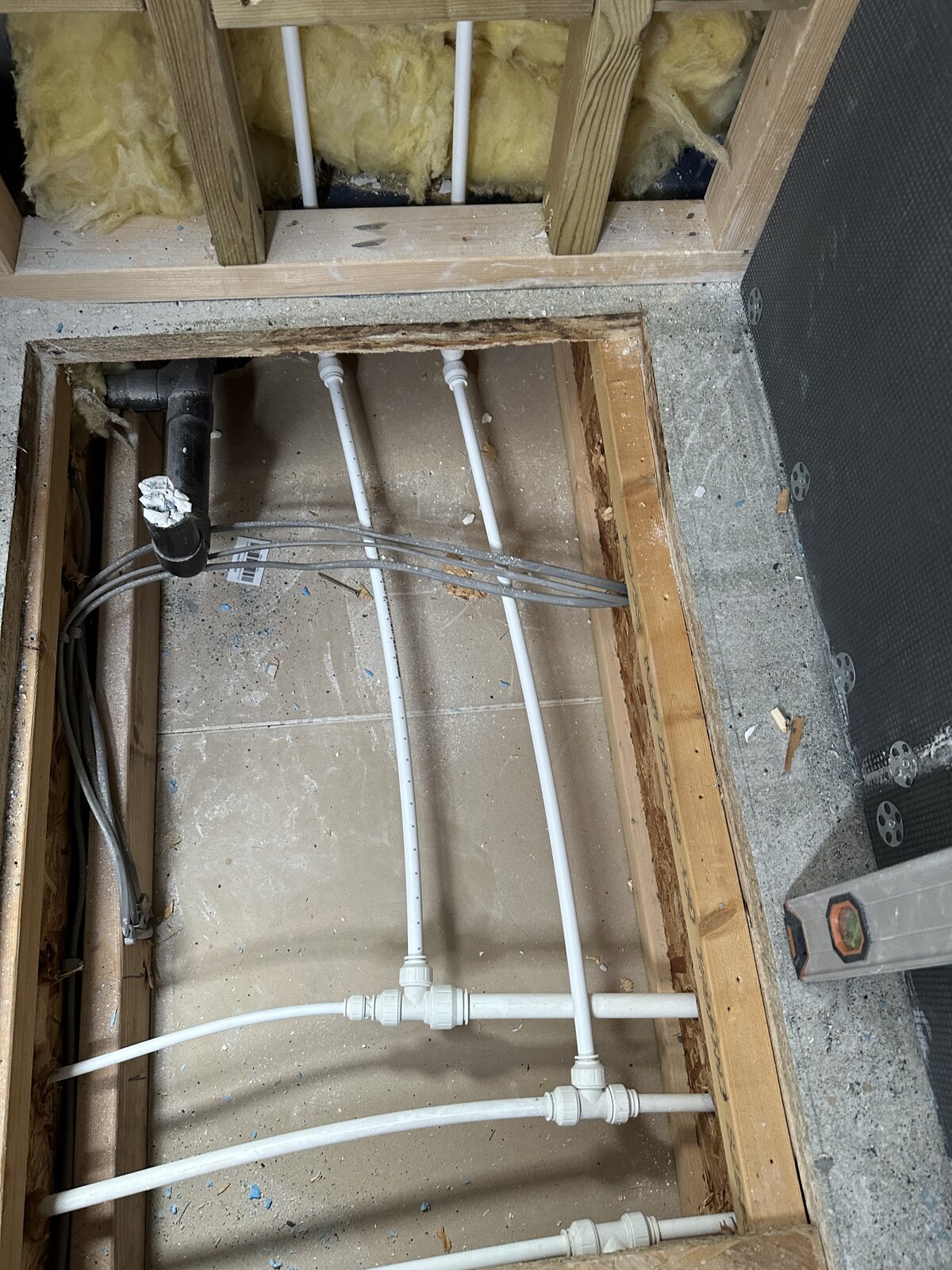

Can anyone notice any issues with this pipework? These are hot and cold water pipes leading to a shower plate. My only concern is that after turning the water off and removing the caps, no water came out at all. Normally, I would expect at least a few drops. Any thoughts?

Pipes need support and clips.
Also they should not touch where they cross.
Maybe pipes were full of trapped air
