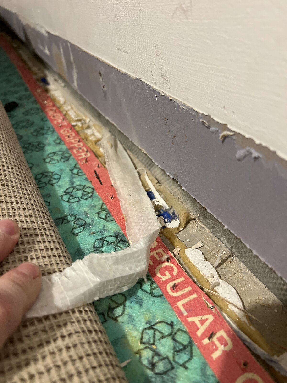

I’ve a new build bellway home. Now out of initial warranty.
One of the issues we had “fixed” was one of the partition walls literally moved and wasn’t fixed down. This apparently was rectified- yes the wall no longer moved.
Roll on to now and I’m removing the carpet in the room and find that what they actually did was just wedge some filler pieces under the metal stud base plate and put some glue around it.
This has been causing squeaks and all sorts which is what I was going to tackle before the new carpet comes but I’m angry- mainly as they lied. But after so long is there anything that can be done or it’s just my problem.

A few short angle brackets, let into the wall and floor will do. Fix them to the sole plate with self drilling screws. Use adhesive on the upright part of the bracket (metal-metal) also.

If you do decide to remedy it yourself, do it properly. Its just a std stud wall no? Find the substructure and screw it down properly or however it's supposed to be done.
Believe it or not that is recommended by the NHBC as a solution to squeaky wall/floor joints.
