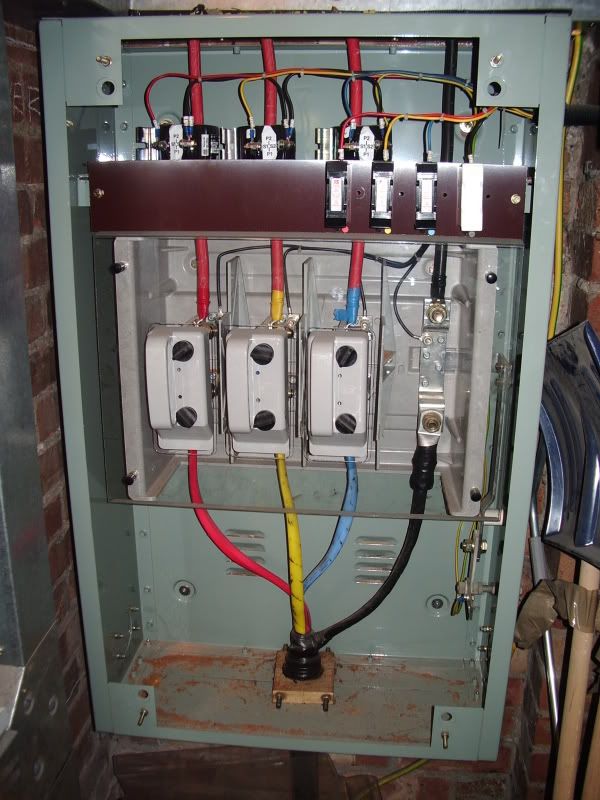

Would you be installing the CTs, or just fitting meters to the CTs?
Are the CTs not installed by the mains lads when they install the cutout?
They look like they come pre installed in the cutout.
RF that looks a full blown premises incomer. Yes C/Ts like that are normally pre-installed at the manufacturers. I used to work for a firm that made switchgear and made our own C/Ts.
