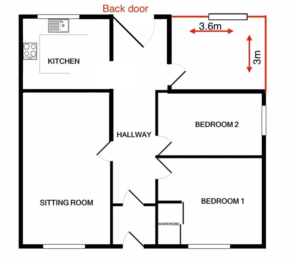

Hi, currently planning a small 3 x 3.6m extension to the back of my house, this squares off a previous extension. Very very simple build that will become a bathroom.
just been getting a few quotes for plans from architects and structural
Engineers.
Currently quotes are varying from £1500 + VAT for basic architect drawings - £1000 for structural engineer… plus all the other costs. It’s blowing my mind how much it costs before you even break ground! I was hoping to do the footings and a fair bit of the roof myself along with the floor and all the internals and bring it in between £1k-£1500 PSM.
I suppose my question is : how much of the drawings can I do myself?
Are there any work arounds when it comes to the architects fees? Cheaper ways to do it?
Structural engineer - should I just get lots of quotes on? I know there’s nothing I can do to diy that but the prices are wild.

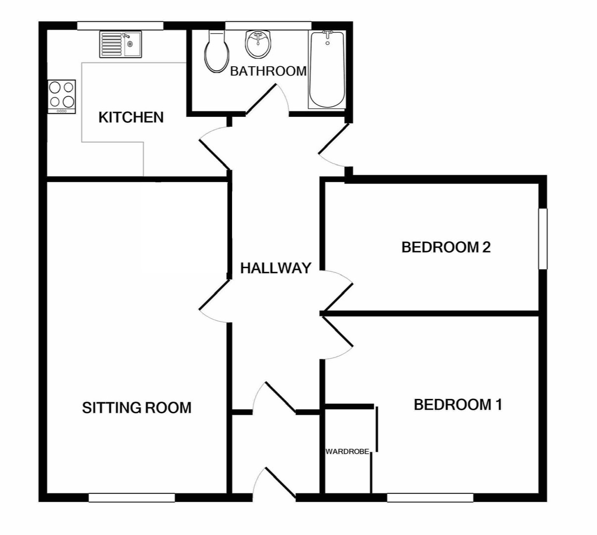

Have added the current floor plan and the proposed layout I want.
Any help / advice is much appreciated.
Angus - north east Scotland.

For a simple job like this you only need a decent technician for the drawings and any simple beams. A grand plus fees would be my charge.
Nothing to stop you doing your own drawings but you'll have to sort all the details out.

If it's PD just do it on a building notice.
There's plenty on here who've built far more complicated extensions with little previous knowledge or experience.
Familiarise yourself with the building regs and put your proposals on here - you'll undoubtedly receive more than enough detailed advice on every aspect.
If you're unsure ask before you do something rather than after. If you want to do parts and contract out other bits then people will tell you what they did themselves (and what they wish they hadn't!).
The only caveat I would offer is that you should remind people that you're in Scotland and check all advise complies with their regs.

I'm an engineer by training and quallification but been doing architectural work for 20+ years. Prettty much retired now.
I said simple beams: in reality any member carrying a load needs to be sized, be it joist, rafter, lintel or supporting beam, plus of course the foundations, though most can come from tables. You have got the basic drawing already: you just need a section and construction details.
Are you diying? There's a lot of money to be saved if you can do some yourself.
I have to disagree with cdbe's first line I fear (the rest I agree 100%): I wouldn't touch Building Notice (except for an experienced builder working for himself). It matters not if it's PD or PP, the reality is that if something is built wrong on notice it will have to be redone and there will be cost/delay. Certainly south of the border the fees charged by BC are usually higher for notice work and they freely admit that they don't like working that way as they have more to do and more potential conflict.
Get drawings done, stick them up on here for comment if you like, get them approved (you'll probably have to do a few tweaks) and you then have something specific to work to or for a builder to give you an accurate price.

Yes, you can draw your own plans.. You can work with your building control department to come up with a design that meets regulation in terms of how it's built and planning departments accept DIY plans for where it will be built and what it will look like
There will be a lot of research for you to do to find out how the building should be built to comply, and how it shall align with local policy if you need planning permission
Depending on how you value your time, those 1500 quid plans might save you 5 to 10 days of learning, arguing and being browbeaten into accepting something not quite what you wanted (because your heart gets more set on what you design when you've finished designing it, whereas if a pro tells you at the ideas stage something won't fly because of X, it's less of a shock)
as well as architects, there is a lower level of qualification (architectural technician) that would be more than capable of producing plans for your project, and possibly at a lower cost. Ask around and get some quotes; the architect is a GP, the AT is a pharmacist, and your extension is a cough..
