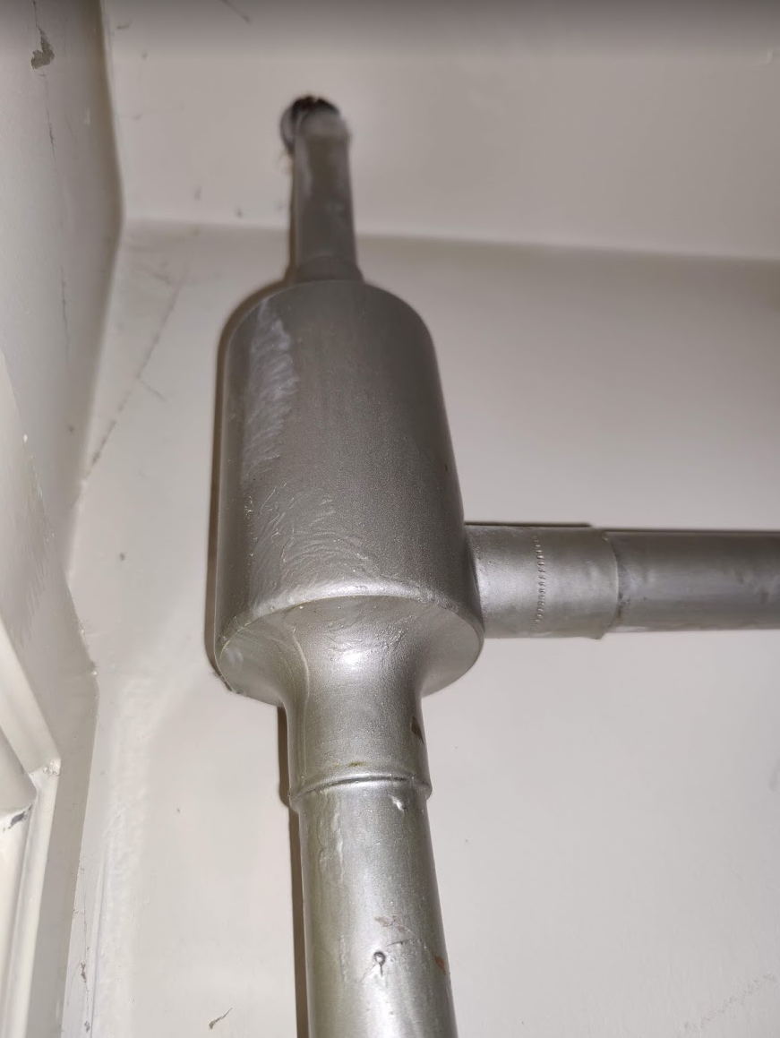

Couldnt really see the very top of the cupboard, is that an air seperator fitted up there ?
I believe so yes. It's where it seems to eventually dissipate.
So is it possible the root of my problems here could be that I have a common feed and expansion pipe? I've just been up in my loft as I'd wondered previously when bunging the system to change some radiator valves why there was no expansion pipe.
The water up there is still steaming hot inside the plastic tank. I'm obviously just a DIYer here but for me, having an air separator 'venting' into a pipe that is constantly filled with water is not a wise thing to do.
